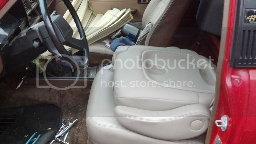

Still fits between the b-pillar and the center console fairly well.
If you look close, the seat is waving at you.
The seat is sitting in the truck w/o the base/sliders
Right now it is as far back as possible b/c of the folded rear tumble seat. Now I have an excuse to remove the rear seat.

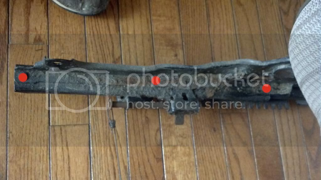

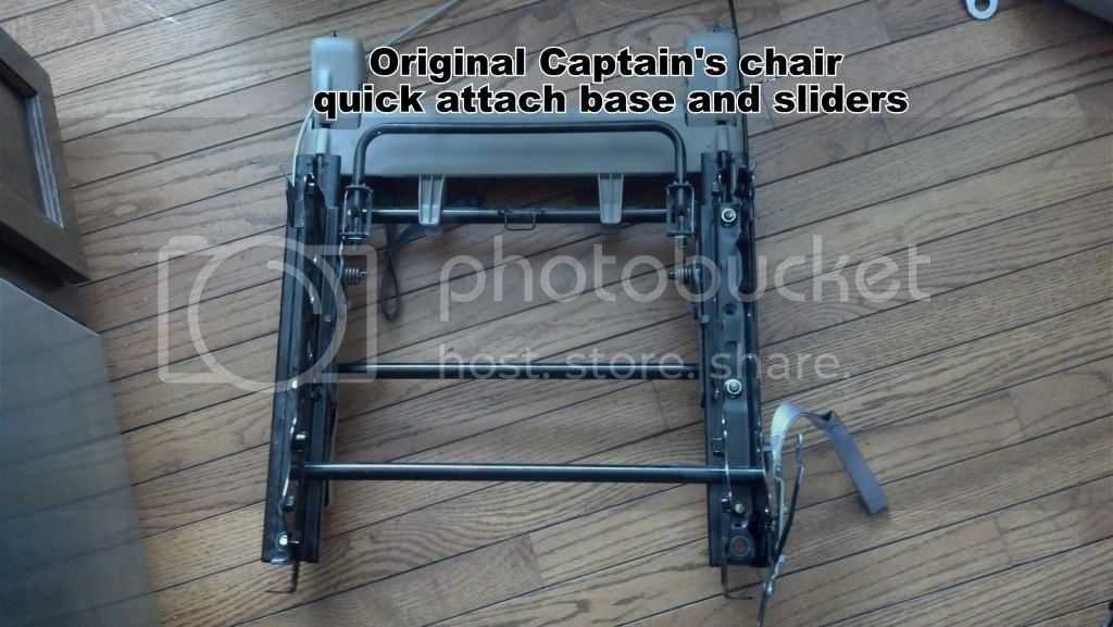

Now some pics of the stock mounts/sliders.
I'm thinking that the easiest thing will be to remove the lower 2/3rds of the stock base and then bolt them to some flat stock bolted to the new seat.
Things not seen.
The captains chair had some cables from the folding mechanism to the floor locks on the quick attach mounts. Those had to be cut/removed. In this case cut b/c they were attached to a riveted pin.

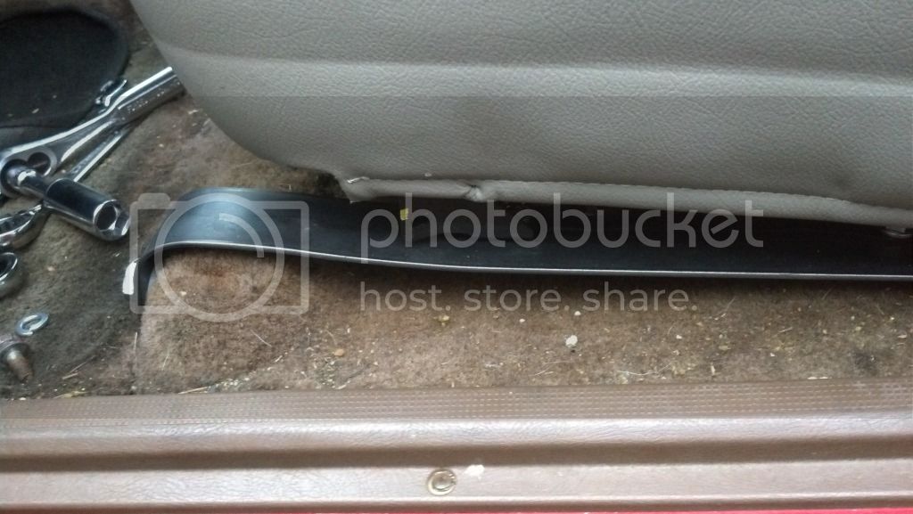

I picked up some 1/8" flat stock, maybe 2" wide.
Put the seat in the car and figured out the placement, which ended up about 6" back from the front floor holes and the front of the seat frame.
I used the torch to heat up the flat stock so I could more easily bend the ends where they'll need to curve at the front. The bend will need to be about 75-80degrees.
figure out the floor bolts and where the holes will need to be in the flat stock, then do the same for the bolt holes for the seat frame.
I used some 3/8" bolts, lock washers, and nuts to attack the seat to the flat stock.

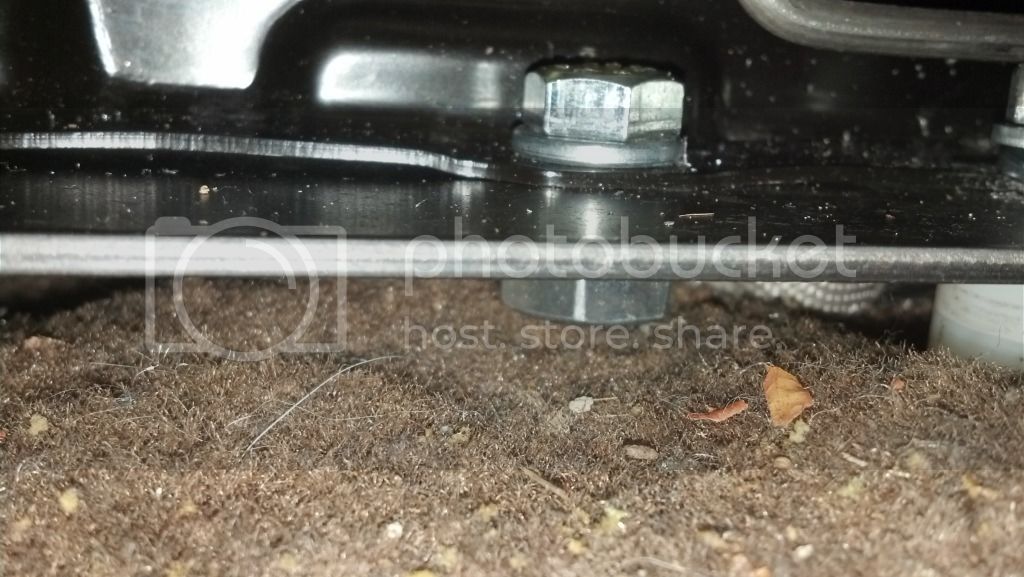

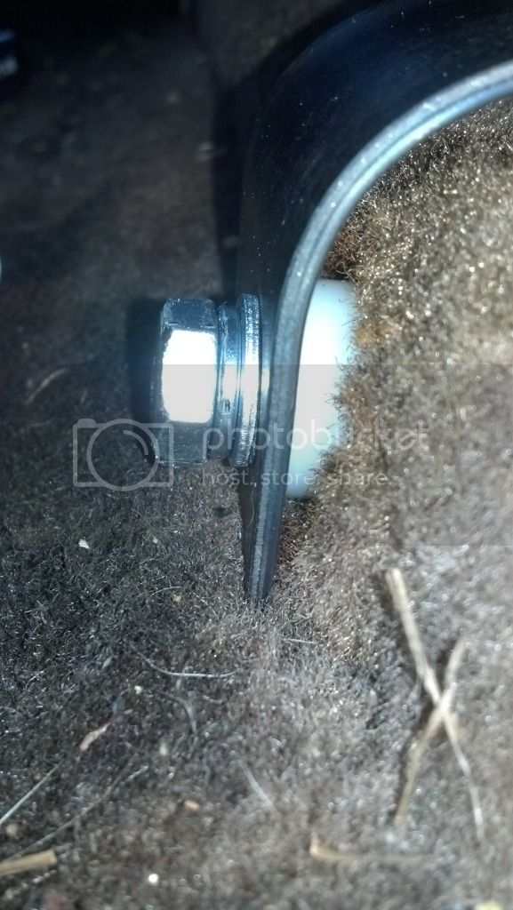

I used some M10-1.25 x 50mm bolts w/ lock washers and a few nylon spacers to attack the flat stock to the floor in the rear, and some M10-1.25 x 45mm with some nylon spacers inbetween the flat stock and the floor in the front.

how the seat is bolted to the flatstock
how the flatstock is bolted to the floor in the front
