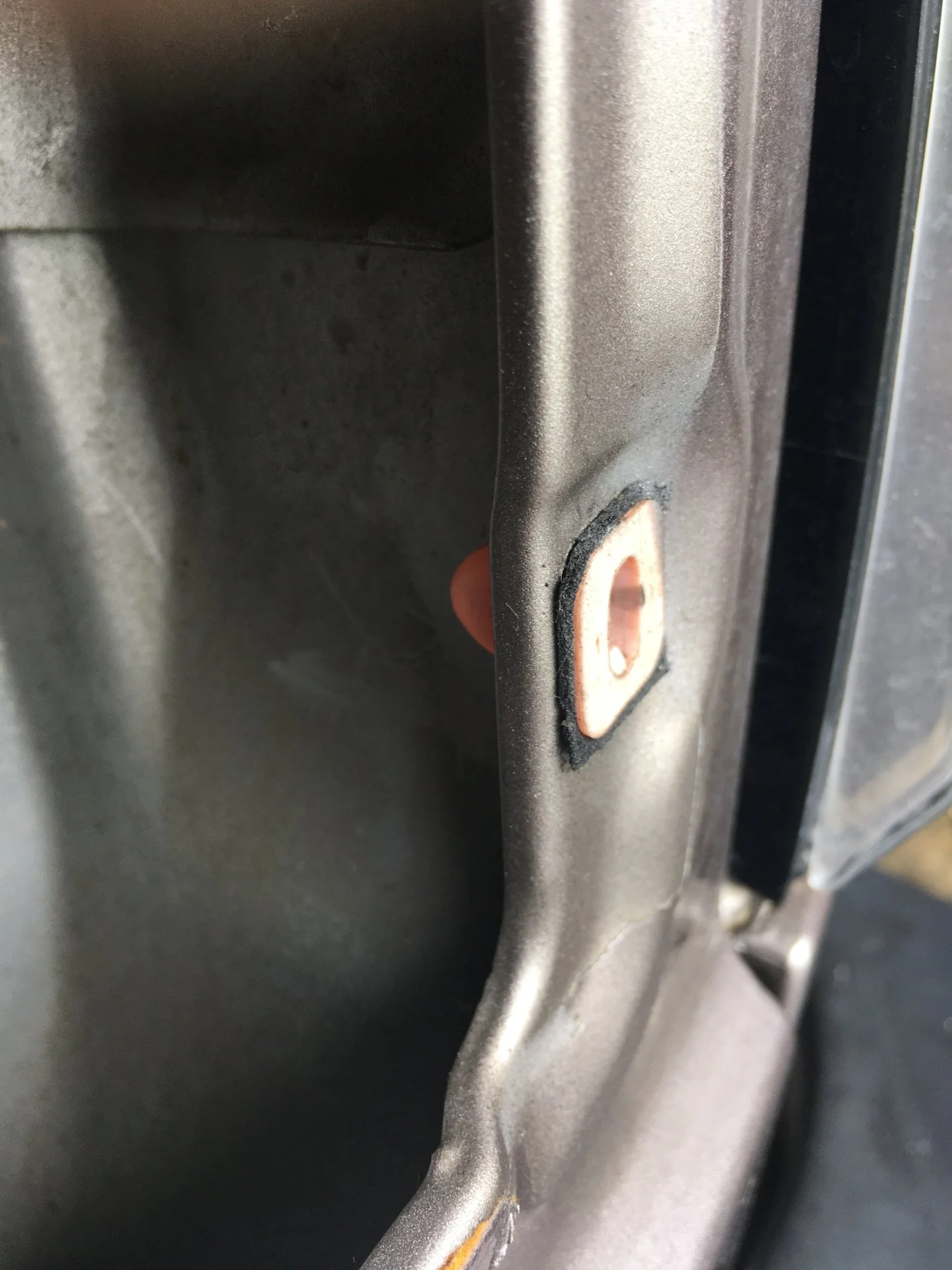

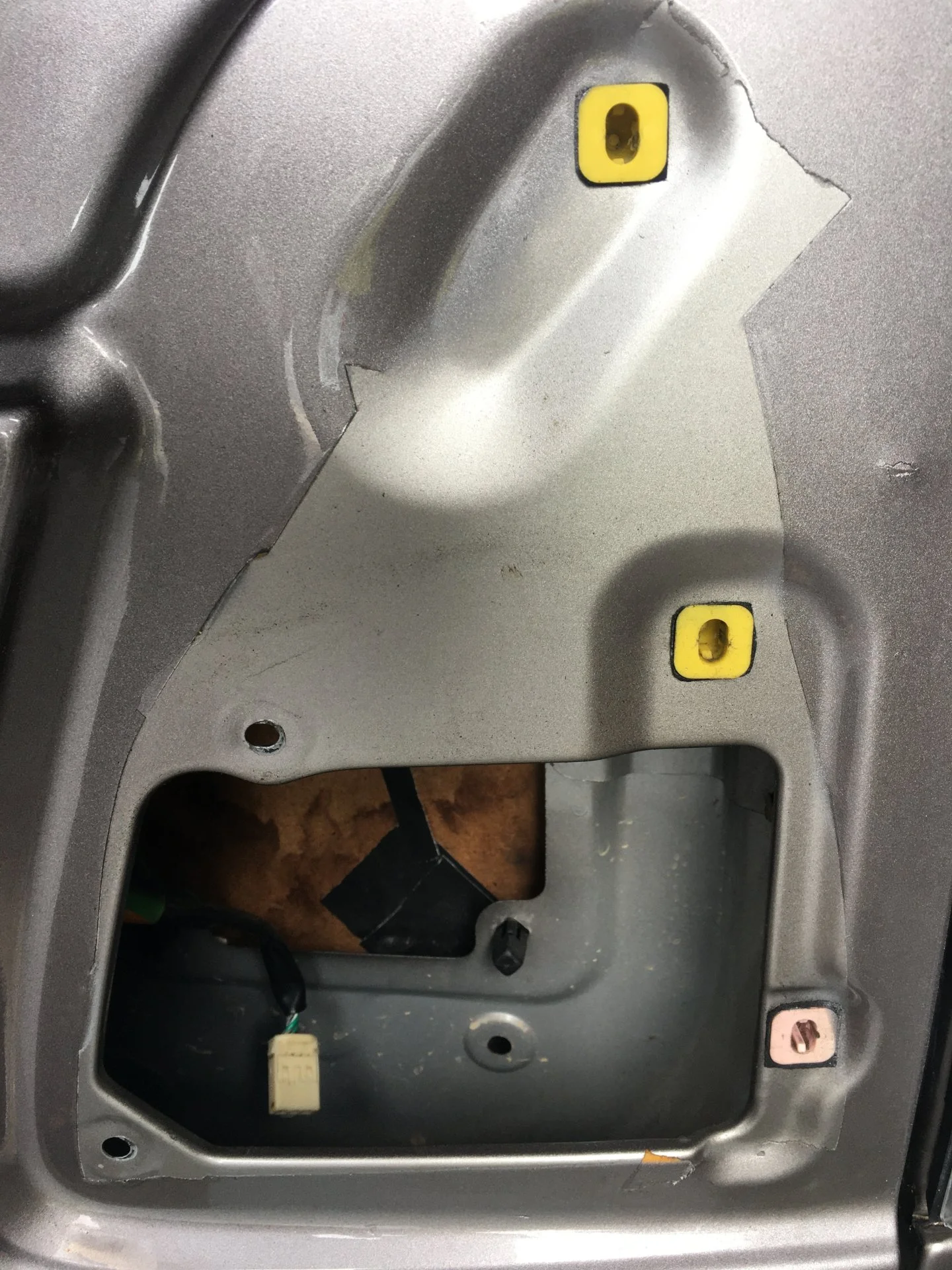

Hello all, Can anyone tell me the part number for these retainer clips? They are for the tail lights mounted on the tail gate of my 2003 Land Cruiser 100 series.
They don't grip the pins anymore so the light wobbles, i tried building the pins up to make a tighter fit but still sloppy. Thanks
The pinkish-colored ones should be 90467-09112, and the yellow 90467-09077.
This comes from partsouq.com, where I just dropped in a random eBay VIN from a 2003 and looked through the diagrams.
Thanks for sharing the partsouq.com technique for finding detailed parts. Awesome!
