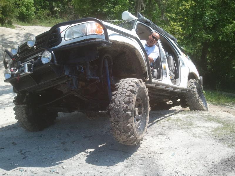

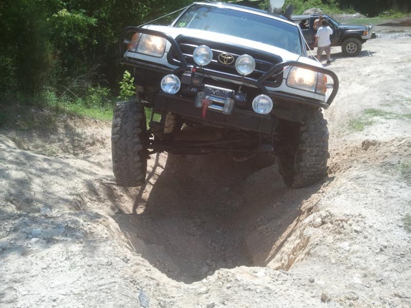

Stripped the doors off in preps for the custom tube doors. Here are some really geigh flex shots of the Suckohyea in 3 wheel drive because of a blown D60 hub gear.
But I am very happy with the results.

The Story on the ATRAC (the same system used on the FJ CRUISER (tested and wheeled by me till it BROKE) I was NOT a fan of "braking" traction control, Basically when a tire lifts off the ground, the ATRAC system senses it, and applies the brake to the spinning wheel, and forces the "other" wheel to spin. Kinda like a limited slip. I had my Sequoia up on 285's and wheel a ton of places on the rock in Choccolocco ORV park in Alabama. It work REALLY WELL. really shocked me!!!!! Other that frame height, the only thing that stopped the rig, was bottoming out, and taking the load off of all 4 tires. I did the "mini rubicon" at Chocco. with a LOT of spotter help, and she made it. I was again shocked... AND THEN!!!!
I was wheeling with a few friends at a rock pit in Florida. Going up a STEEp rocky wall, and basically going up a crevase with my drivers wheel about 4 foot off the ground, ATRAC doing the best she could. She still had traction, and I was moving forward, THEN BAM!!!!! the spider gears blew out of the front diff. sounded like a shotgun went off... then the ATRAC light started blinking... I laughed to myself when it happened because I realized I had just found the limits of the stock Sequoia 4x4 system. and that is when the SAS started///

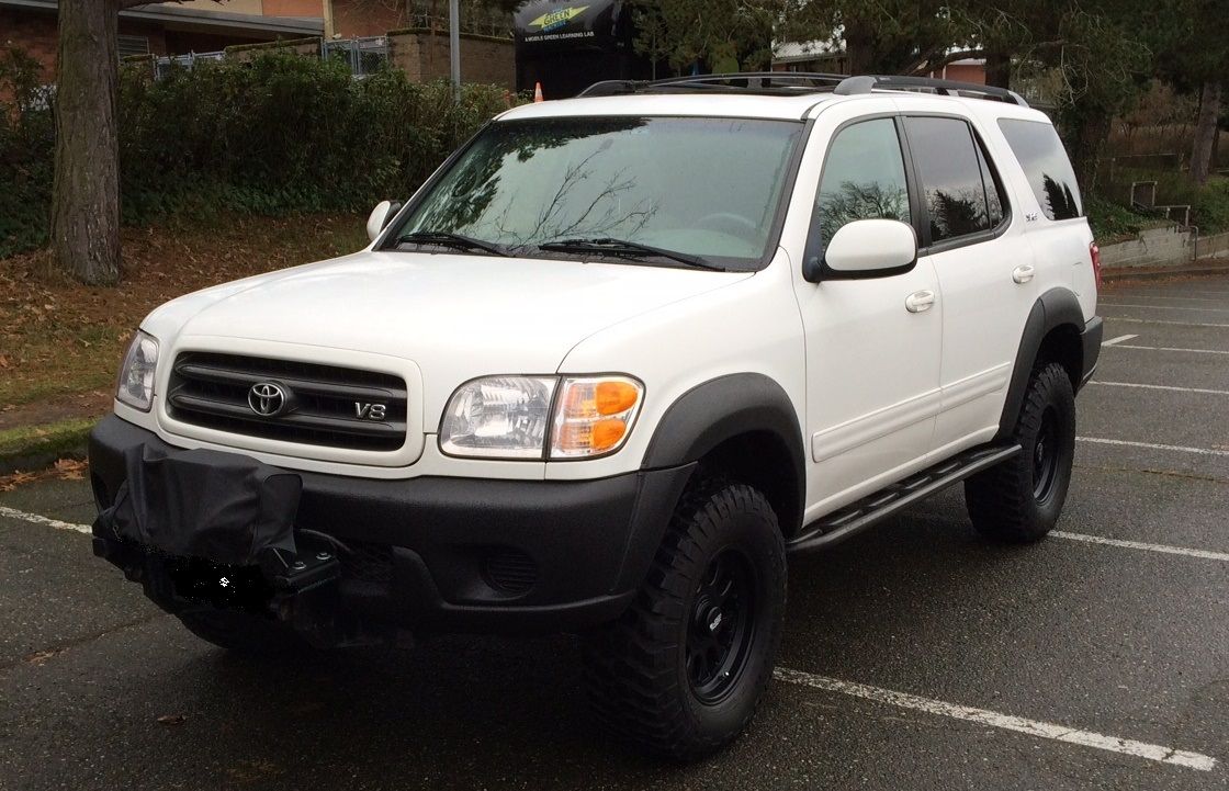

Hate to resurrect an old thread, but here's my '01 Sequoia. I take it off road all the time - nothing crazy, but it goes everywhere I used to take my CJ7. I was going to buy a new Rubicon 4 door, but for $44k, I decided that my narrower and shorter wheelbase Sequoia will do just fine. My winch gets me out of anything I shouldn't have tried, and so far it's done just fine. Toytech lift, BFG KM2's, Weld on Rock Sliders, home crafted winch mount, LINE-X on the stock bumpers and fender flares, and an electric speed controller to correct the shift rpm wit the 33"s. The only downfall to the Sequoia is lack of aftermarket parts, and the week front diff, and the fact it's a bit tall.
