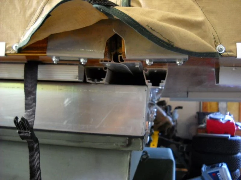

So ffor Camping Labs I have a problem with the long main platform hinge. If I am in the tent and happen to kneel in the middle of the hinge the two pieces sort of pop apart in the middle.

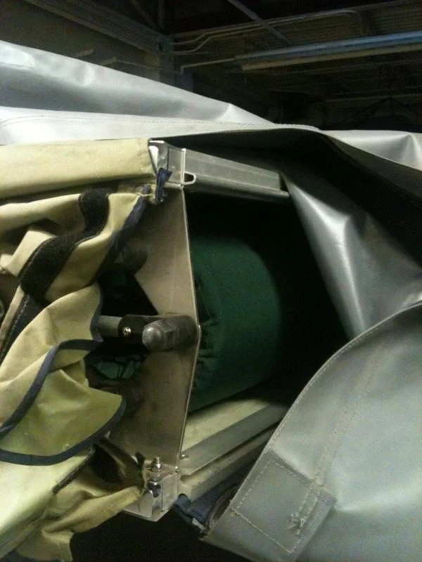

I have noticed in my rear view mirrows that air is getting into the tent cover and causing it to balloon quite a bit. This raises its profile and ups the wind resistance, impacting gas mileage.

Jim,
If the aluminum hinge/extrusion that mates together, is the same as Mombasa's, is seperating when you kneel in the center, try this:
-make sure no fabric, the mattress cover gets saggy specifically, is caught in the mating area
-make sure the extrusions are fully mated, this sometimes requires pulling the ladder away from the ground and giving it a downward pull to get them together.
-check your hinge to make sure all bolts are tight and the hinge hasn't shifted allowing for misalignment. (these bolts do come loose. as a matter of habit, check all attachments on these tents, due to the vibration they will work loose.)
-check the bolts holding the hinge plates to the base to assure they are in place and secure.
-Sometimes the fabric gets tight keeping the tent from fully opening. If this is the case, check to make sure your fly pole is seated in its pocket, this is the 3/4"+/- pole up high.
Below is a pic of the male/female extrusions and the hinge plate of a Mombasa tent, for reference.
I hope this helps, if not let me know and I'll try to help you figure it out. I am posting this to help the community not to step on Fernando's toes, I have heard tons of great things about him.

Thanks for the feedback and the hinge photo Jeremy! Two things that I found.
One was that the velcro straps that would hold the mattress in place had come loose. This allowed the mattress to often get caught in the hinge.
Two was that the original owner had told me that I could just leave the RTT cover hanging from the groove. I found that this bit of vinyl was thick enough to keep the hinge from seating fully.
I'll also double check the hinge bolts as advised.

Good to hear that you have it sorted out. I have been able to leave the cover attached, I wonder if the cover was sewn a little to close to the welt, which wouldn't allow the two surfaces to mate properly as you said???
