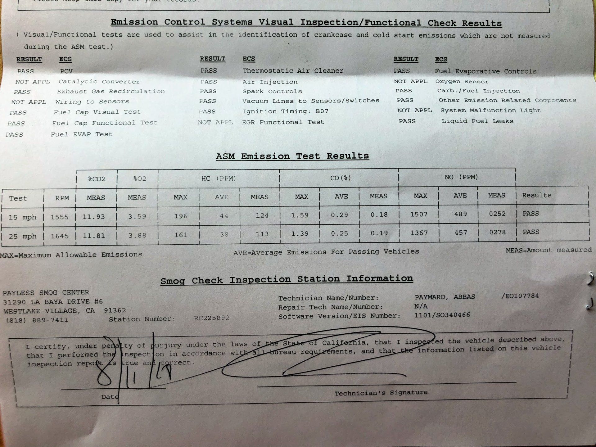

Well, my truck passed again. Posting the results to help others baseline. It's a federal spec '78 with the original 2F, carburetor, stock exhaust, and all the original emissions gear. No cat or other whacky CA smog equipment.
Nicely done. I've had issues in the past getting my 2F to pass smog in Phoenix when I lived there. Finally gave up and registered it in Montana, which solved the problem :-)
Also worth mentioning that I’m using a fuel additive for the test. My truck is tuned pretty well, but the squeaky clean fuel probably helps too.
