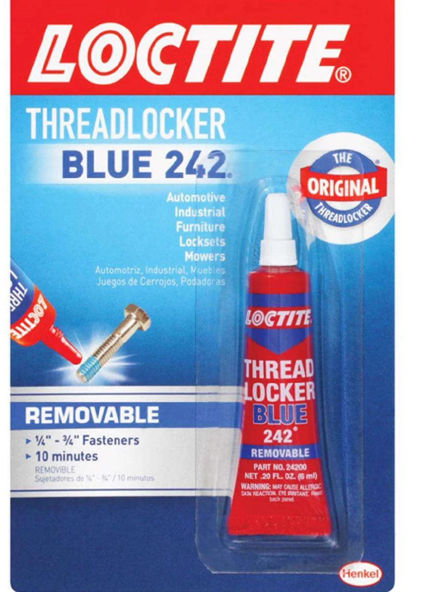

What kind of thread locker are you using? I think you should be using a thread sealer, which could be something like the permatex form a gasket. Permatex makes something specific for water pump bolts, etc.
It’s either this or something very similar.
