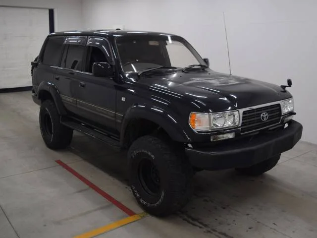

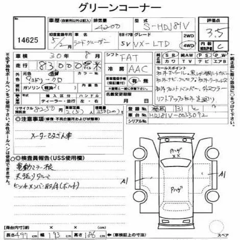

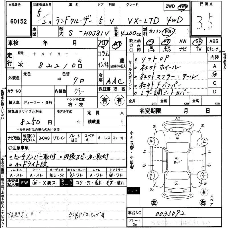

Advertised on Craigslist in multiple cities. Mileage advertised as "86,xxx kilometers", marked as "odometer discrepancy" when auctioned in November and December 2017 in Japan. Also appears to have been painted since last sale in Japan.

I'll add that it's not always a dishonest seller, sometimes it is. Many of these odometer issues and quick paint jobs are happening in Japan. Quite often, the US seller doesn't know.
