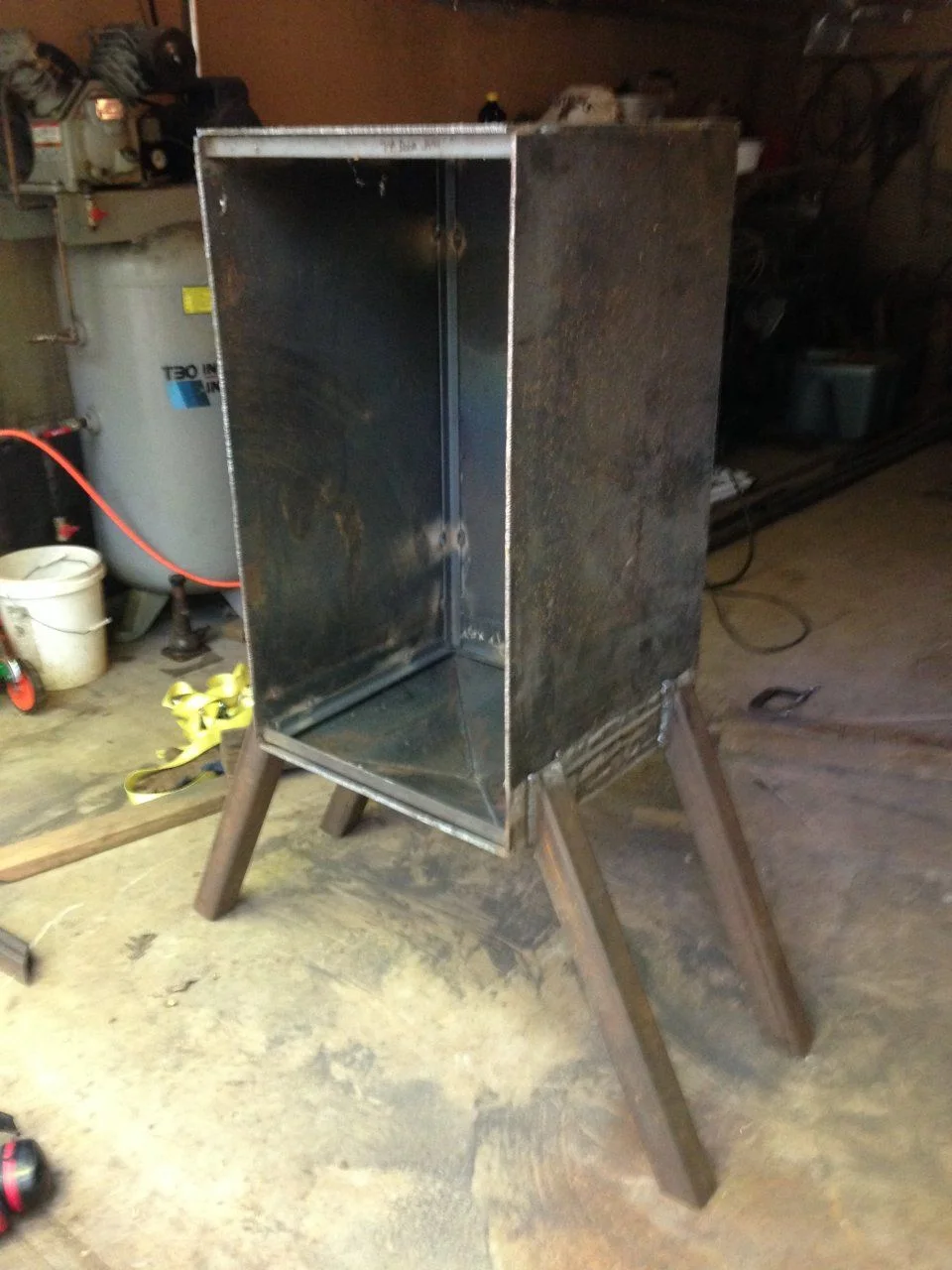

The goal is to finish this up by Christmas, so I need some motivation. The end goal is a vertical smoker with 3 cooking racks and a water pan. I've got 1.5 ~ 4'x6' sheets of 1/4" plate in this thing and it weighs a ton, but should probably be around a while.

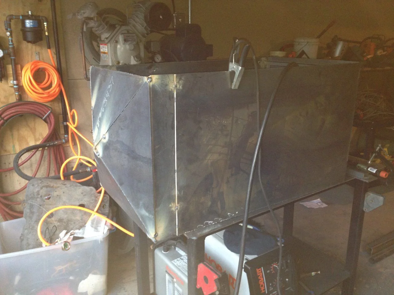

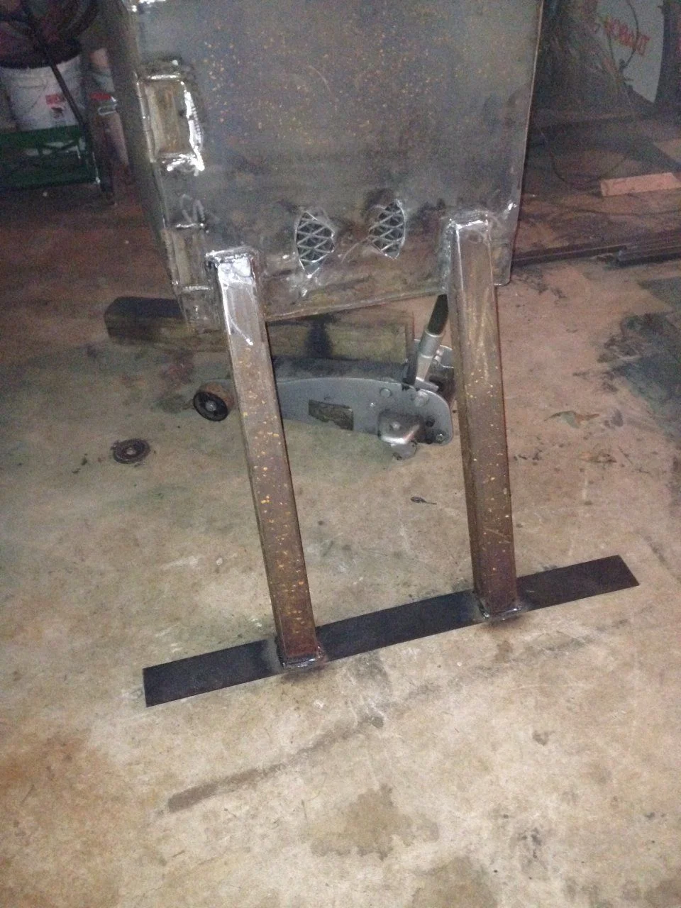

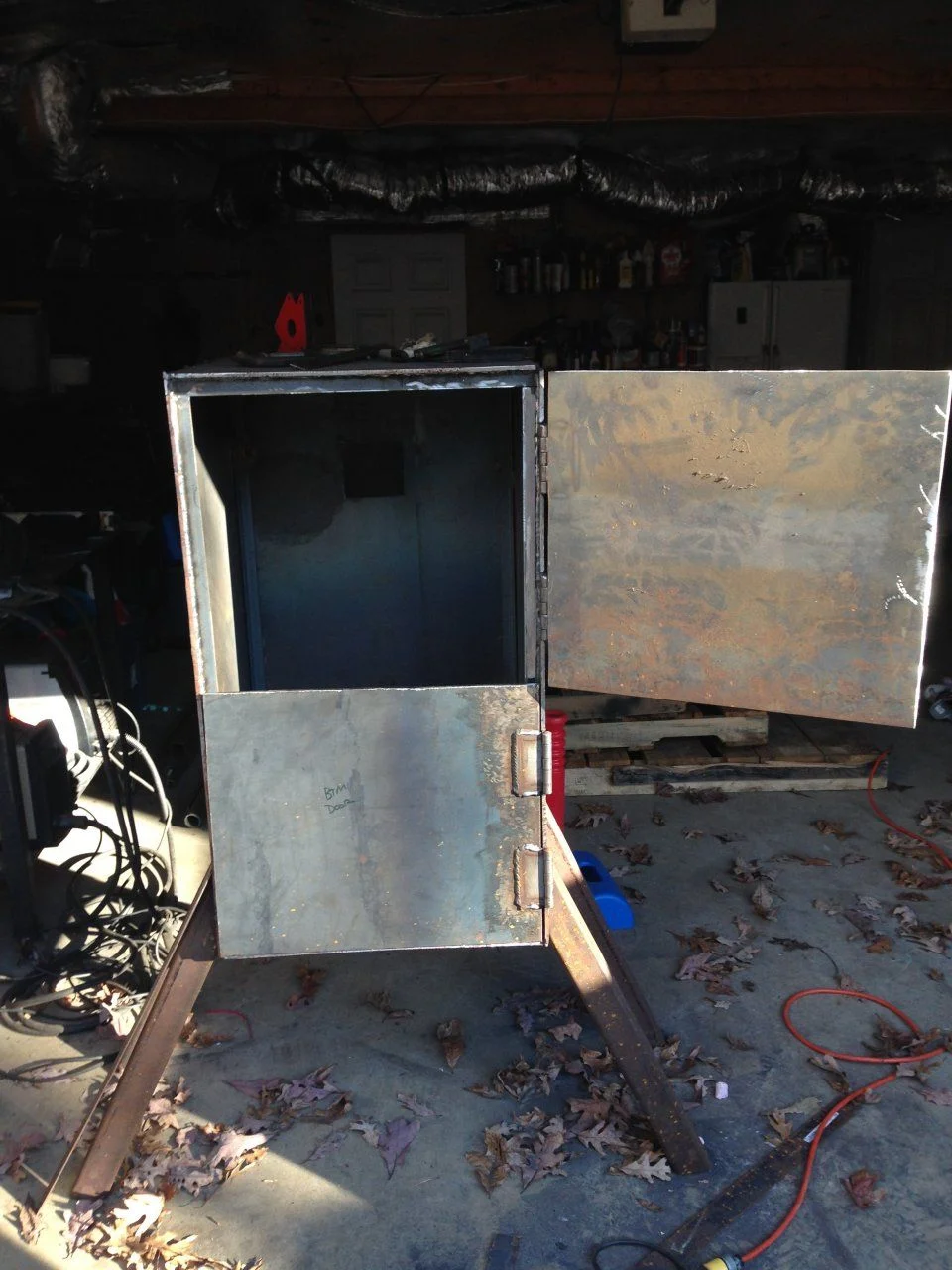

Here is the main box coming together - those angles on the bottom severely stressed my geometry skills...

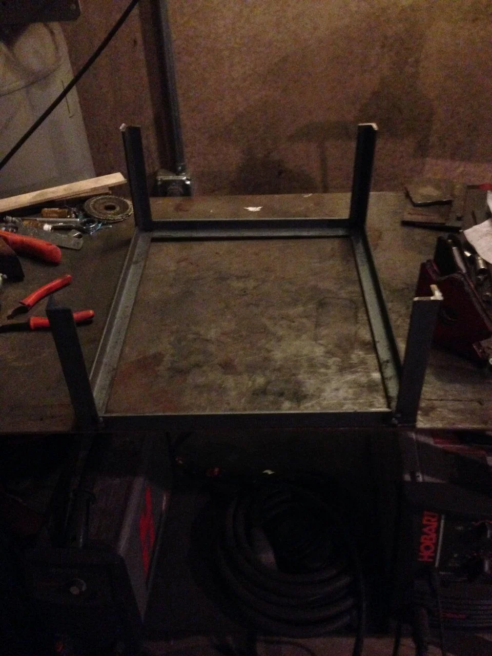

On all fours

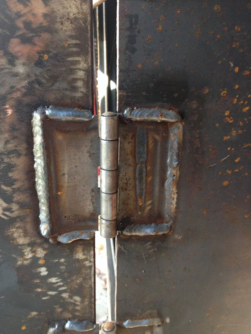

I frenched in the hinges such that the doors would close flush with a to-be-insulated lip around the door threshold.

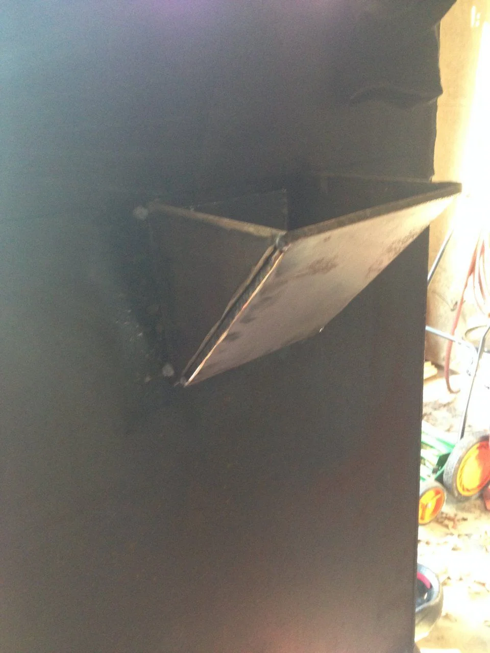

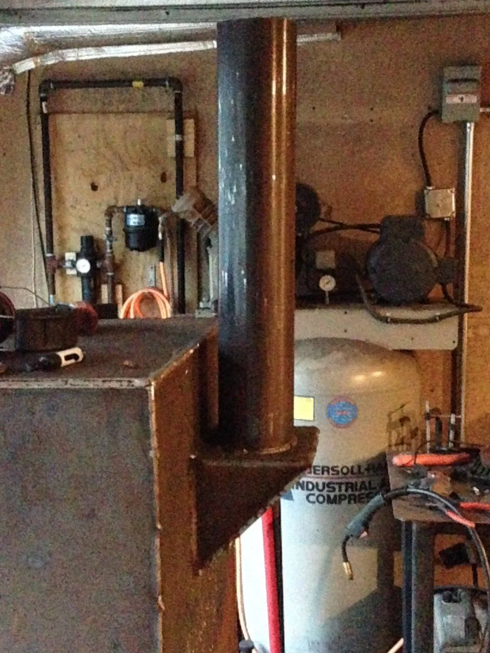

This will be where the exhaust pipe mounts on the back.

Those are some good looking welds. you using gas or flux wire?
And 1/4" plate.... :eek: I bet the sumbitch is heavy, but shouldn't go anywhere anytime soon.
I like projects like this, will be checking back in regularly.
Switched to gas before I started on the truck and like another saying, I won't be going back. Don't worry though, there are plenty of ugly welds but nothing a grinder won't fix.

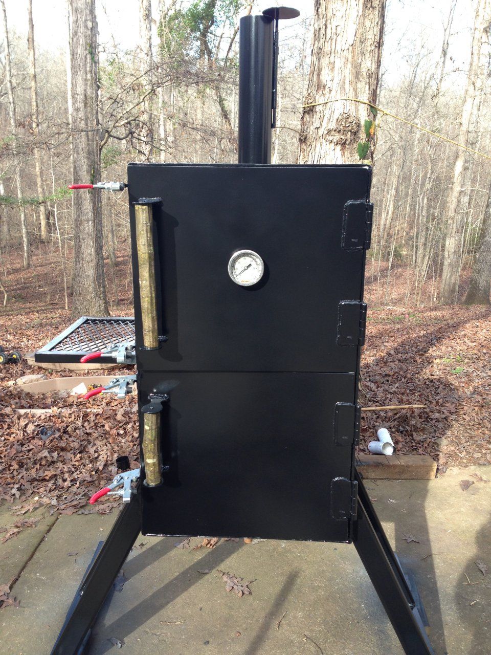

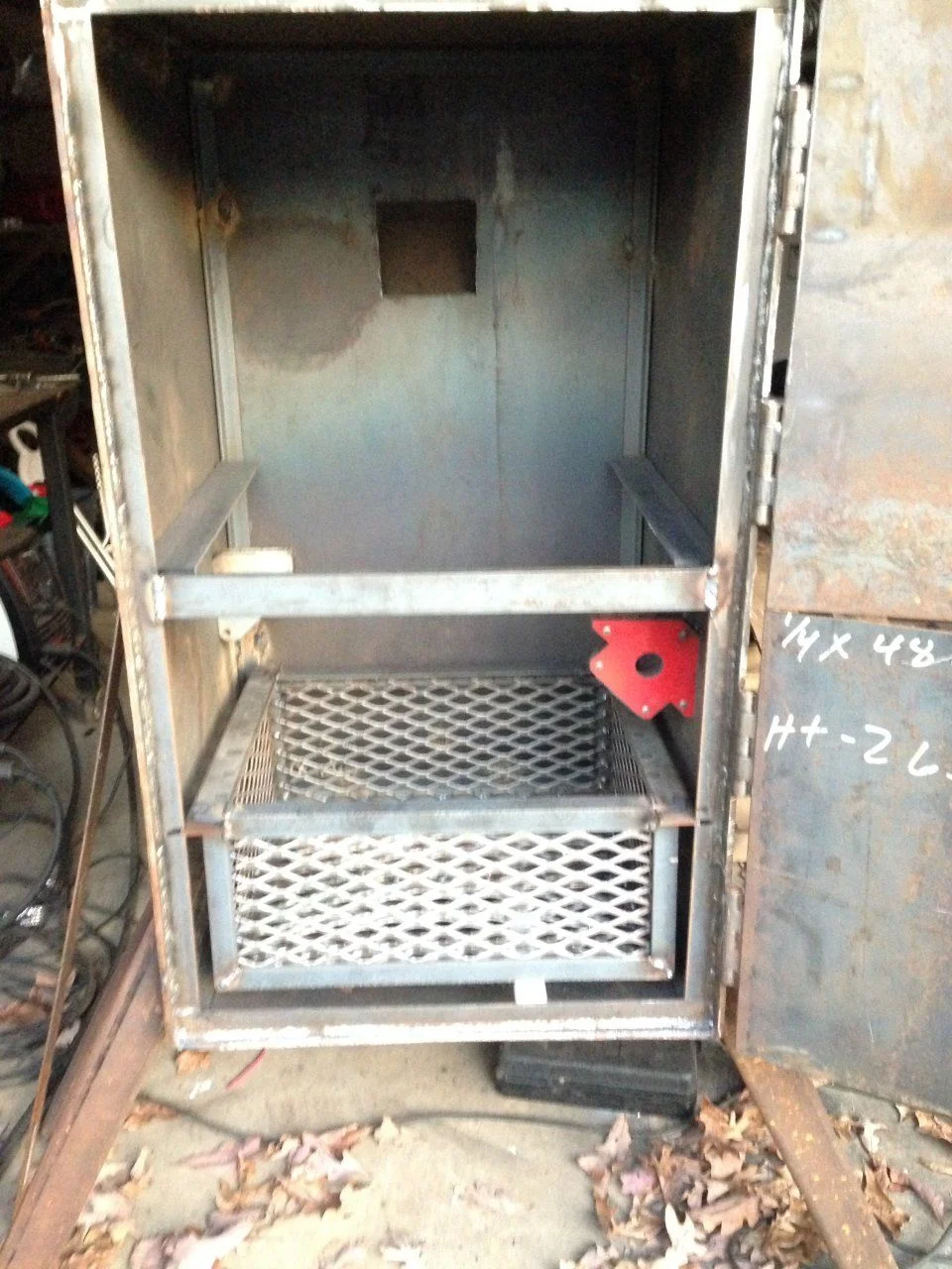

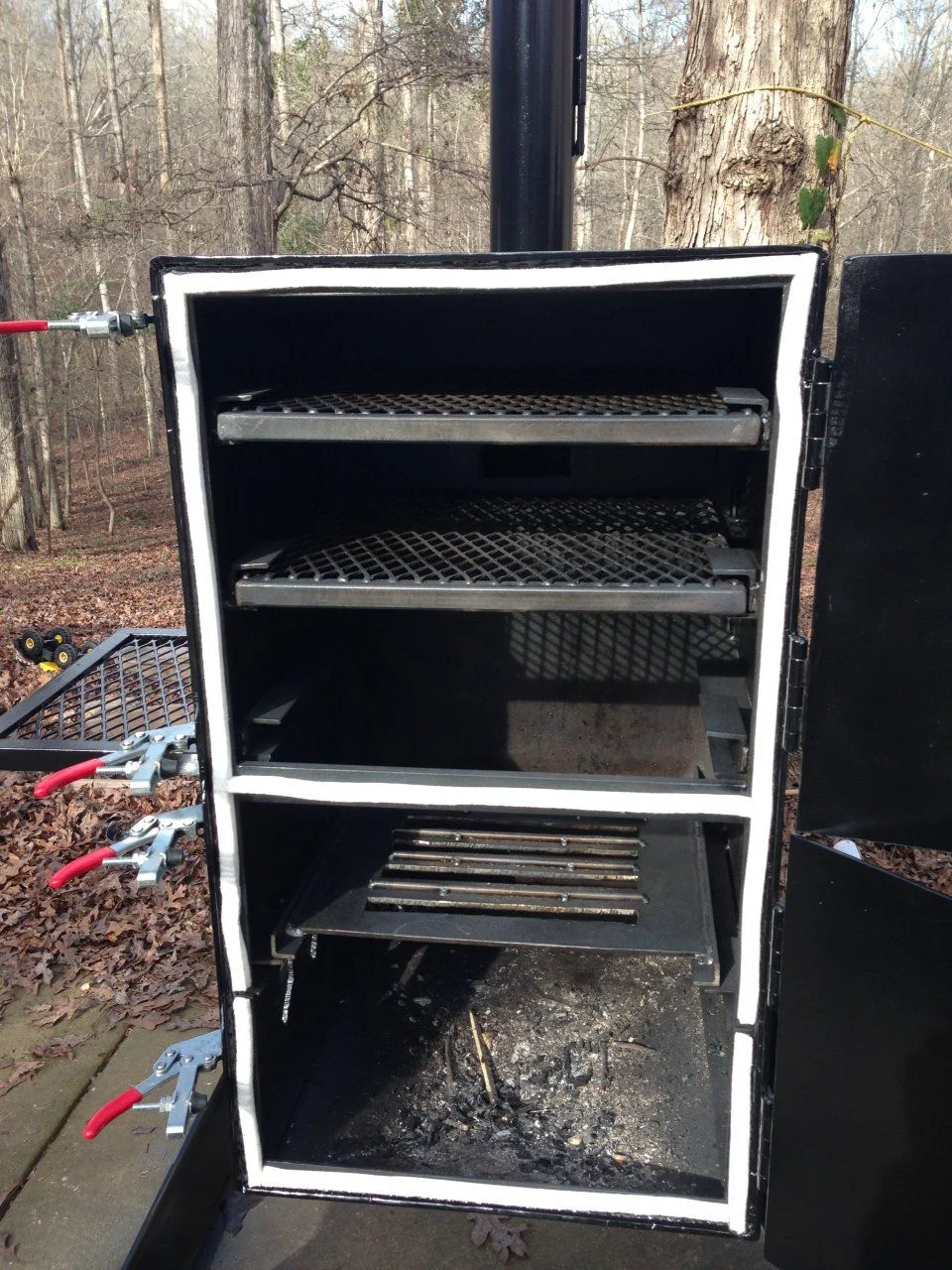

A pic with the doors
And tonight's progress on the charcoal box. I'll fill in the openings with expanded metal.

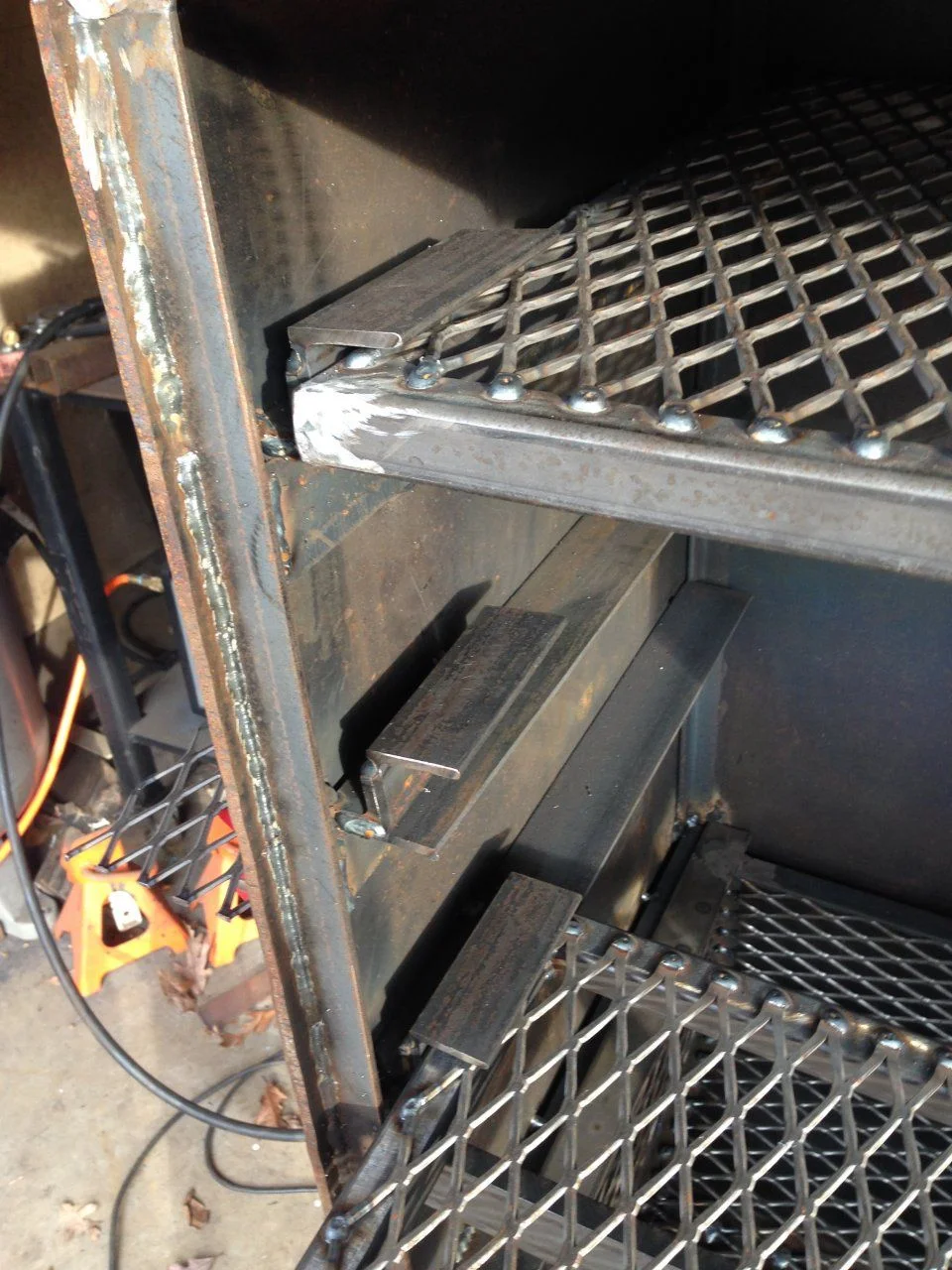

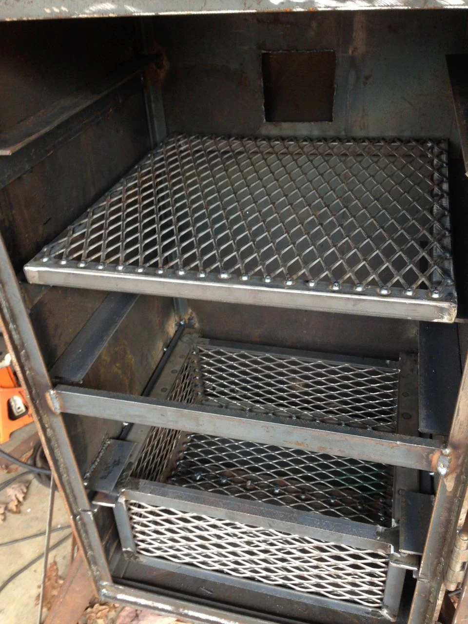

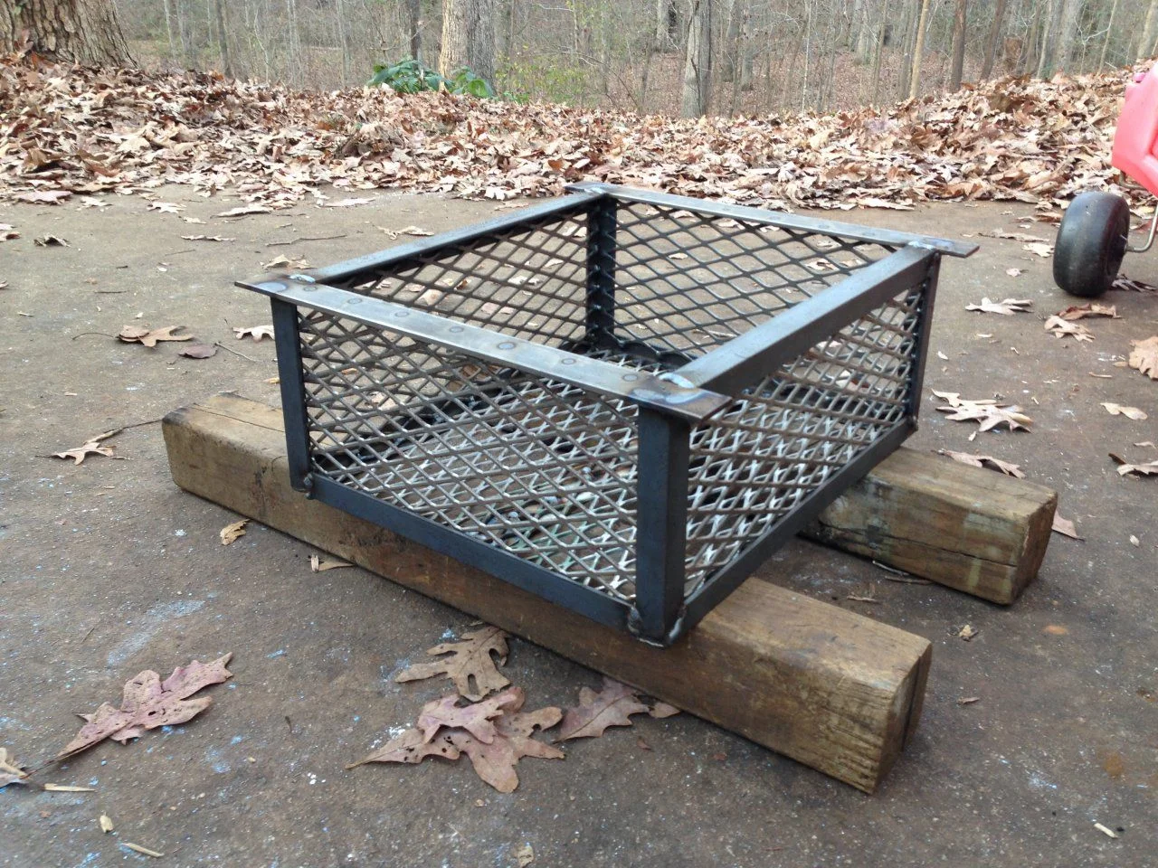

Made some progress this weekend. Cooking racks done.
Added some catches such that the Q doesn't end up on the ground when you pull the racks out.

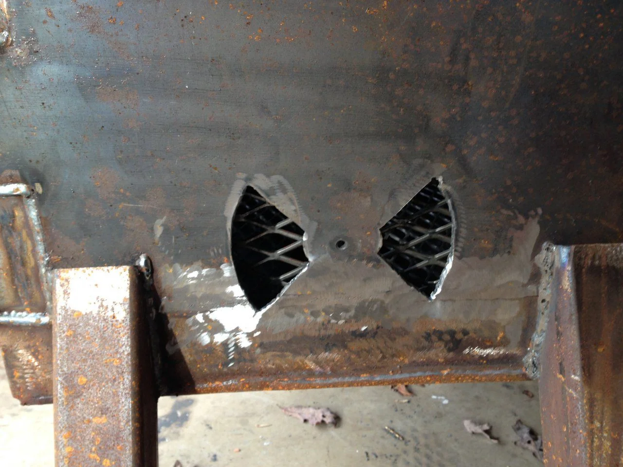

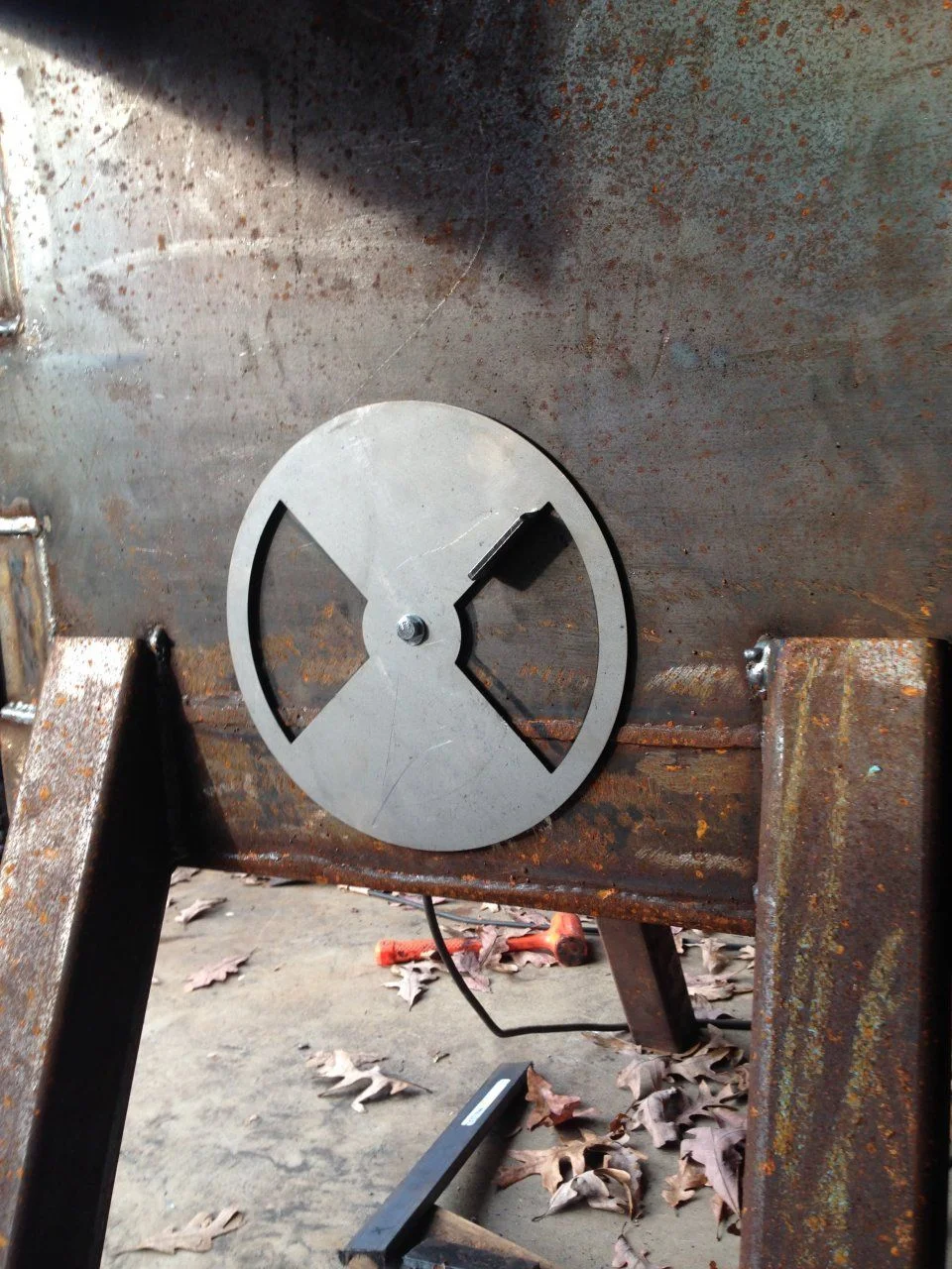

And this is the start on the air intakes. I still have to cut the holes.
Yum, I can smell the BBQ now... Also looks like you're pretty good at cutting out circles. :smokin:

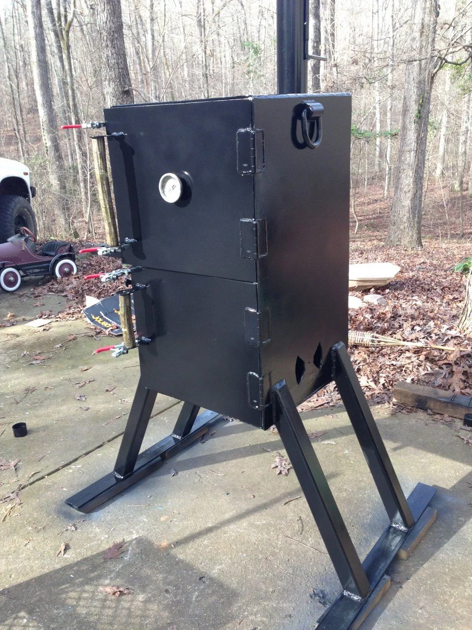

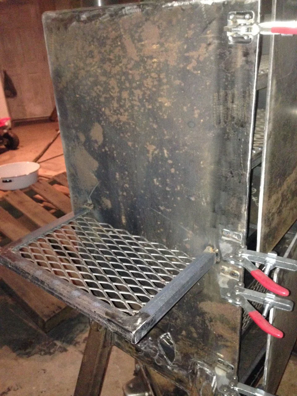

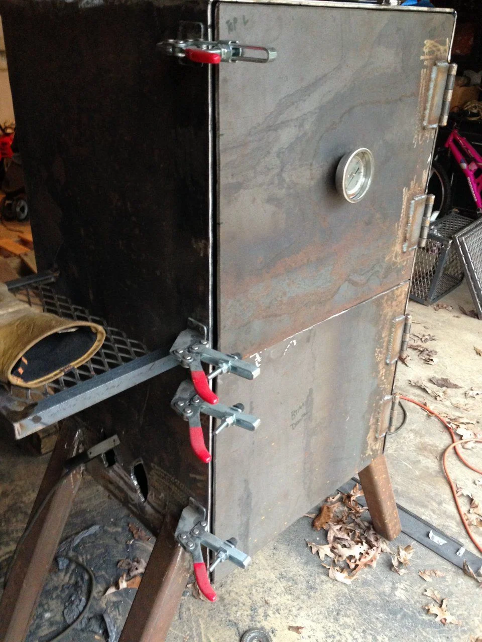

Almost there. All that's left are handle, a test run, and paint.
Latches

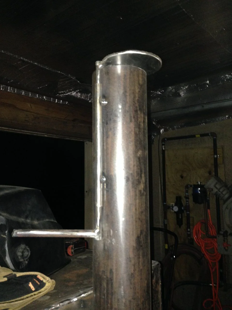

Exhaust regulator
Shelf
And she's ready to hit the slopes.

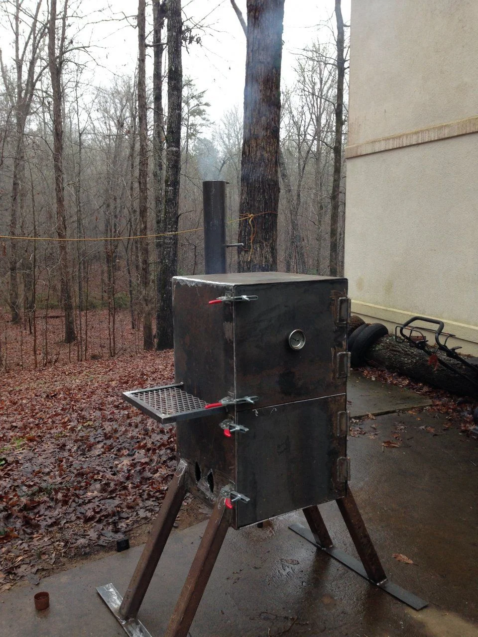

Unfortunately I didn't put anything on, just tried to get it hot and burn any crud out of it.
