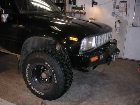

Here's my front. Not the prettiest out there, but stout.
Note to self: next time I recess the turnsignals and fog lights into the bumper like this, I'll remember to drill the tabs first. :doh:

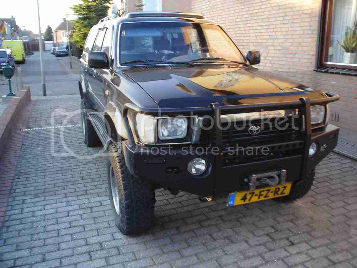

Something to keep in mind…I find the wrap around corners on the sides (like in post 5) very useful. They push the truck away from obstacles preventing you from smashing the fender and side marker light.

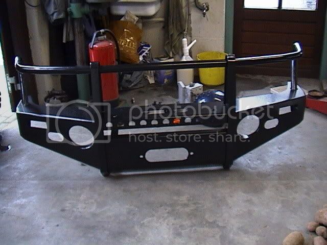

Here's my front bumper. Made from sheetmetal and a bent LC80 pushbar.
