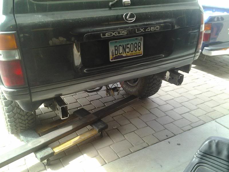

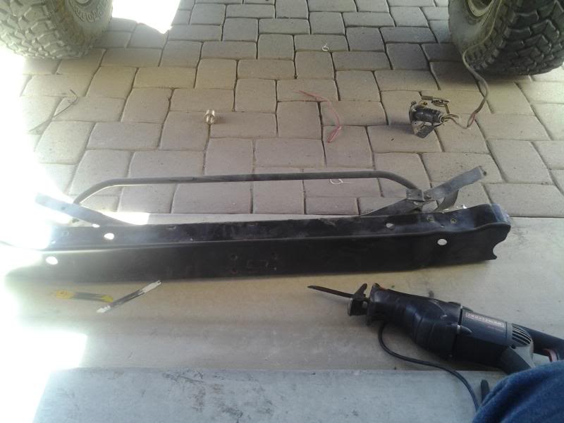

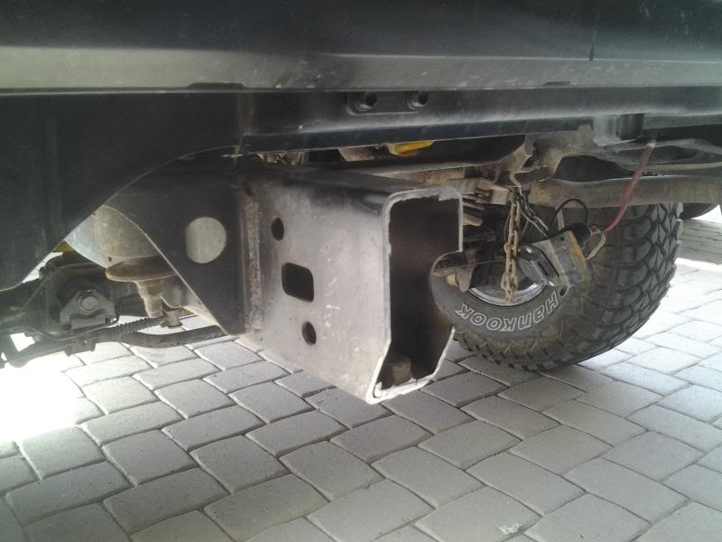

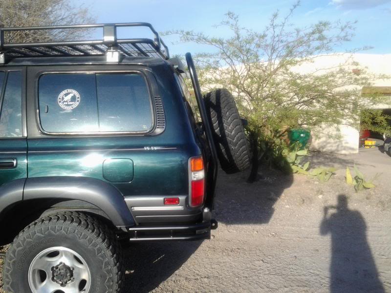

Now here is V2 that I built for the 97 LX450. I am not going to type a play by play on this one just pics. I did not show any of the bending or the side bars, ladder ect because most folks dont have a bender anyway and if you do you should know how anyway:rimshot:
If you have any questions just ask :) I need to stop building bumpers...every time I build a bumper I sell the Cruiser. Looks like I may be getting a FJ Cruiser and selling the LX:lol:
How's this for low profile!

The V1 was easier to build V2 is much stronger. If I do another I would for the main bumper like V2 and side wings like V1. The the departure angle on this new one is nuts....even better than 4x4 labs.
