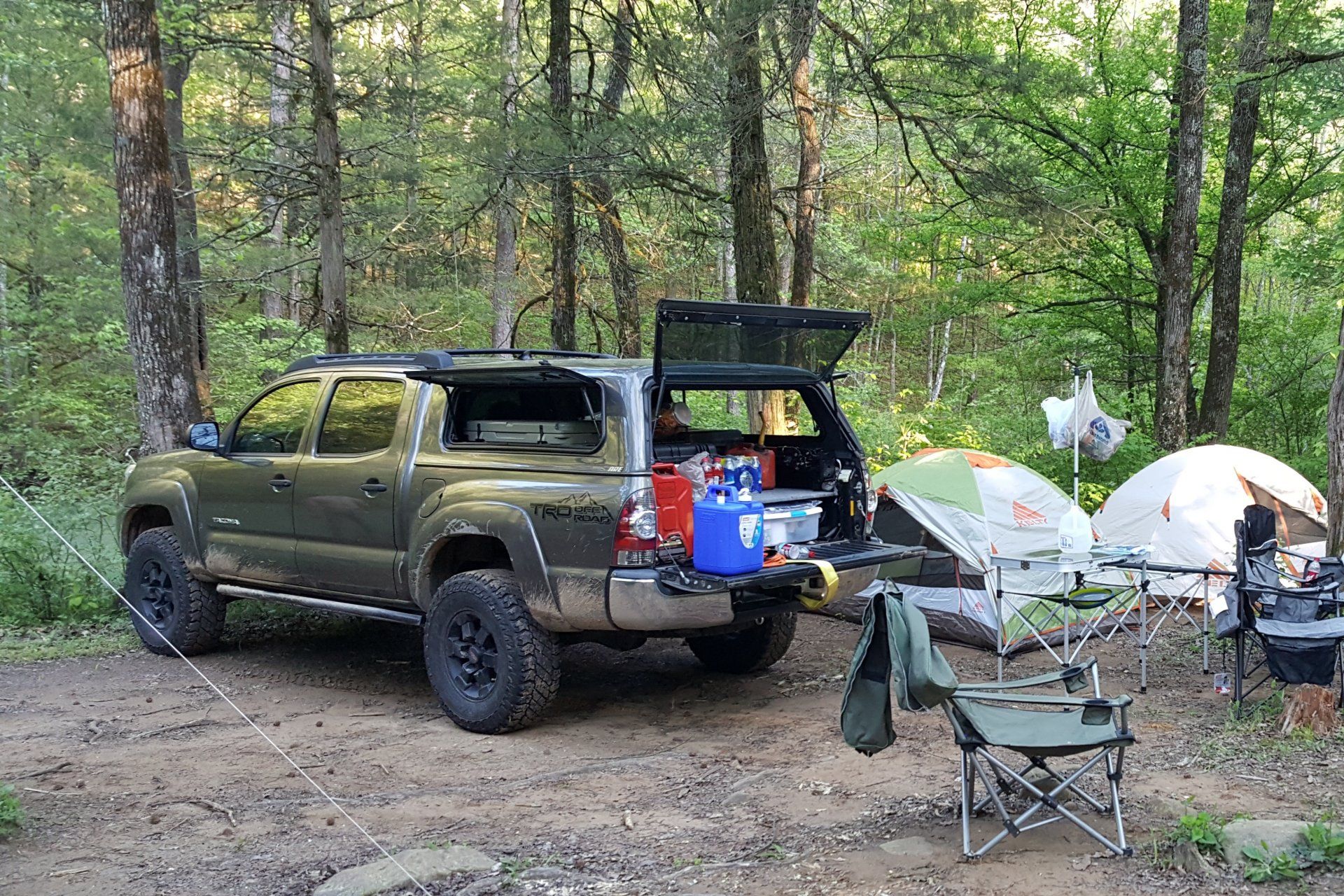

I have a very similar setup in a 13 with top, it also stays loaded with deck systems and offroad equip/gear, originally when I replaced all the suspension I took a friends 2015 springs 4 leaf with 5K on them and added a 2 inch AOL and I added the Timbrens but fully loaded offroad I was bouncing off of the bumpstops to much and was stretching the springs. April this year before an overland trip to the Ozarks I swapped the springs out for OME Heavy DAKAR springs and now I never come close to the bumpstops even when fully loaded for a trip. The Timbrens are really nice as in when you hit them it wasn't a hard stop like the OEM stops rather a cushioned stop which was active and much better on ride and my mind. When you feel those hard bottoming out blows on the OEM stops you know what I mean. I would sell your springs for what you can get for them and upgrade to heavy spring set.
