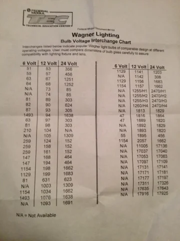

Bulb conversion for 24volt JDM
Feb 27, 2008
31
294
eugene oregon
I was trying to track down a few bulbs when I found most that were available are 12volt several shops carry Wagner lighting products and this is a cool conversion chart I found that helps you find a corresponding bulb in the proper voltage. I used it to locate a bulb for my dome lamp. The 12 volt version of the Bj 70 had 11005 as the bulb ordered the 17136 as the chart calls for fit perfect and got the right bulb. This info has proven hard to find and I see numerous questions for this info so I thought I would post it up!
