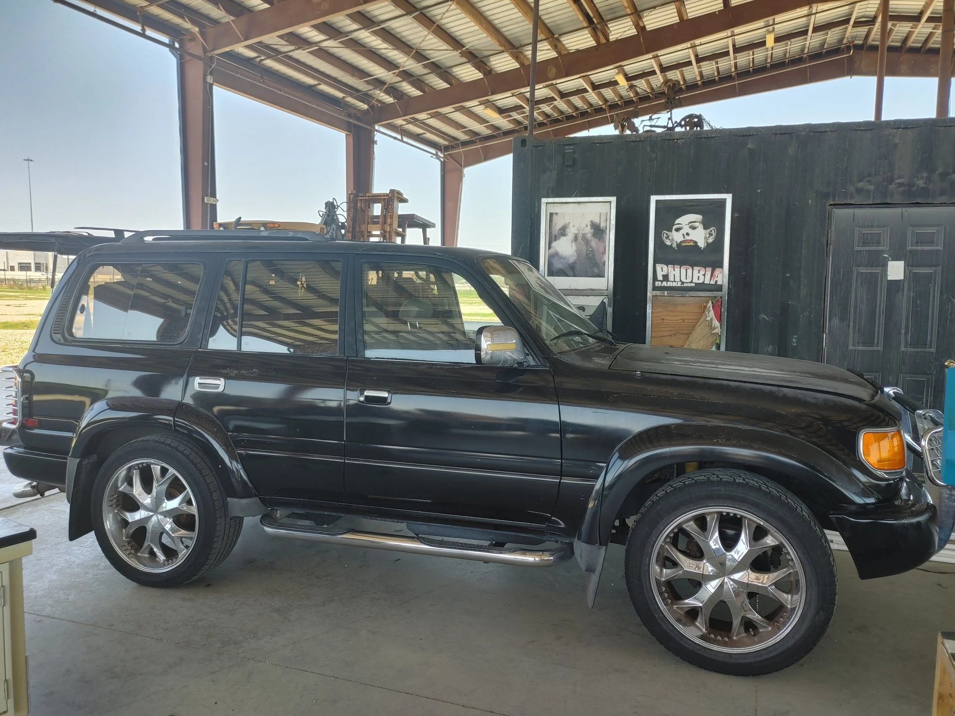

So, after many months of work. I've finally finished my 80 series build. Had to pawn my grandmother's ashes, but the build looks sick with all this chrome!!!

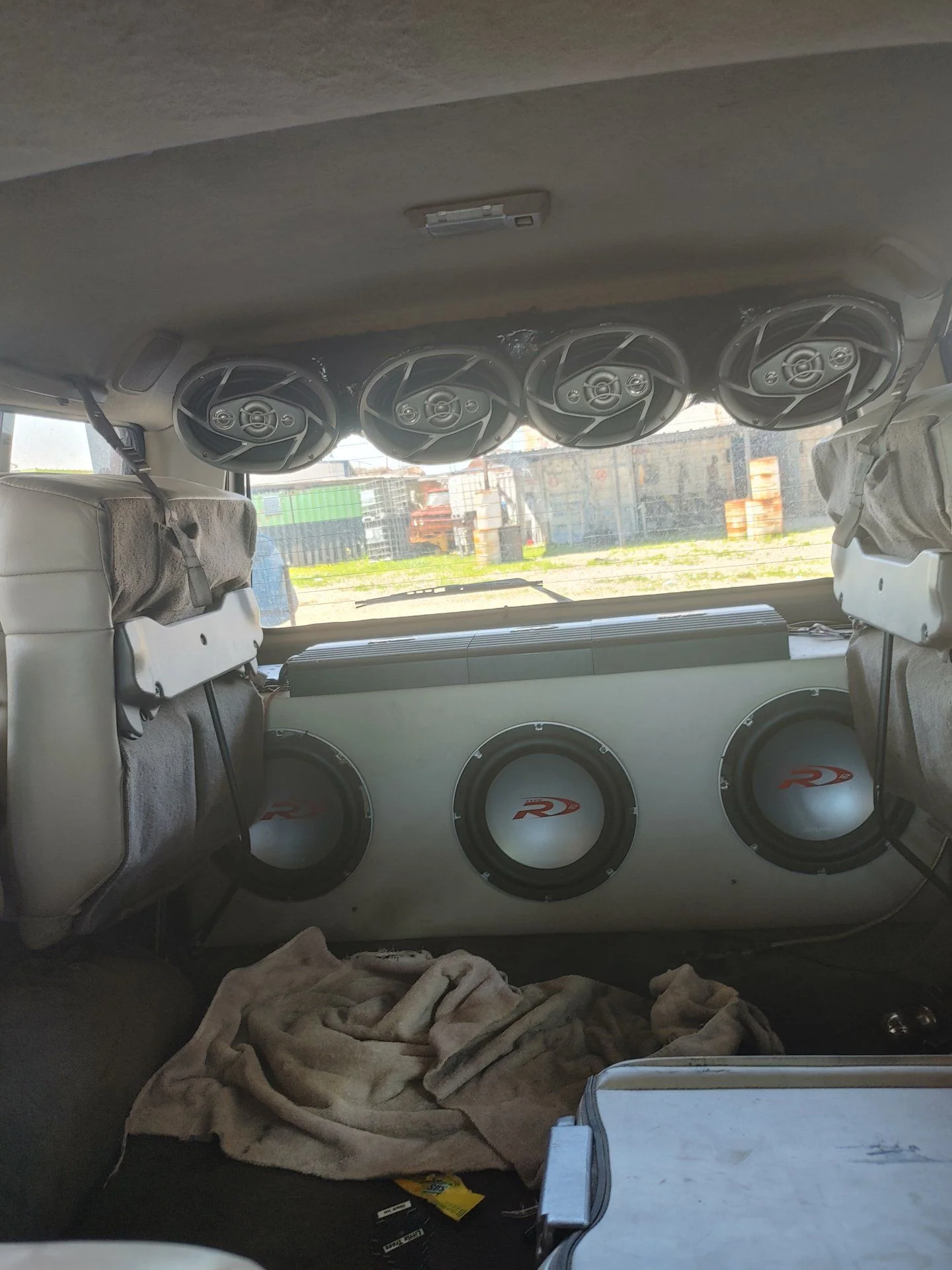

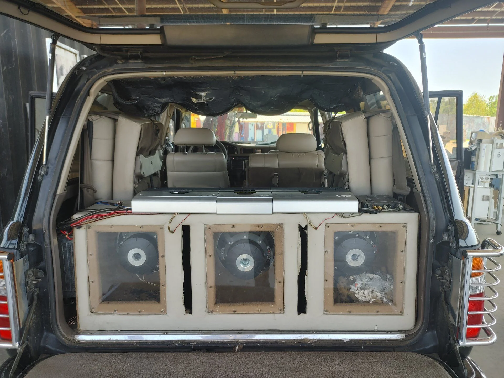

Jokes aside, I picked up this 96 in Dallas last week for $1500. She runs and drives, and has a relatively nice interior. Engine & Exhaust were making some noises at the time of purchase but I bought this vehicle knowing it may cost me a rebuild or an engine drop-in. The previous owner passed away and the family was looking to get rid of it without knowing the value of the car. Can't say if I've overpaid or underpaid yet, but If this does not require an engine rebuild, I will be a very happy/lucky buyer. I have found mouse droppings/nesting inside, poorly spliced/exposed wires, a mirror held on by a bungee cord, and a few more issues. Those speakers in the back? Screwed in and covered completely in fiberglass, so I couldn't remove them without creating a serious mess.
I've named her Sprinkles because the previous owner probably enjoyed a sprinkle of coke every time they decided to go to his local gas station or car wash to bump his music.

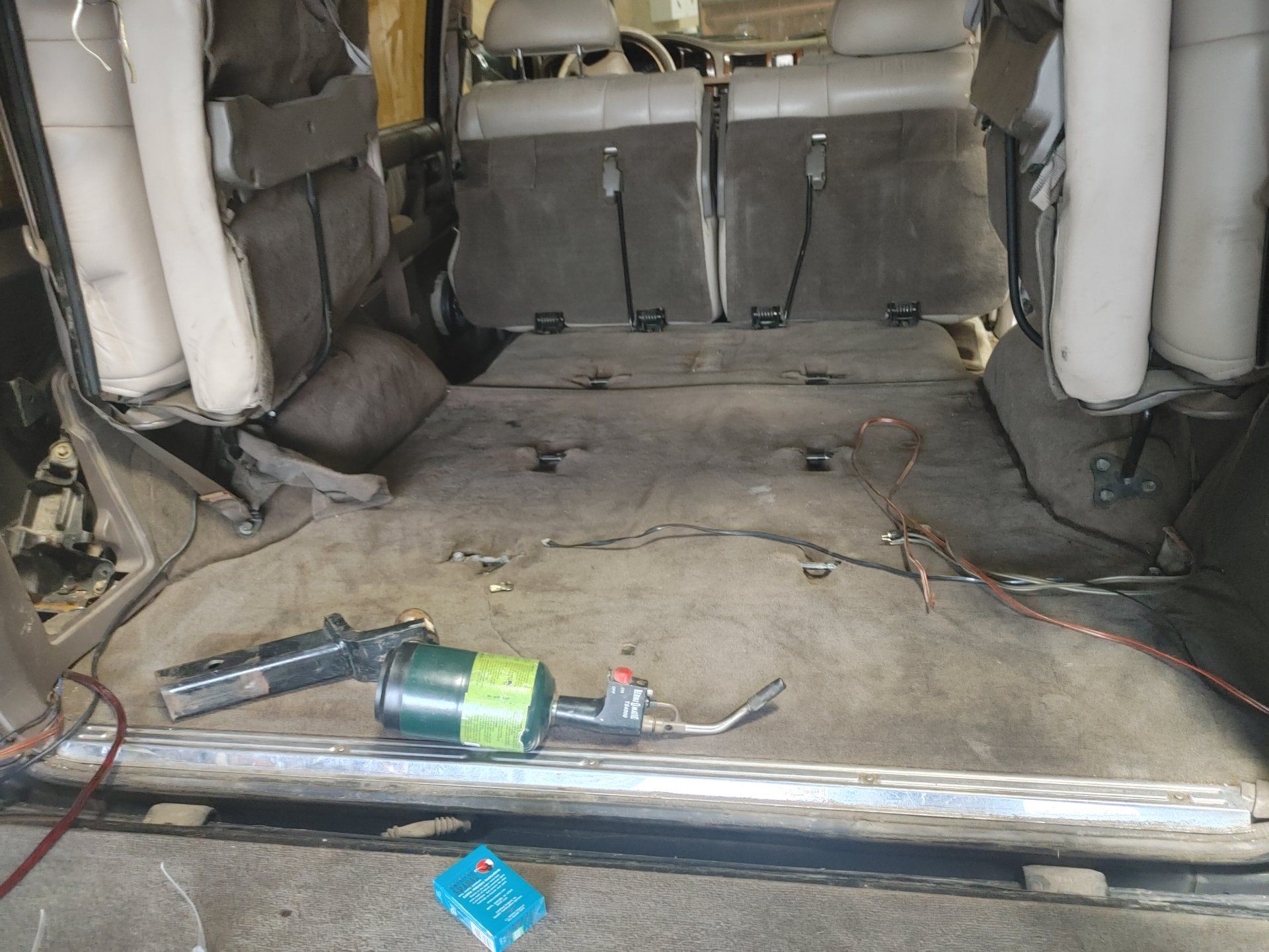

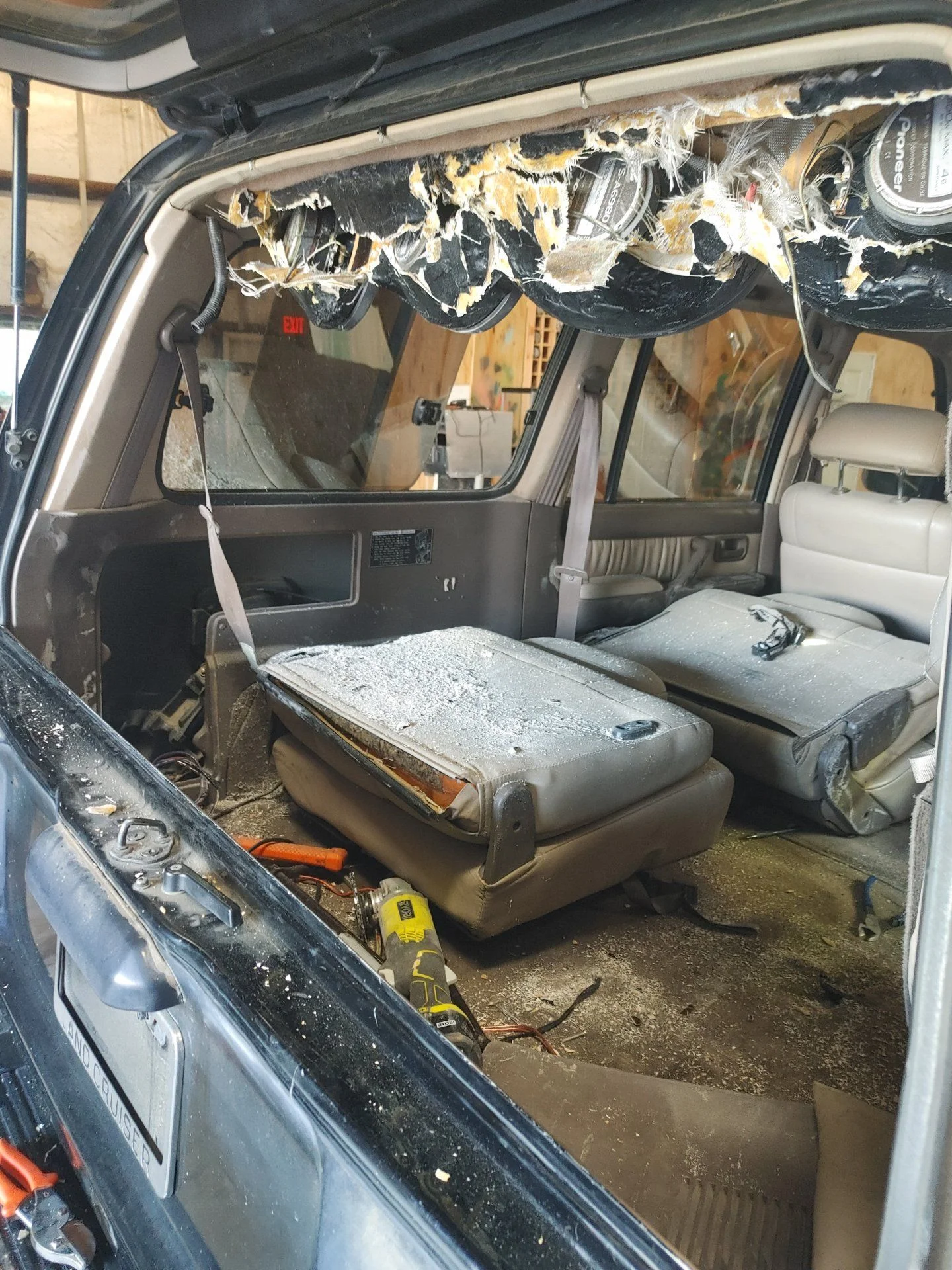

Trying to De-pimp this ride. Here are some pictures of the fiberglass action. I've removed the chrome tip on the exhaust, the chrome tail light protectors, the chrome side mirrors, and the speaker set up and wiring. As I stated in the previous post, all the supports for the fiberglass top speakers were put inside the fiberglass. So there wasn't really an option other than going to town with a saw followed by a shop vac. I'd advise wearing an old hoodie, glasses, and a mask.
No beauty shots until I can get some new rims, embarrassed to drive it as is.
Holy hell, that is tacky AF! Glad it found a new owner who will bring some dignity back to this rig. I'm excited to see this thing transform back to its roots!

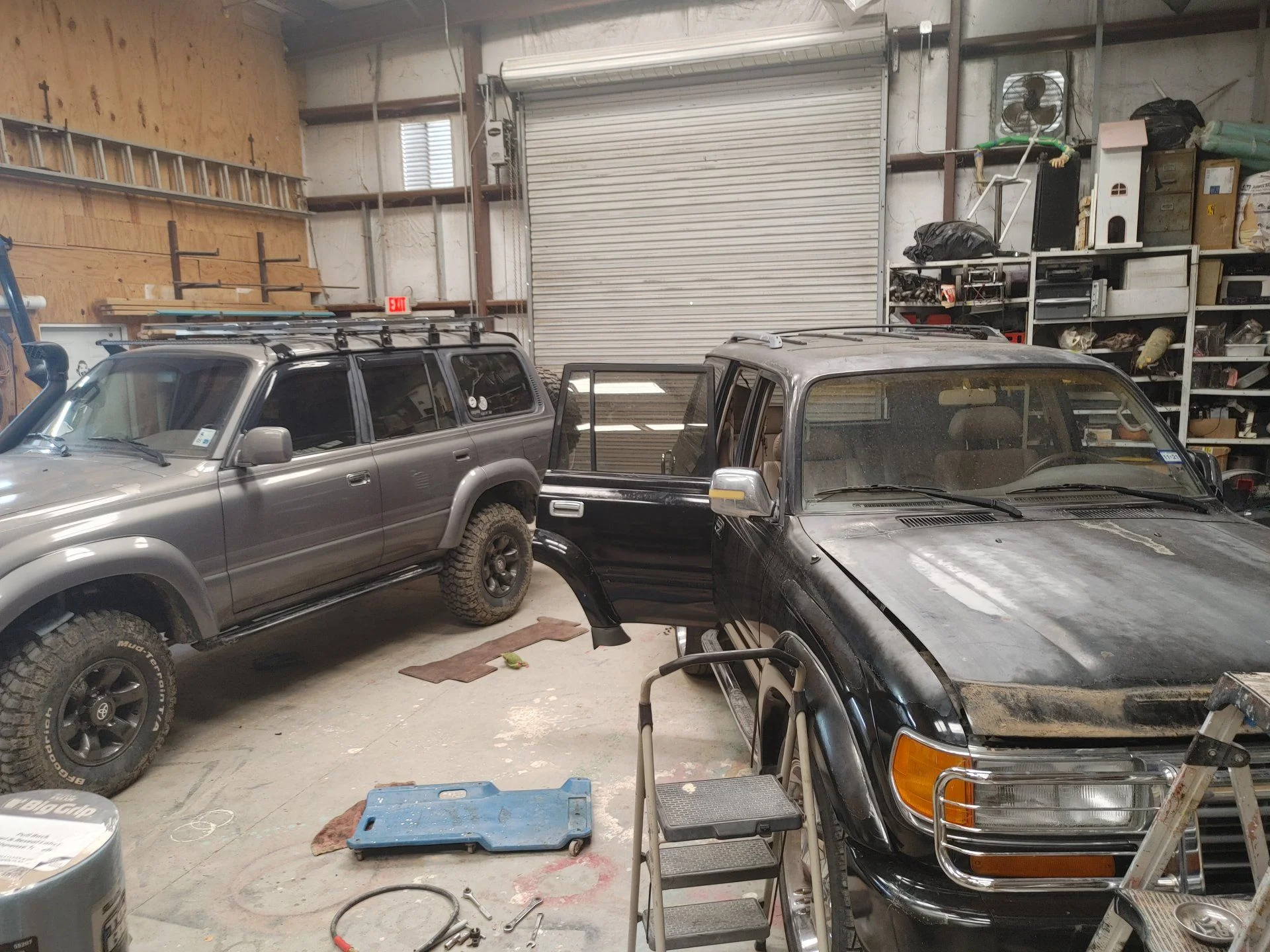

New Oil and Oil Filter. My cousin just purchased his 80 two weeks ago, so we both did it at the same time. What a royal pain in the a** it was for both of us, ended up welding a socket to the old filter.

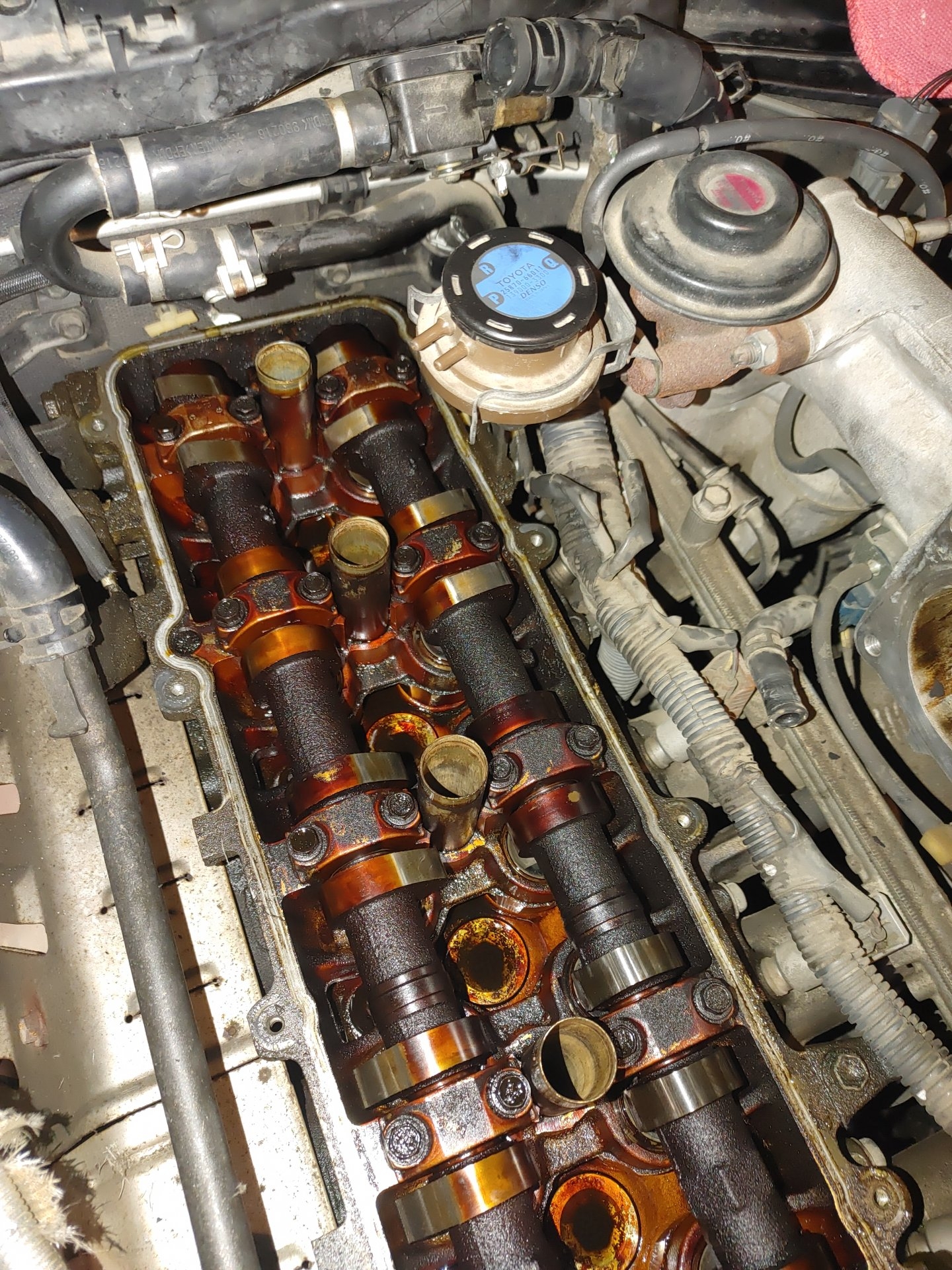

Also did a compression test and seafoamed the oil and gas. Passed the compression test for now..

Wits End - Valve Kit : $60
Wits End - Cover Leak Kit : $100
