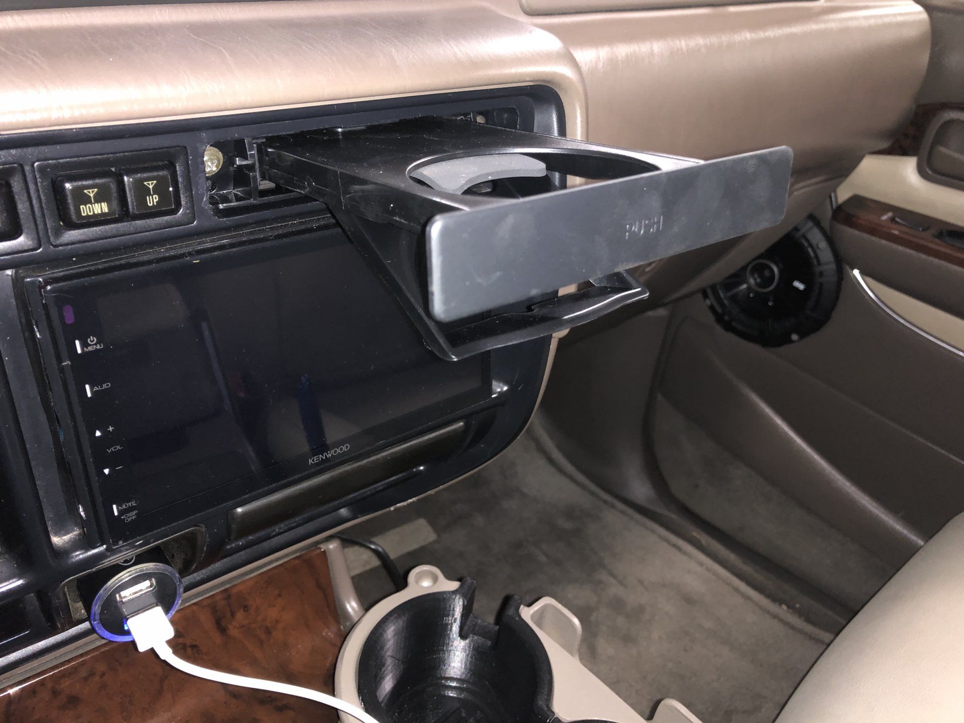

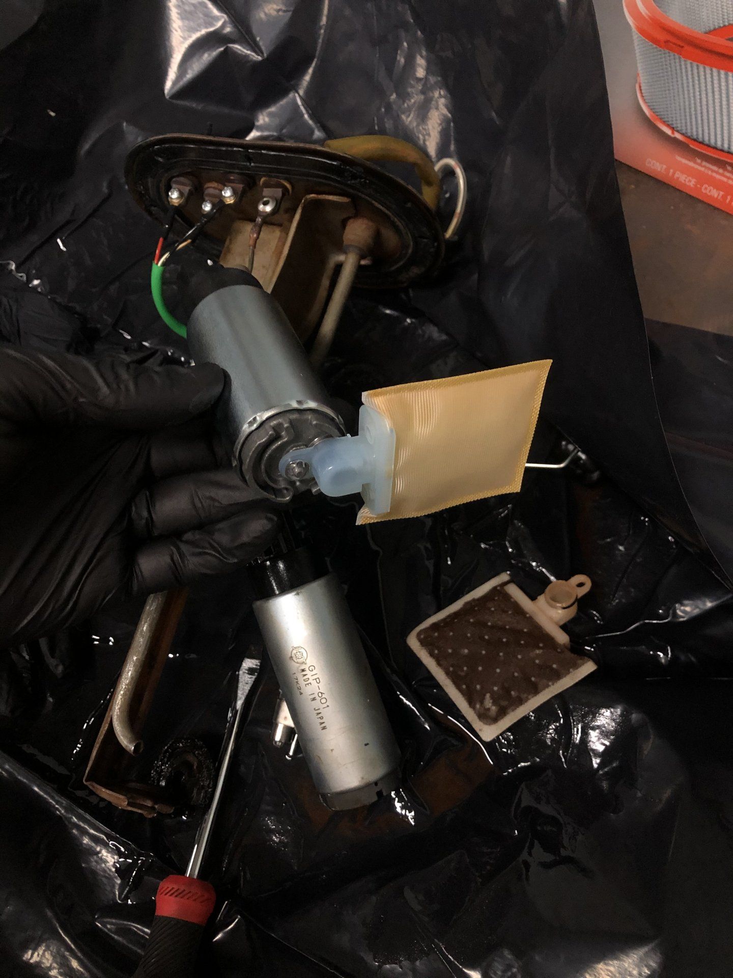

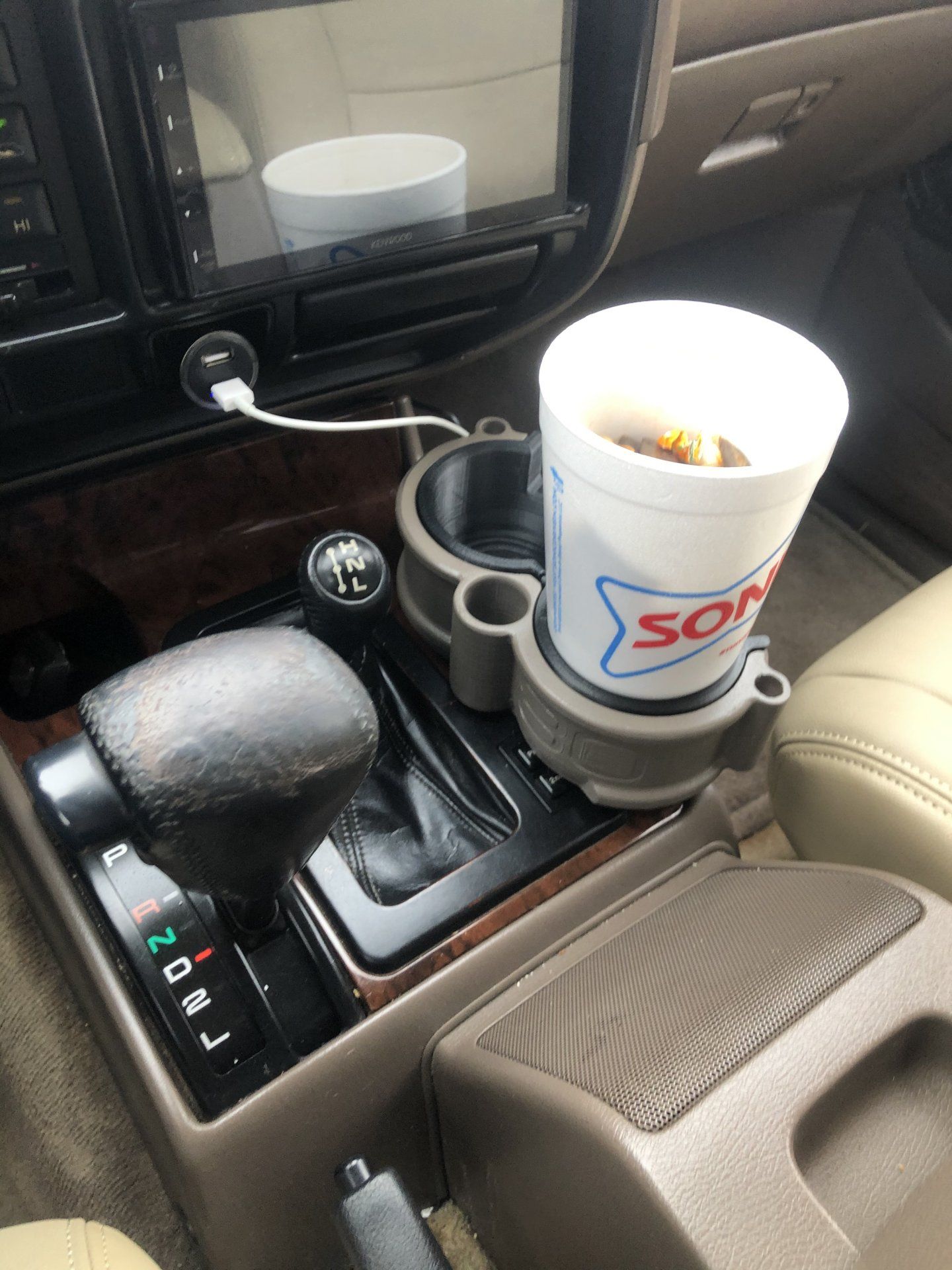

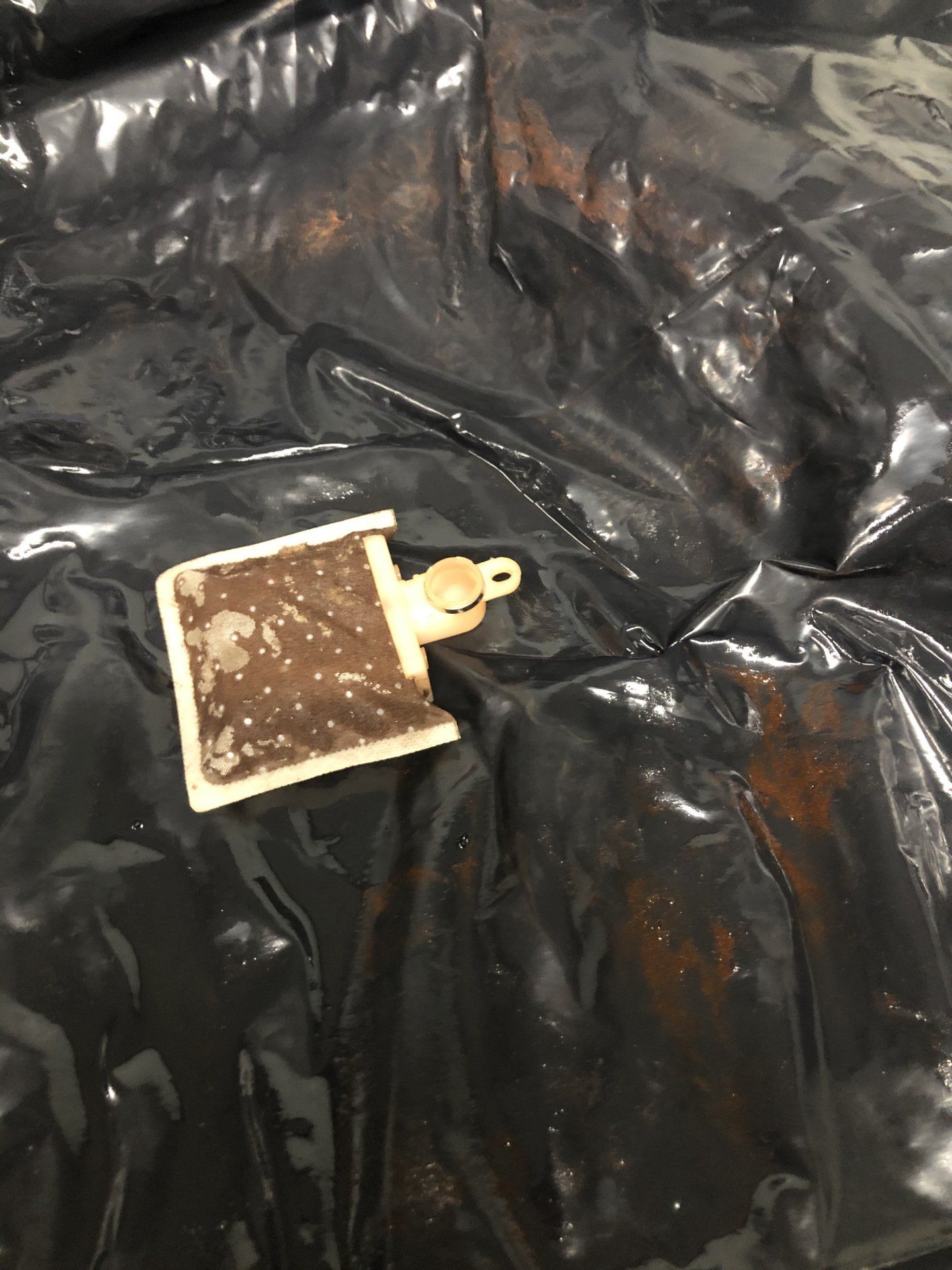

My first order of business was to go through the fuel system. I replaced the fuel pump, pump screen and fuel filter. Fuel filter was a lot more difficult than expected but got it done. I also replaced the spark plugs, plug wires, distributor cap and rotor. This did help it run better, but had no effect on the hard start. I bought two fusible links, installed one and have the other as a backup in the glovebox. Added new hood struts, no other reason than the hood kept closing and needed to work under it. Added a dual cup holder, one alone doesn’t work for a dipper, not to mention if the passenger has a drink.

On another note, after changing the fusible link, fuel pump, in pump screen and fuel filter, the rig fires right up with no more hard start.
