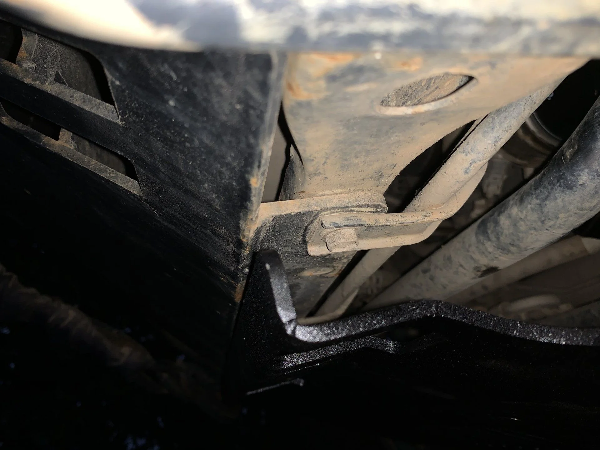

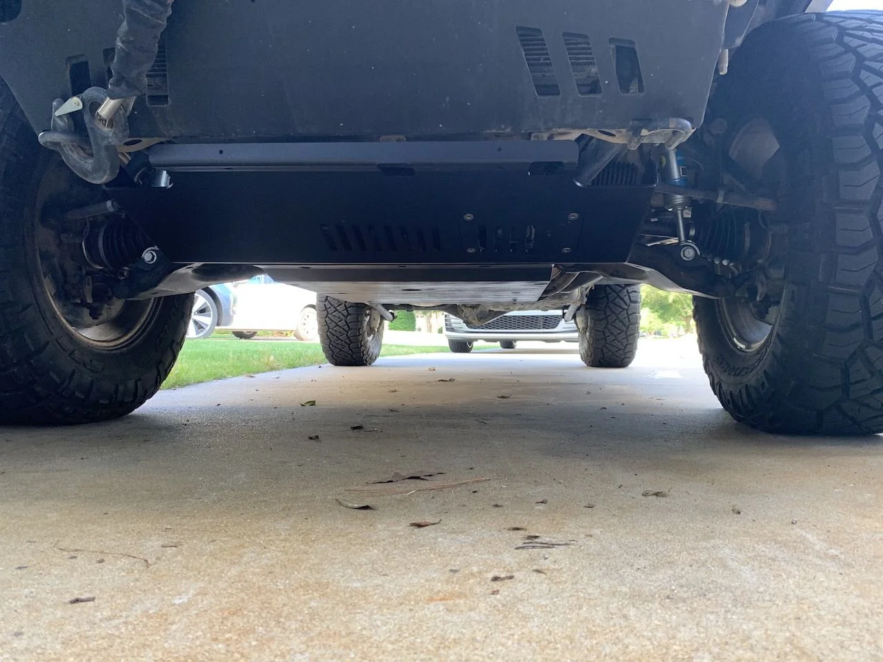

I got my Budbuilt skids painted and installed today. They were very easy to install with the use of a floor jack. Everything fit very well except for the front skid. This isn't Bud's fault however because my Coastal Offroad bumper attaches the radiator support and the skid is designed to wrap around the front of the rad support. It might be as easy as shave the vertical edge off of the skid so they all meet at the radiator support but I want to contact them to see what they suggest.
Has anyone else had a conflict between their bumper and skid plates?
Nevermind. I see what you are talking about now that I am on a computer. Do you have a shot from underneath? Not familiar with the Coastal attachment points.
I think this shows where the conflict lies
Man that sucks. The thought of cutting anything off the budbuilts would make me cringe. I'd probably call coastal too and see how critical those lower mounting bolts are. Cutting off the vertical seems like it would work. My SSO doesnt attach down there, so I did not have this problem.
