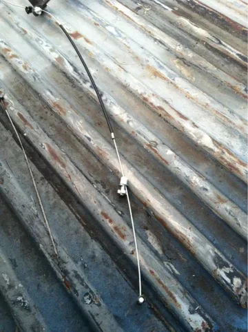

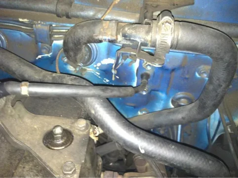

Any how. I basically made a new one. Keep in mind the little circle end piece that pulls the throttle linkage is smaller on a bicycle brake cable than it is on the throttle cable. So you will have to look at the end of your throttle cable and and you should see a circular plastic piece that goes around the end piece you're gonna need that. Along with the rubber housing that your old throttle cable ran through it connects to the firewall. Pics below. You will need to remove the old throttle cable from that housing and clean out any debris inside.
After cleaning it out you can simple run your line just like te old throttle cable. But will need I find a way to secure the End that attaches To the pedal so you can push the pedal and it pulls the throttle linkage.
New throttle cable with bicycle housing. Housing was too thin and did not work. Use the original housing in below pic to save yourself time.

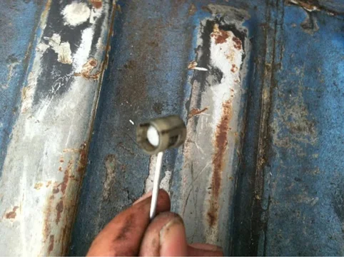

Here's the plastic clip I took off the orginal throttle cable at the end that connects to the throttle linkage

This is the stock throttle cable housing I was talking about. This is the one you will need to rip your old frayed and broken line out. Clean it out and thread your new line through it.
