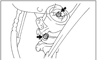

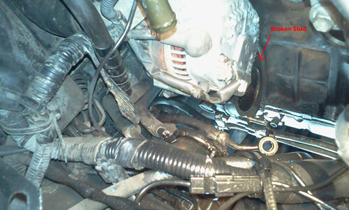

I broke a power steering pump stud on my LX 450. I over torqued the stud and broke the end of the bolt off. Unfortunately, I couldn’t easily find information about it so here’s information on how to replace.

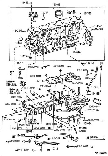

Toyota #: 90901-26001
Removing the stud can be tricky. I was lucky and I could back the stud out with two nuts bolted to the remaining threads.
Use an E-10 Torx socket to screw in the new stud.
