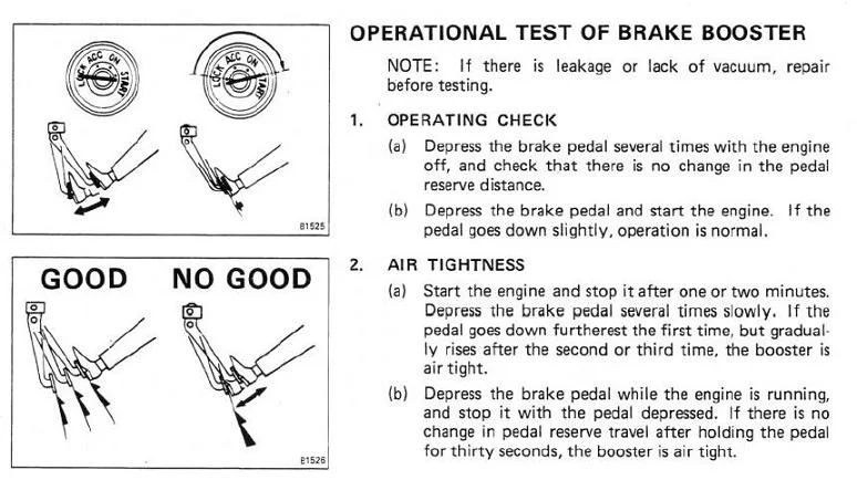

I think my brake booster is bad. But after checking the price on a new one I want to be absolutely sure that its really the booster and not something else. Brake boosters for these vehicles are not cheap by any means from what I have found.
At times the pedal goes all the way to the floor with little or no resistance. I've noticed when I really stomp on it I'll get good pedal. Pumping it a few times seems to help,but does not seem as effective as just really stomping on it hard. It also idles low after it sits, then you go and drive around for a few minutes and it will idle back up to where its suppose to be. Even when she is up to operating temperature and I shut it off then restart it after just a few minutes it idles way to low. Does anybody have any idea on anything else it could possibly be besides the booster? thanks.
