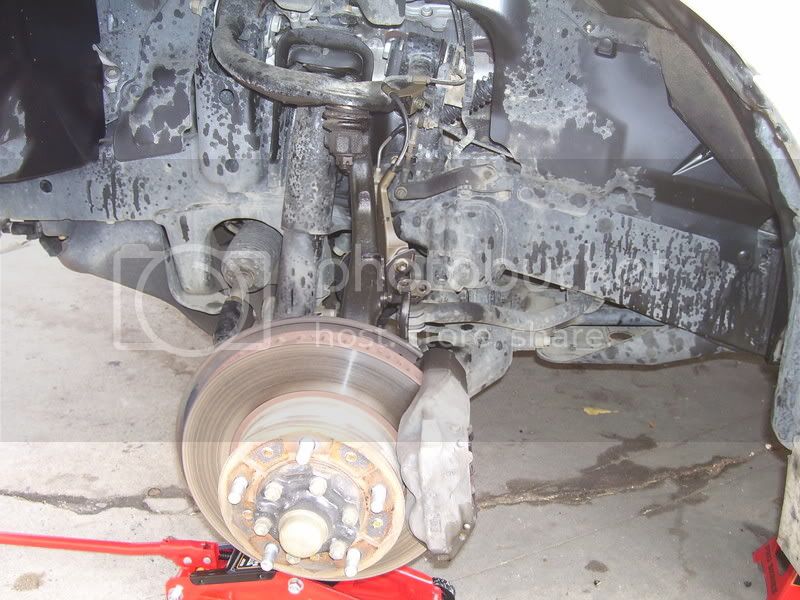

Wheel off...
First thing this morning, took off the wheel to see what I'm really dealing with.
Here's what I saw:
Getting a replacement hose from Pepboys this afternoon - Stoptech's are just expensive for me right now.
So, anyone have some pointers to installing a brake hose?
Also, what solvent should I use to remove the brake fluid splatters? I already ran my tire under the hose for about 20min...

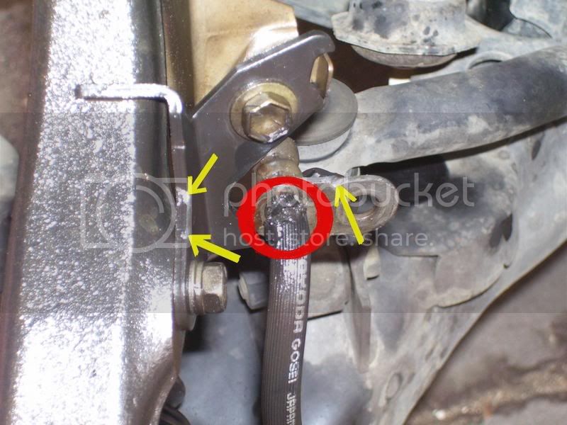

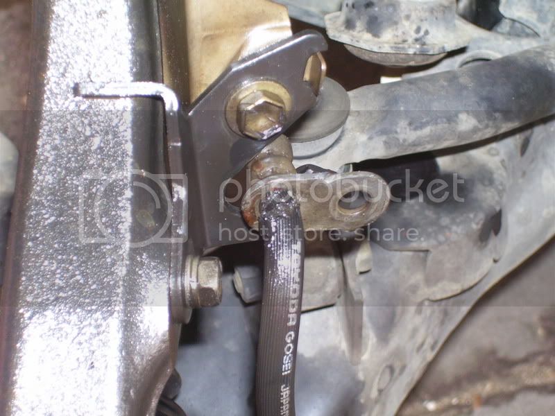

Here I've highlighted the places that were damaged by the improperly seated weight - the hose took the brunt of the impacts due to the LACK of a bolt through the retaining clip around the hose itself:
My opinion; definitely not caused by a weight spinning off; it would be flung outward, unless it bounced a few times and then hit the hose directly, and then if it did, it would not cause that type of failure/damage. IMHO.
My guess is that Darrell and his cousin Darrell who worked on your brakes last just dropped the caliper, which tugged on the hose as it came to a screaching halt just dangling in the air; very very common. The average mechanic just drops the caliper instead of hanging it up as described in the FSM to avoid just this type of damage. Unless you have recently driven over a downed oak tree or hit some large piece of metal in the road (and that would be a stretch); it was done by the last mechanic who took the calipers off.
When was the last time you had any service done on your brakes?? I would for sure take the hose back to that guy and ask for something in return. Bring the photos also.

definitely not caused by a weight spinning off...
Umm... It was me, almost exactly a year ago. And I was very careful to rest the caliper without straining the hose. Before then (1.5yrs previous) it had always been taken to the dealer. There was no bolt through the retaining clip on the hose when I serviced them last year, so that can be attributed to the dealer, unless it just rattled and shook out.
In any case, maybe the picture doesn't show it very well, but in my second pic posting above, the yellow arrows point to bare metal on two different components, also there is definite evidence of laceration to the hose itself, which would not follow with a strained hose theory.
I agree it was not done by a weight spinning off - It was from a weight being tight, but improperly seated. I saw it when I got my tire replaced a couple weeks ago, hanging at about 45degrees out from the wheel, and the tire tech still needed the pliers to get it off.

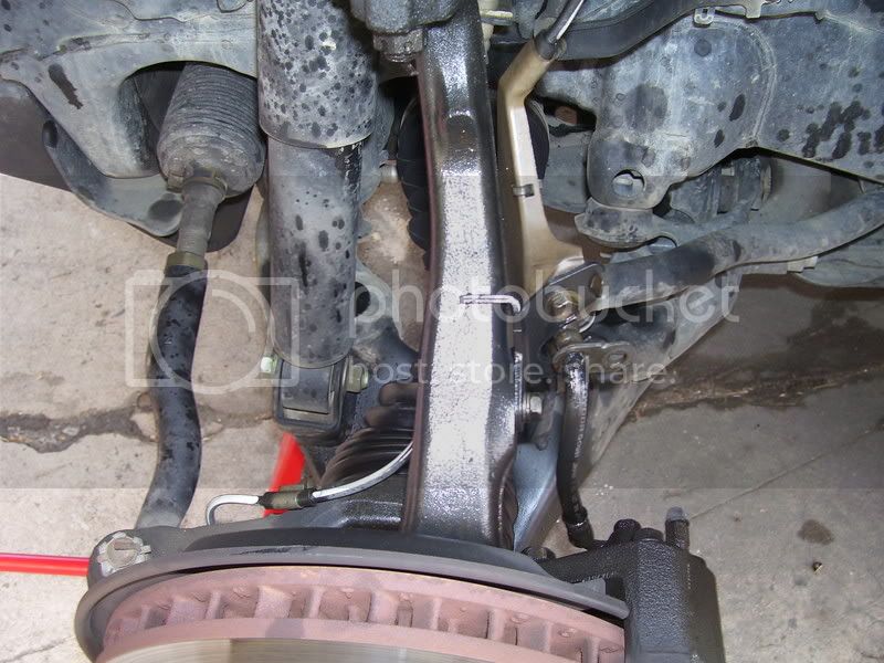

I'm doing this on a tight a budget as possible - The upper hose fitting is the real PITA, but a 10mm crescent wrench holds it perfectly - just had to remove part of the AHC sensor position arm to get the leverage on it properly. However I do see the logic in having flared or tube wrenches, and will acquire them in the future.
When I get the replacement in about an hour, I also want to pick up some tubing to facilitate bleeding the lines. Anyone happen to know the tube diameter that's needed?
Got the new hose, installed, bled all four calipers, filled reservoir to max line, wheel back on and just got back from a road test.

I now see the dings in the metal; but can't see how a lead weight would gouge steel like that??
I agree; looks like something hit it, but hit it really hard from above, and if you look closely, the dings appear to be going in different angles; like ?multiple strikes or struck once by a something with multiple edges; a head scratcher; a loose tool, rotor, or caliper??? Or, was it damaged somehow because it was not properly secured in the retaining clip?
I'm pretty sure it was the clip itself, not the lead weight - I can't see lead doing that to steel either.
Multiple strikes: I wasn't clear on this in this thread - I had a once-per-revolution click from my Fr L wheel anywhere between 1/4 and Full lock Left turn. Lived with it for almost 5months (I know, unthinkable) as I thought it was a CV joint going bad, and I just didn't have the money to fix it. I finally had the money to get a new CV, but almost immediately got a flat on the same wheel - got a new tire, and magically, the clicking stopped!
I had noticed the position of the weight when they took the tire off, but had so much on my mind at the time, I didn't put 2 and 2 together until a few days later.
The hose failed while at a stoplight, foot resting on pedal. Nice firm brake feel, then suddenly the pedal slowly sinks to the floor. The punished hose just finally gave up - glad it happened A: on the street vs freeway (or worse, on a trail miles from anywhere) and B: close enough to home I was able to coast/use the hand brake to get it where I could work on it.
