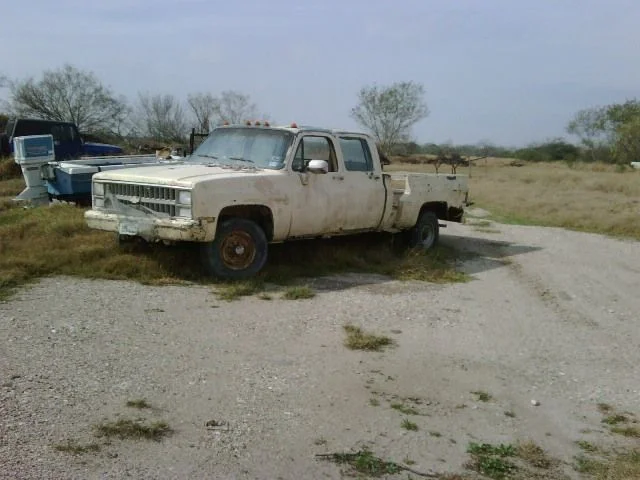

A few weeks back I had the pleasure to become the owner of an old(80 ish) hunting crew cab chevy one ton truck.
This here jewel was for the total price of $450.00...
And yes, this included all 4 flat tires, god knows what kind of poop it had in there and not to mention the bad smell. the smell was terrible. it seem like some animal was living in there and pee all over the inside.
anyways, she's mine.
..Back in November, Thanks Giving to be exact, I saw the truck on Riviera, TX. about 1.5 hrs. north of Brownsville. I saw it at a small tire place. I saw the ph# and called.
The guy that I spoke with wanted $4000.00 for the whole truck and including all 4 flat tires folks!
I had to pass on this wonderful sale!
It was way off my budget, besides my wife was there, and she just said "NO"

It's got the front dana 60 missing on my 40 :clap:
... not to mention a 350 V8, turbo 350 or 400(who knows) and a mighty np205
(I already got one on the 40).:grinpimp:
hard to believe but the engine works, we pour a few cans of carb cleaner and she started and stood on her own for a while.
..like I mentioned before, the D60 is going under my 40 but the million dollar question
do I need to reinforce the D60?
if I do which parts and brands are recommended?
is it OK to leave it stock?
I am running 37's for now, and the 14 bolt is digging like a mother f? .
I want to put some 39's or 40's later.
any help will be appreciated!

What kinda critter you reckon pissed all over it JP?? :confused:
Hell ... once you strip the axles out from under it you can park the damn thang in the front yard and sub-lease it out for housin' ...
Prob'ly get 4 or 5 Mes'kins to live in a big ol' crew cab like that. :grinpimp:
:flamingo:
Baw hahahahah!
You certainly have a bright mind sir! ...twisted, but you have one.
Never thought of subleasing it. There's an idea to recoup those $450.00
...as far as the critter, who knows?
there were a lot of gray-ish/ black feathers inside the cab, but that's the least of my worries.
I'll leave that problem to the future tenants. :grinpimp:
