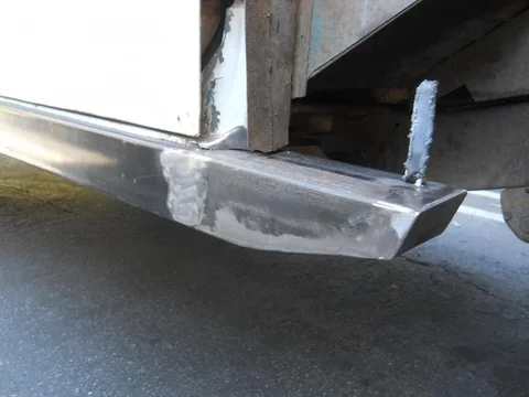

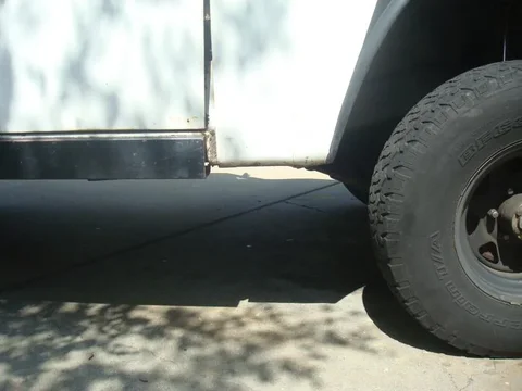

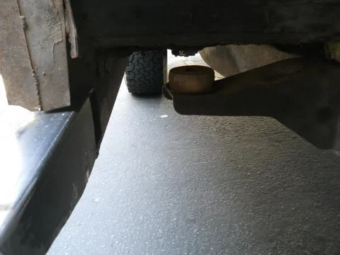

Finally got it done. Work always seems to get in the way. Got some pics. I used bushings from an fj60. Got some dimensions if your interested. Picked up some of the por 15. EXPENSIVE!!! I guess that everyone believes in it. I hope so.
Snapped pretty much all the bolts that hold the fender on. Ground off the t-nut type thing and gonna tack in new nuts, wire wheel the whole thing and then Por it.
Worried, if I get that por 15 in the threads will it ruin the nuts' thread, or do I need to protect them with some tape or something.:hhmm:
The mounts change my door problem completely. I had them adjusted all the way foward because of the droop in the A pillars. Now I have to pull them back to the neutral position, and put in my new door stricker. All my other doors are opening and closing so well now!!:bounce::popcorn::bounce2:

good work. I saw 1 1/8" of an inch thickness. Are they all the same thickness, or did you just do the ones at the front?
