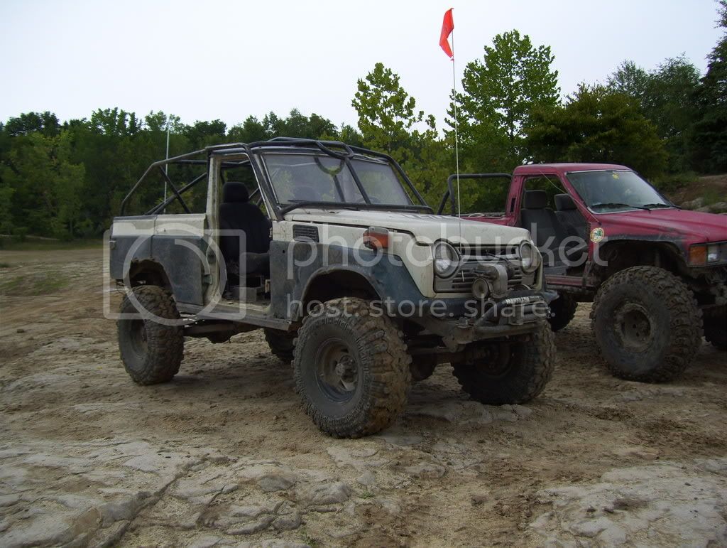

I am looking for pics of bobbed 55s for ideas. (yes I searched and only came up wth two pics).
Also-what do most people do for a gas tank when the 55 is bobbed ?
Thanks
I'd try to make the stock tank work due to the shallowness. I used a tank from a 90's Chebby S-10. The tank is a 20 gal. & hangs *too deep if you were to place it between the frame rails as is. The overall width & depth is a perfect fit though. The filler tube is on the wrong side as well. I cut the frame (where the upward curve stops at the front of the rear wheelwell), flipped, braced & rewelded it for a better departure angle. I cut & rebraced the rear crossmember, relocated a filler tube, & built a skid cage. The tank sits about 2" below the floorboard. It was a good bit of work but the *best option I thought for gaining ground clearance & packaging the tank in there.

there's also the blue and white bobbed one with the exo cage....don't remember who built it, but there are tons of pics posted here
That's Gumby, our resident cranky Mod
