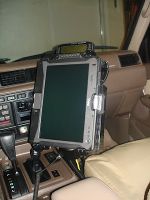

Latitude XT2 XFR Tablet PC
Before you ask...I didn't pay 3K for the tablet...the unit is substantially less if you purchase it refurbished on dell outlet. That said I can't tell it is a referb unit. I have multiple applications for it, server in my Juniper lab, so it made sense for me. The GPS is not installed yet but I have the cables to do it.
If you are looking for a tablet I saw this unit and like it...2Go PC - Computer Technology Link
Kenwood RC-D710 This unit was already installed, just not mounted. I'm hoping to see more of you on APRS soon.

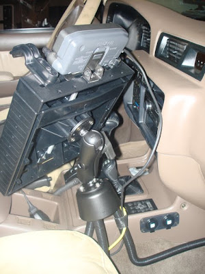

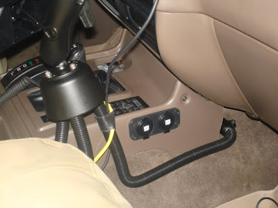

RAM Mount POD III W/ DBL BALL This was easy to install. I took coat hangers and bent them in the shape I wanted then bent the aluminum rods using the coat hangers as templates.

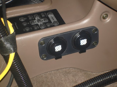

Power outlets can be had at West Marine
