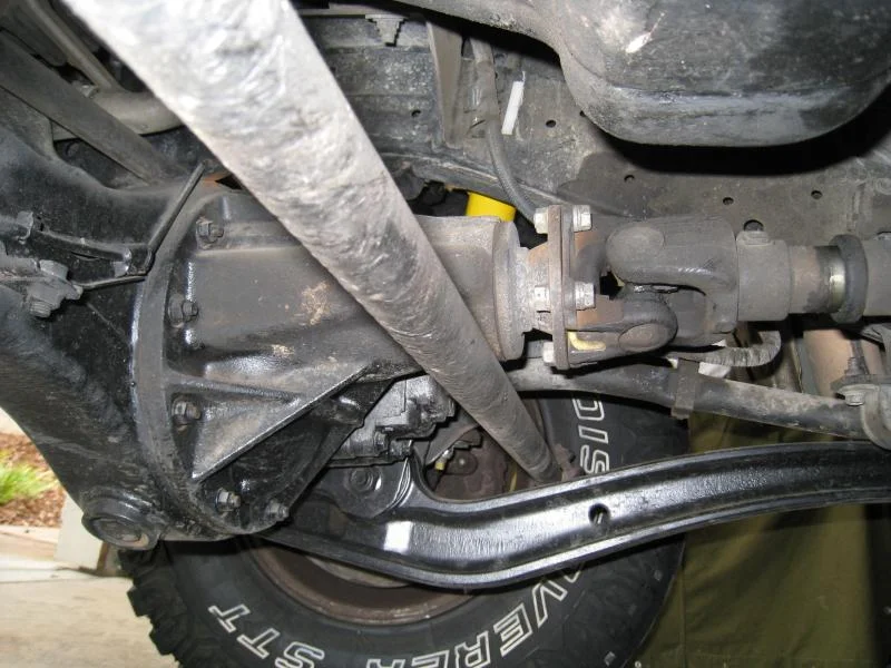

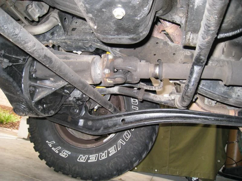

Would you mind taking picture of your front pinion angle with those blue bushings? Is your pinion pointing at the t-case?

Noel, here's some pic's of the front pinion angle with blue bushings, stock bumper, no accesories...OME 850's (heavy's) ...the pinion is pointing up a little. I hope this helps.
Scott
Scott
Thanks Scott. The angle on that pinion is not too bad. Seems like the blue bushing is the way to go. Your undercarriage is in great shape too, no rust and looking like new:D Nice pictures and nice tires.
