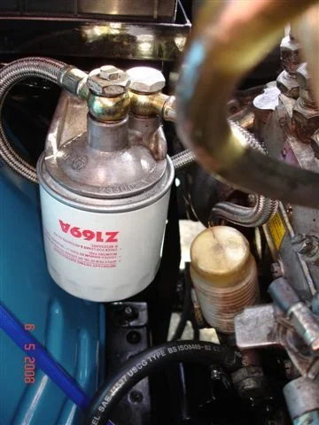

Hi all, I've been on the hunt to replace the bolt and screw assembly on the top of my stock fuel filter - the bleeding valve no longer locks properly and constantly leaks. I've tried Toyota Australia for a new part, unfortunately they have none in the country.
Does a later model - say a 2H have a similar bleeding screw assembly? Or is there something else I can do?

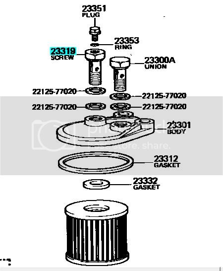

I know what you mean, but mines not like that on the 1979 B engine -
Here's the spec page from a Toyota manual I got off a helpful shop in Melbourne-

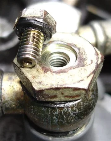

Here's a pic that I took this morning, note the bolt I jammed in the top of the main bolt to stop diesel pissing out everywhere to get home-

Something tells me a brake bleeder screw would still work perfectly in that hole. A pack of assorted sizes should be a couple bucks at an Autoparts store, worth a try.
Definately worth a try, I've got a spare cylinder at home. I'll pull it off and jam it in there. Will let you know how it turns out :cheers:
I believe our BJ40-style bleeder is quite different from those used on BJ42 models. It seals at the "head" (by means of a washer under the head) instead of sealing at the base (like a brake bleeder does).
I can't see why yours can't be fixed DrSlug.
Surely just a new "bolt" (6mm metric fine or whatever) and/or a new washer and it would be as good as new again.
(And if there are holes drilled in the bolt ... then that's easy enough to do too.)
:cheers:
PS. The bolt/screw in your pic looks way too long to me but that easy enough to fix. (And the sealing washer appears to be missing from under the head.)

Hey Tom, does the little bolt in the top have holes in it? I have no idea mine shot out on the road last weekend. Also was it a rubber o-ring around that little bolt or a normal washer? The Toyota dude reckons it was an o-ring, but I dont remember seeing that on there before it took off.
They're right. It is actually an O-ring I think. (But mine is flattened and has gone a bit hard so it looks more like a washer.)
And it does have an angled hole as I hope I have captured in this photo I took just now:
Oh. And it is actually an ordinary 6mm metric thread (and isn't a "fine" thread as I previously thought it could be).
:beer:
:beer:
