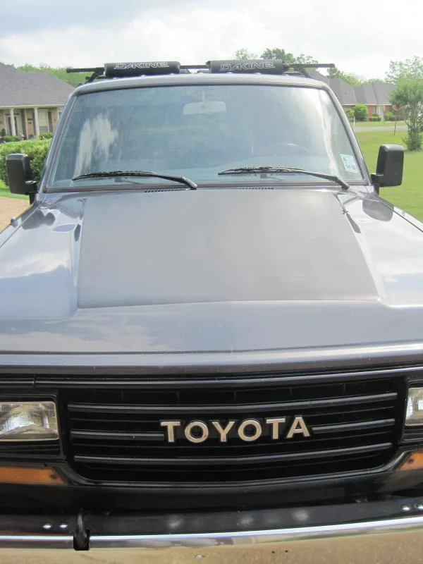

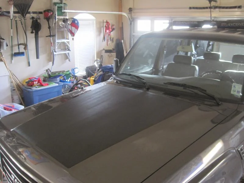

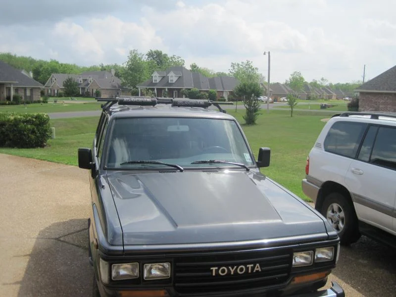

Had clear coat peeling from the hood so in the mean time until I either score a hood that is mint or win the lottery for a real paint job I blacked it out.
I taped it off and washed it soft scrub-
Then I hit real good with some 220 grit or some thing.
A few coats of Rustoleum Industrial satin black- rattle can
A can of matte clear coat-rattle can
Sanding between coats lightly
Then hitting it with 1000 grit to get some of the spray lines out.
All in all it looks 100 times better than what it did- In the future if I got it professionally painted, I would run it blacked out anyway cause it does look bad ass. Plus I don't miss the glare!
