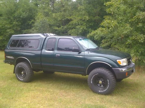

These are 33/1050-15s I got from DiscountTire online. They were at my doorstep in 3 days with 50 psi. You'll need a small spacer to clear the calipers. Also, the front lugs on early Tacomas are short, so order a set of '04 Matrix/Corolla rear lugs and change them out while you're at it.
