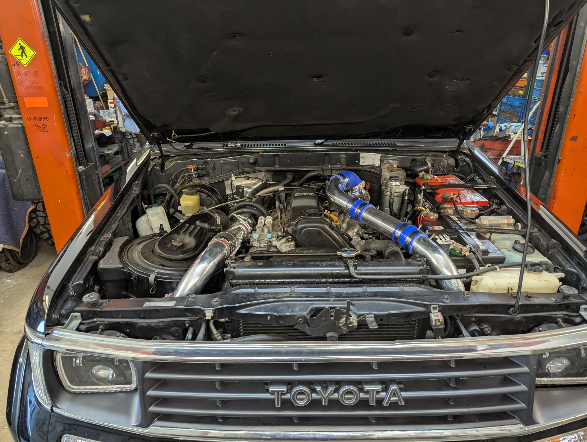

Yesterday installed a front mount air to air Garrett intercooler on the 1996 KZJ78. Routed the pipes through the old horn spaces and through the back. Bought a throttle adapter for the connection to the air manifold on the passenger side and it came out really clean. Pic attached.
Everything is hooked up and clamps are tight. I start her up and she has a really rough idle and black smoke coming out of the tailpipe. This never happened since i’ve owned her. I went back and tightnes clamps, and ran soapy water over pipes to detect if any leaks. Couldnt find any.

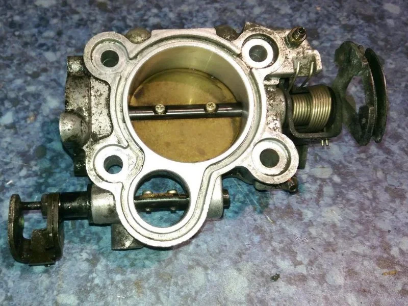

Next: there is a small butterfly that remains from when we deleted the EGR system. It has two small solenoids on it. We found it was rubbing on the new trundles adapter we installed. We adjusted it slightly and even used zip ties to mimic that being removed. When we ran the engine it still emitted black smoke.

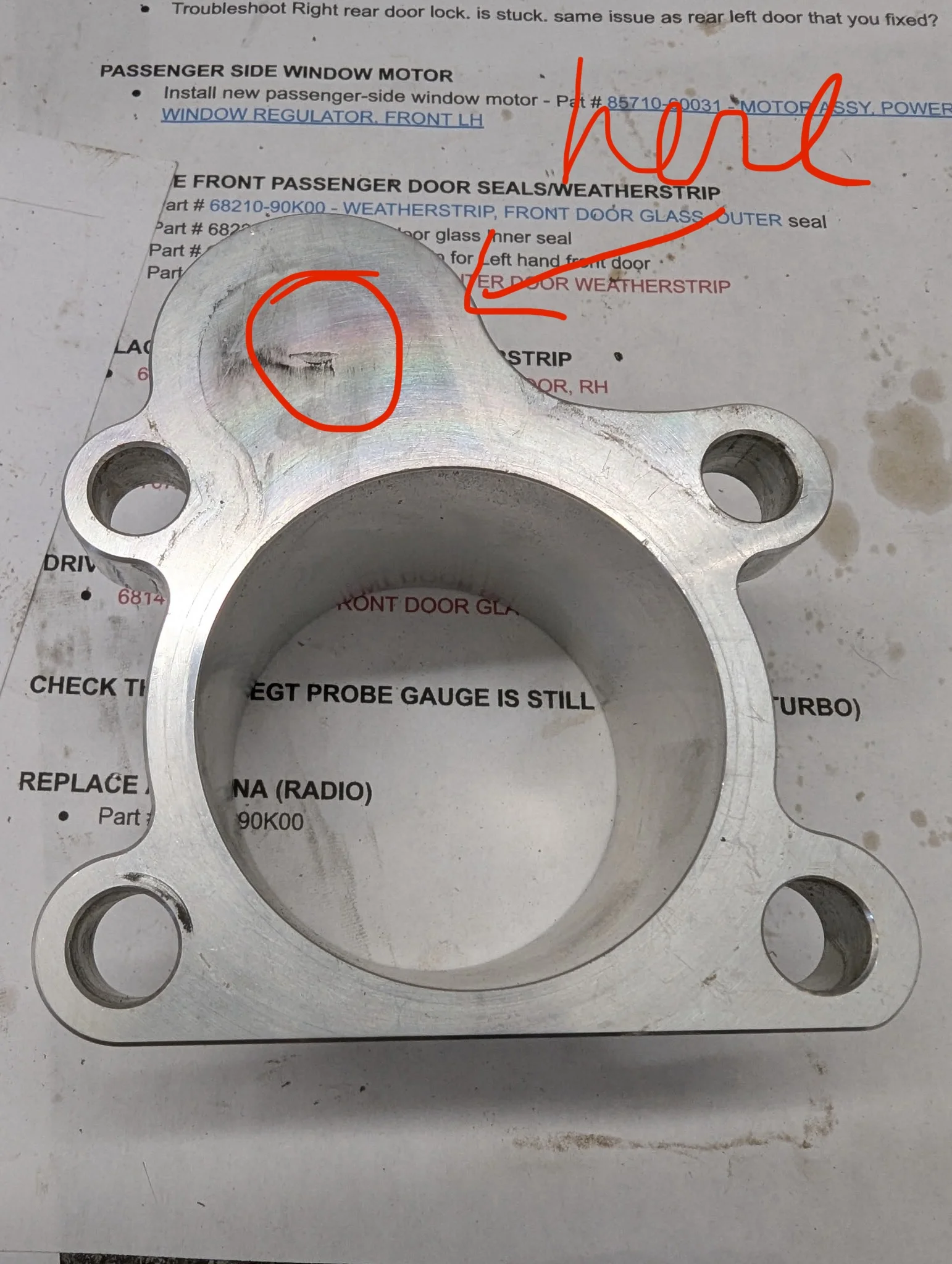

To your point, The only thing we are now thinking is the trundles adapter covers a small little hole at the throttle body/intake point. Perhaps the adapter we are using is the issue.

removing the little plate can be frustrating as you dont have a ton of room to work with in there while the throttle body is still on the truck. the valve rotates up (as shown in the photo below)
people have stuffed a clean rag in the intake underneath the plate to keep debris from falling into the intake. from there, you can get creative with removing the heads of the screws. dremel, file, chisel, tiny hacksaw, etc... once the heads are gone, the plate will come off easily. you can now rotate the crossbar by hand and use tiny vice grips to back out the rest of the screws.
Once the plate and screws are gone, you can leave everything else intact.

Thanks man. I think we are almost there. We removed the small butterfly and put back on the trundles plate. Still black smoke/soot! Even removed the intercooler and put a straight pipe in and still black smoke. Really didnt want to cut the crossover intake pipe in case we need for future. So, to be creative we drilled a half size hole in the blank plate section of the trundles adapter to mimic the stock crossover pipe and allow air to flow. Kept the small butterfly off. We fired her up and she hummed beautifully. Now we are going to enlarge the hole on the trundles adapter, keep the butterfly off entirely, and let her fly.

Glad you have found a solution. I am trying to understand this. I think it makes sense if you have NOT removed the large butterfly- with the large butterfly closed, and the flat portion of the Trundles adapter blocking air flow through the passage withe the small butterfly, the engine can't get enough air to run smoothly and goes rich, causing black smoke. If all this is correct, everything should work correctly with just the main butterfly removed, as there would be no restriction to airflow at any throttle position.
