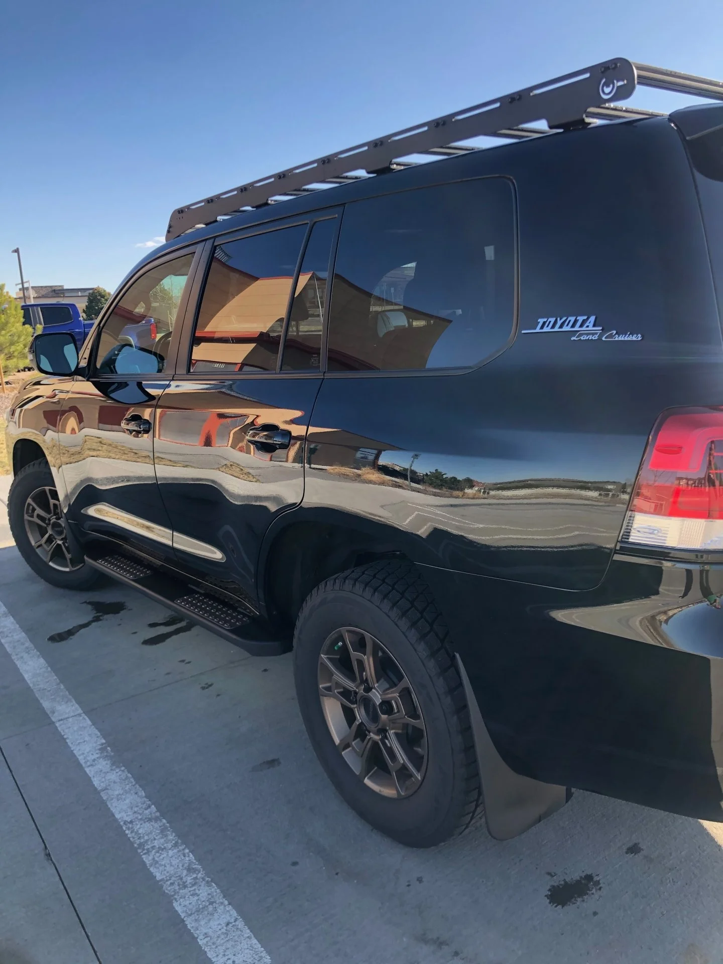

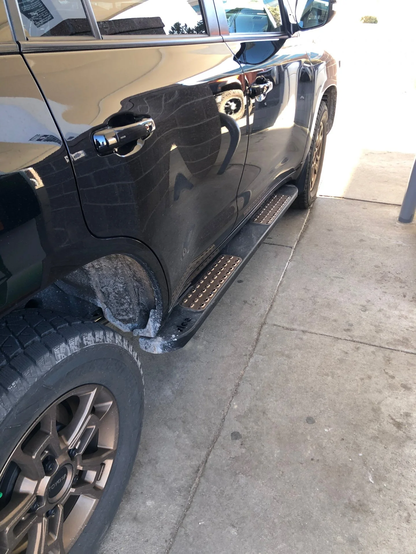

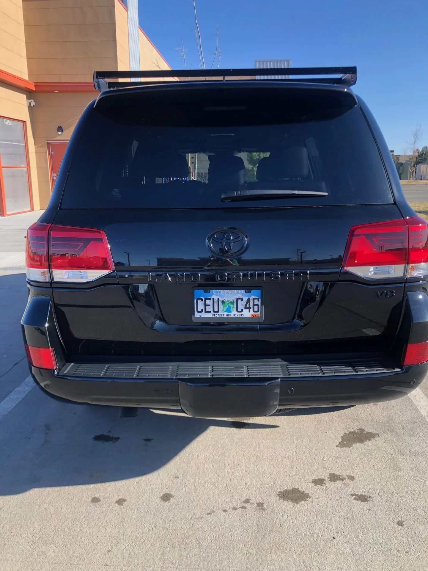

black in out and get a better roof rack and add rock sliders. I also had Eric Sarjeant powder coat the insets to the Slees in my 2020HE, Black out was rear badging, side window mouldings and mirrors.
