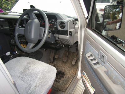

Does anybody have a source for the drivers side window switch? I can find the passenger side. If not can I just wire two of them and mount them in the place of the master switch?
I would like the whole switch if I can find one. The whole thing is cracked even the back. The switches kinda work if you wiggle them and press down hard. Then they stick. Maybe if I had the trim It might work. I guess I need to tear it apart.
Well I could not find the master switch. I ended up buying 2 passenger side switches from Switch Doctor. Part # 1022. They are $14.00 apiece. I guess I should buy a spare before they are extinct. The hardest part is figuring out the wiring. The switches are double pole.
The current model 7* series are using these arm rest type switch now, inline with Tundra, Corrolla and Camry etc. This is a 4dr switch, the 2 door is the same but with 2 less switches. Drivers 2 door master switch 84820-16060
This is the panel part number for a RH
74231-60030-B0 blue
74231-60030-E0 oak
I don't know if they could be grafted into an older model arm rest.
