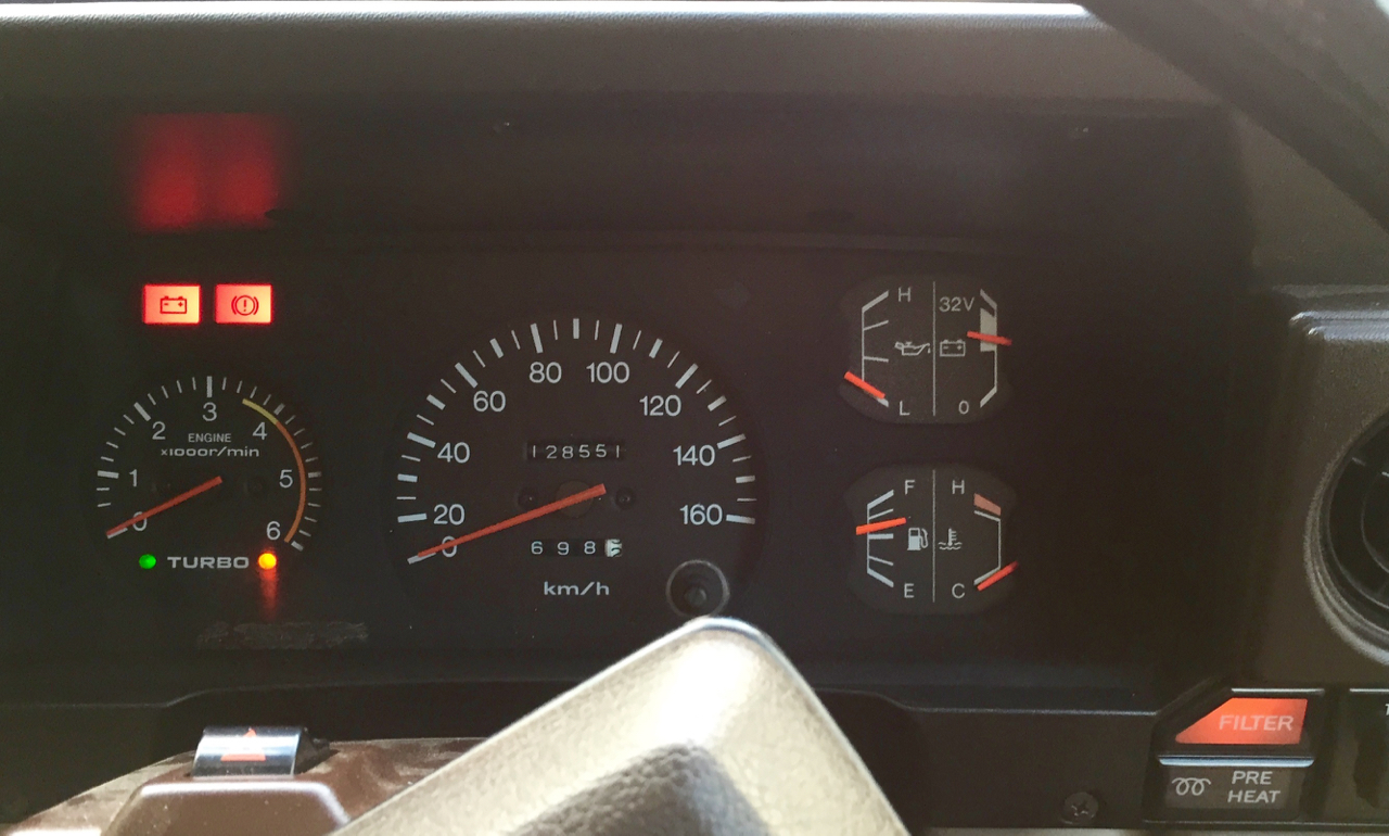

Not sure whether a BJ73 behaves the same, but here is a pic of the dash on my BJ74 with the key in the "on" position. The Preheat light has a bad bulb, but would otherwise be illuminated.
