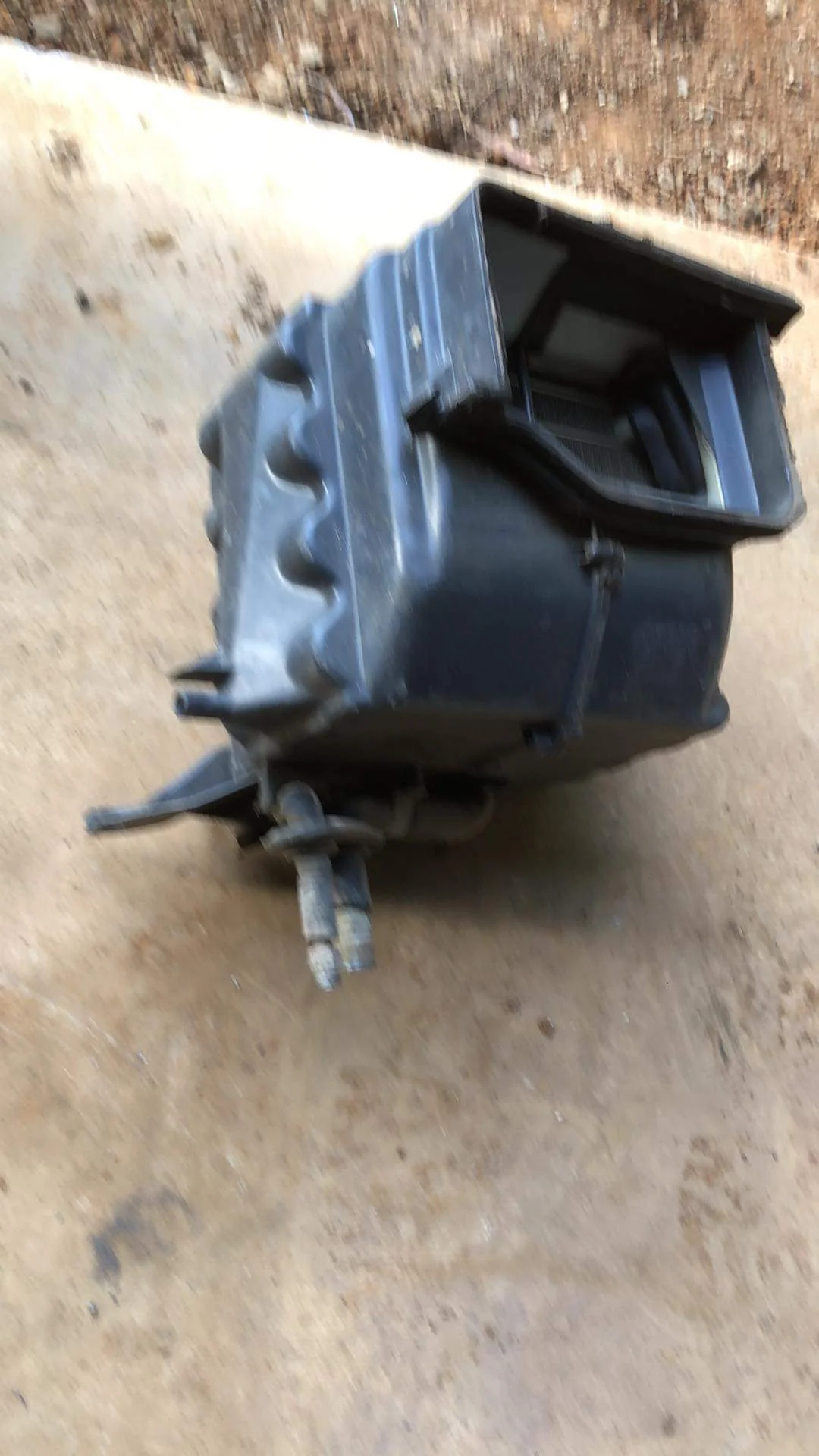

Hi guys so i am wanting to install ac in my 85 bj70 and i am starting off with the interior bits.
In regards to the condensor box is it as simple as it just installing to the existing heater box. I dont really underatand how it would attach to the existing heater/ fan box, if anyone has pictures or can explain that would be great.
I was under the impression the fan system already in the car for a non ac system is no different to the ones with ac so the condensor box should work fine with it?
Check the last couple pages in my build thread
Just had a look.
Even thought its a aftermarket system it looks like same principal. Its abit hard to see in the photos but im guessing the factory fan/ heater box is the same but you remove the plastic pipe that goes to the vents from the fan box and the ac condenssor box goes inline?
