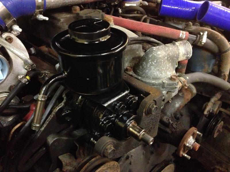

All cleaned up, painted and re-mounted. Just need to put the pulley back on.
Cleanest part of the engine now!!
