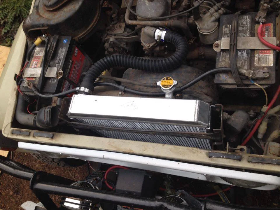

Hey guys sorry about the inactivity, been swamped with school for the past few months.
My radiator showed up in December and I got around to throwing it in near the end of January. Went in pretty easy and works great! Glad to have her back on the road, especially during that snowfall!

I did end up ordering one through ebay.ca, shipped free to a box in point roberts and picked up by a friend. I haven't installed yet (a ways to go before I get to the rad), I have to admit the tig welding and quality look really good, and well under $200cnd all in so far...there were some other forums that mentioned someone had problems with mounts when off-roading (that style had just tabs for mounts) but the one commonly available now has a full mounting piece down the sides like the original...I'll update when I get it installed...wanted to get new hoses but the bottom one is pretty hard to find in Canada...will also definitely use the expensive coolant...
