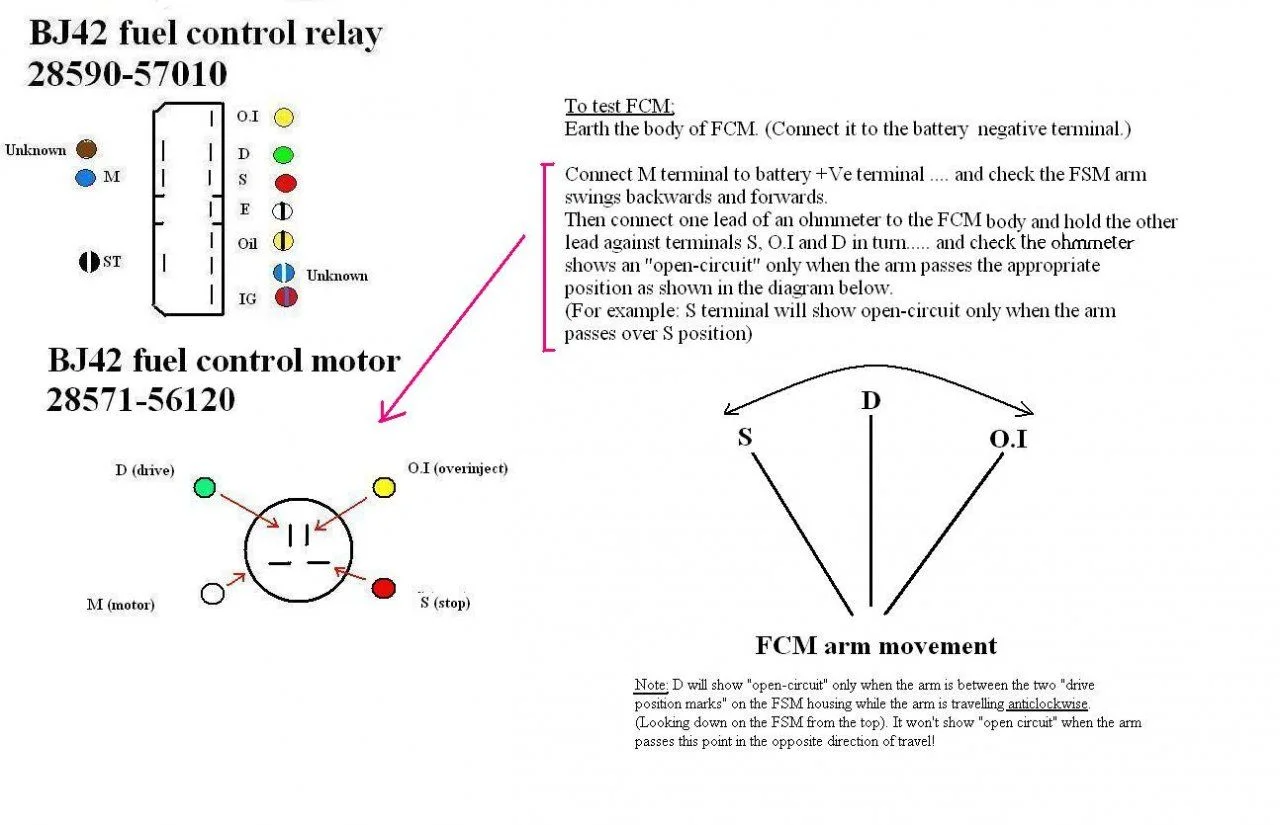

Is there a way to bench test the edic motor from 24 volt bj42? Any help would be appreciated?
Thx this procedure does work on 24volts edic motor. Thx for the helpHi Mike
Well this is the test I did on a 12V BJ42 EDIC motor so I expect you'll be able to do the same test on your 24V BJ42 motor using 24 volts instead of 12V:
