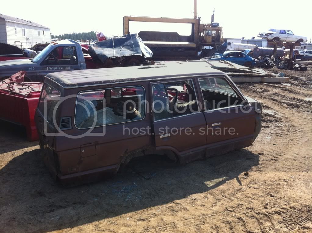

Donor truck: 83' BJ60
http://i1183.photobucket.com/albums/x467/GMillionS_esq/Scruiser/IMG_0804.jpg?t=1347939821
http://s1183.photobucket.com/albums/x467/GMillionS_esq/Scruiser/?action=view&current=IMG_0804.jpg
http://i1183.photobucket.com/albums/x467/GMillionS_esq/Scruiser/IMG_0829.jpg
An ominous future indeed...
http://i1183.photobucket.com/albums/x467/GMillionS_esq/Scruiser/IMG_0833.jpg

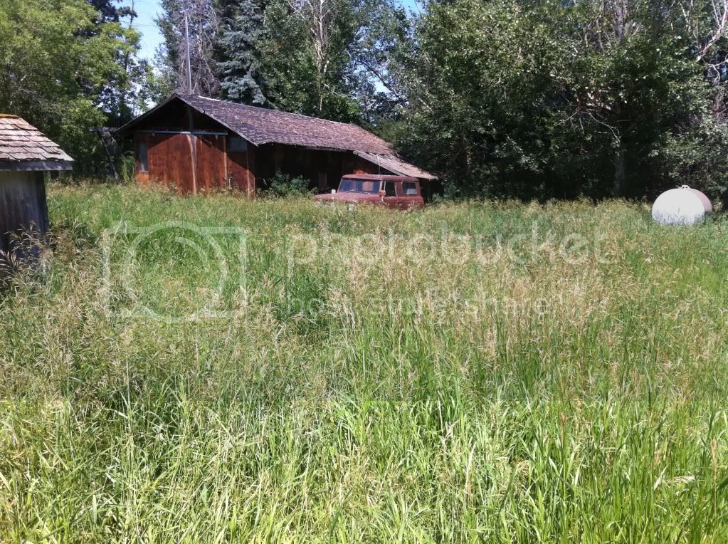

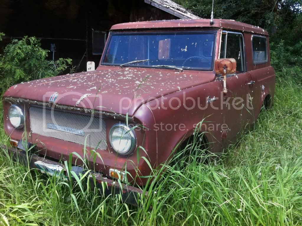

Donee truck: 66' IH Scout 800
i guess it'd be a barn find if was actually in a barn
http://i1183.photobucket.com/albums/x467/GMillionS_esq/Scruiser/IMG_0839.jpg
http://i1183.photobucket.com/albums/x467/GMillionS_esq/Scruiser/IMG_0796.jpg
http://i1183.photobucket.com/albums/x467/GMillionS_esq/Scruiser/IMG_0798.jpg

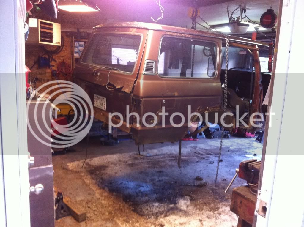

The beginnings of the unholy union:
http://i1183.photobucket.com/albums/x467/GMillionS_esq/Scruiser/IMG_1277.jpg
http://i1183.photobucket.com/albums/x467/GMillionS_esq/Scruiser/IMG_1290.jpg
http://i1183.photobucket.com/albums/x467/GMillionS_esq/Scruiser/IMG_1287.jpg

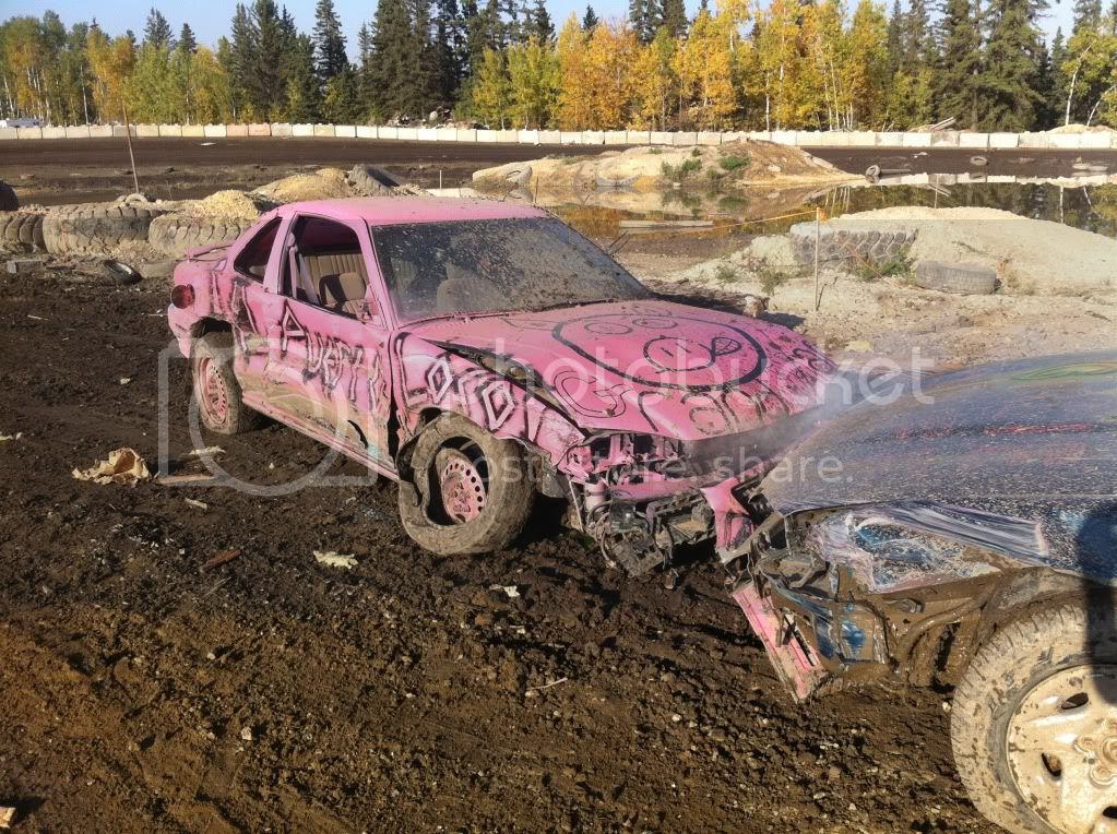

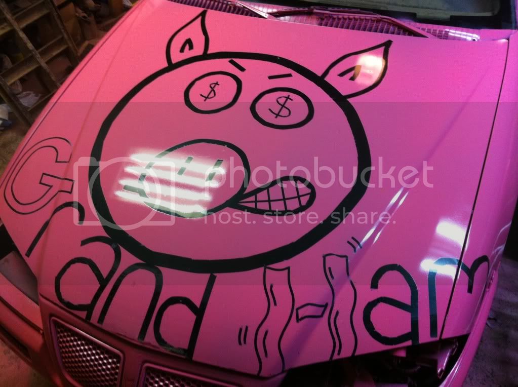

There was a first ever hillbilly camper race in town this weekend so my pal Carlos scored a $100 grand am for the event. It was quickly decided that it would be painted pink and emblazoned with "GRAND HAM" racing livery. @ 2 am.:
http://i1183.photobucket.com/albums/x467/GMillionS_esq/Scruiser/IMG_1304_zpsed769bdd.jpg
http://i1183.photobucket.com/albums/x467/GMillionS_esq/Scruiser/IMG_1313_zps759be739.jpg
http://i1183.photobucket.com/albums/x467/GMillionS_esq/Scruiser/IMG_1314_zpsd8aa5811.jpg
http://i1183.photobucket.com/albums/x467/GMillionS_esq/Scruiser/IMG_1330_zps4671c8b9.jpg

The Grand Ham (AKA "!El Peurco Loco!") placed 4th out of 6. Still ran but shredded both front tires... After the carnage:
http://i1183.photobucket.com/albums/x467/GMillionS_esq/Scruiser/IMG_1361_zps4e2633da.jpg

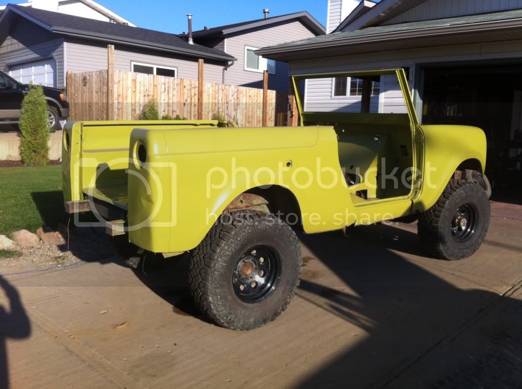

One more of the Scruiser:
http://i1183.photobucket.com/albums/x467/GMillionS_esq/Scruiser/IMG_1316_zps8fcb747c.jpg
Next on the Scruiser list is mounting the steering box and getting the 3B lit...

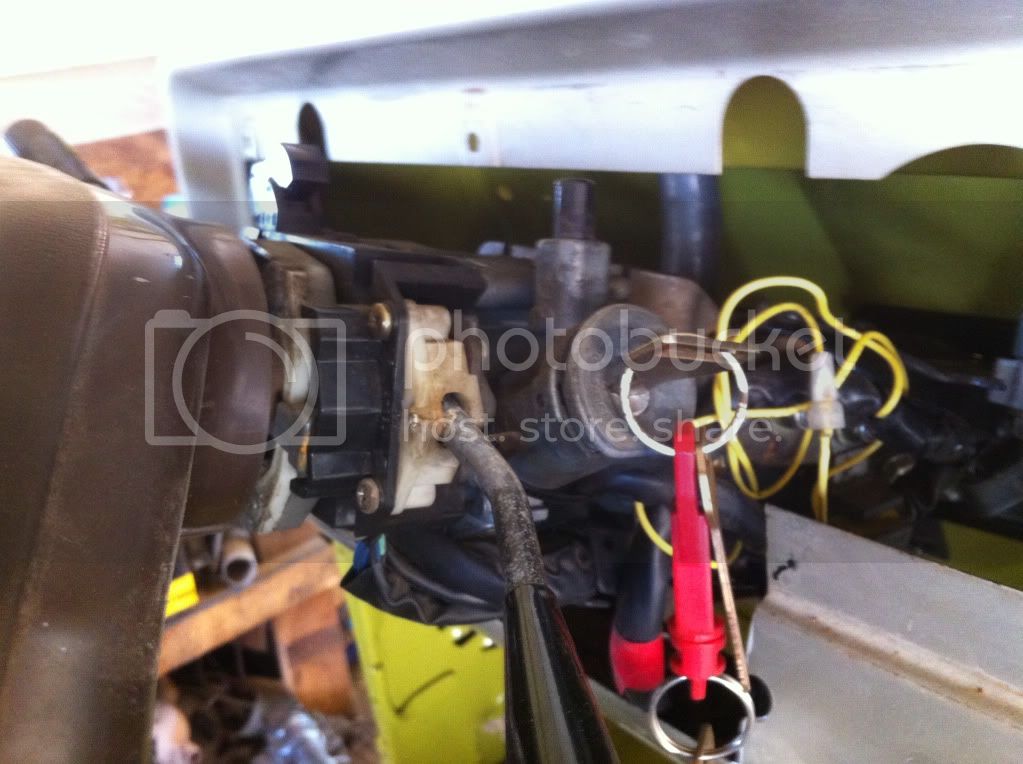

Got the toyota steering column shortened (significantly!) and mounted. Using this so i can have a tilt-wheel, modern control set-up (stock scout ignition tumbler is on the dash to the left of the steering wheel), and since it'll keep wiring very simple.
http://i1183.photobucket.com/albums/x467/GMillionS_esq/IMG_1375.jpg
