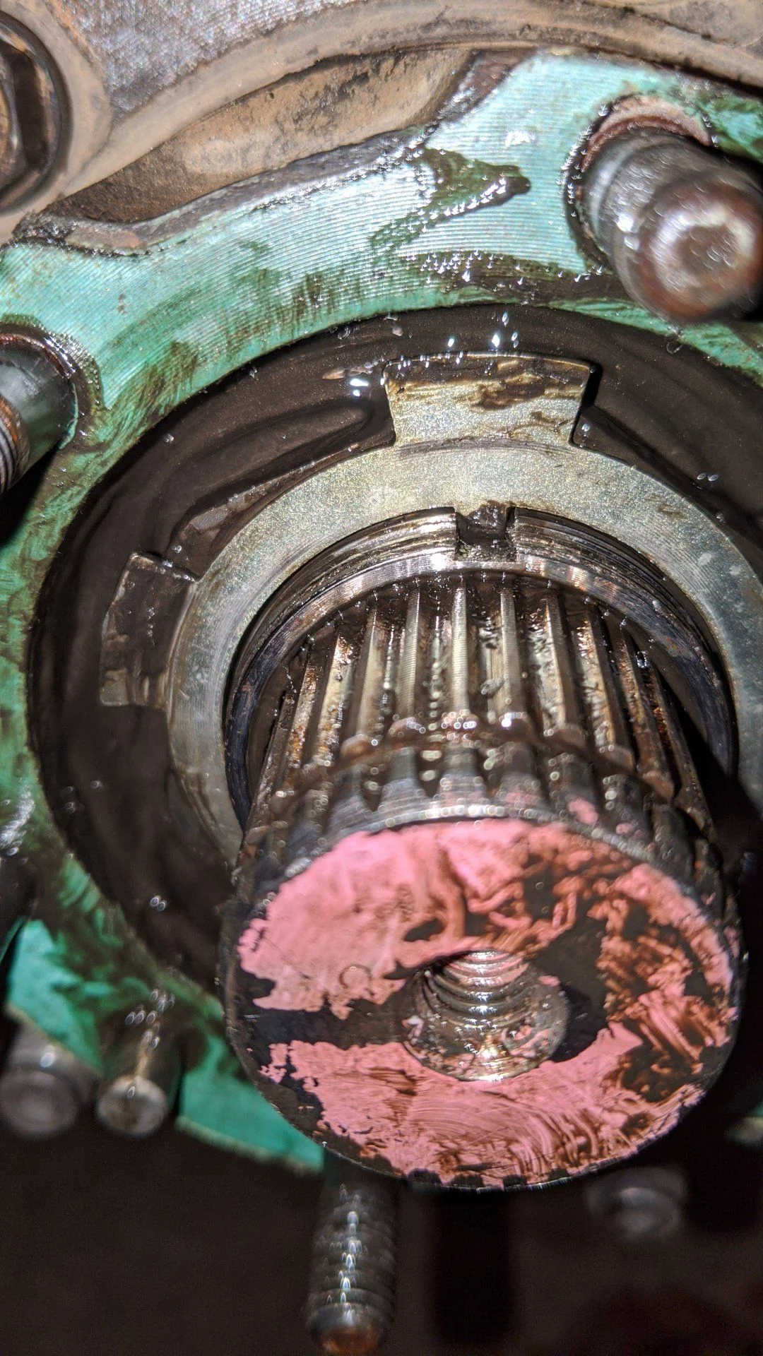

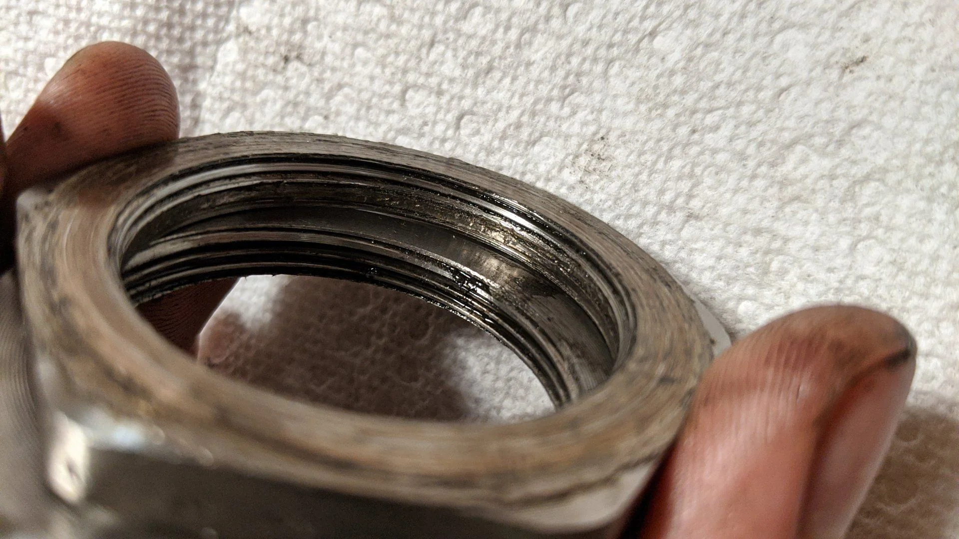

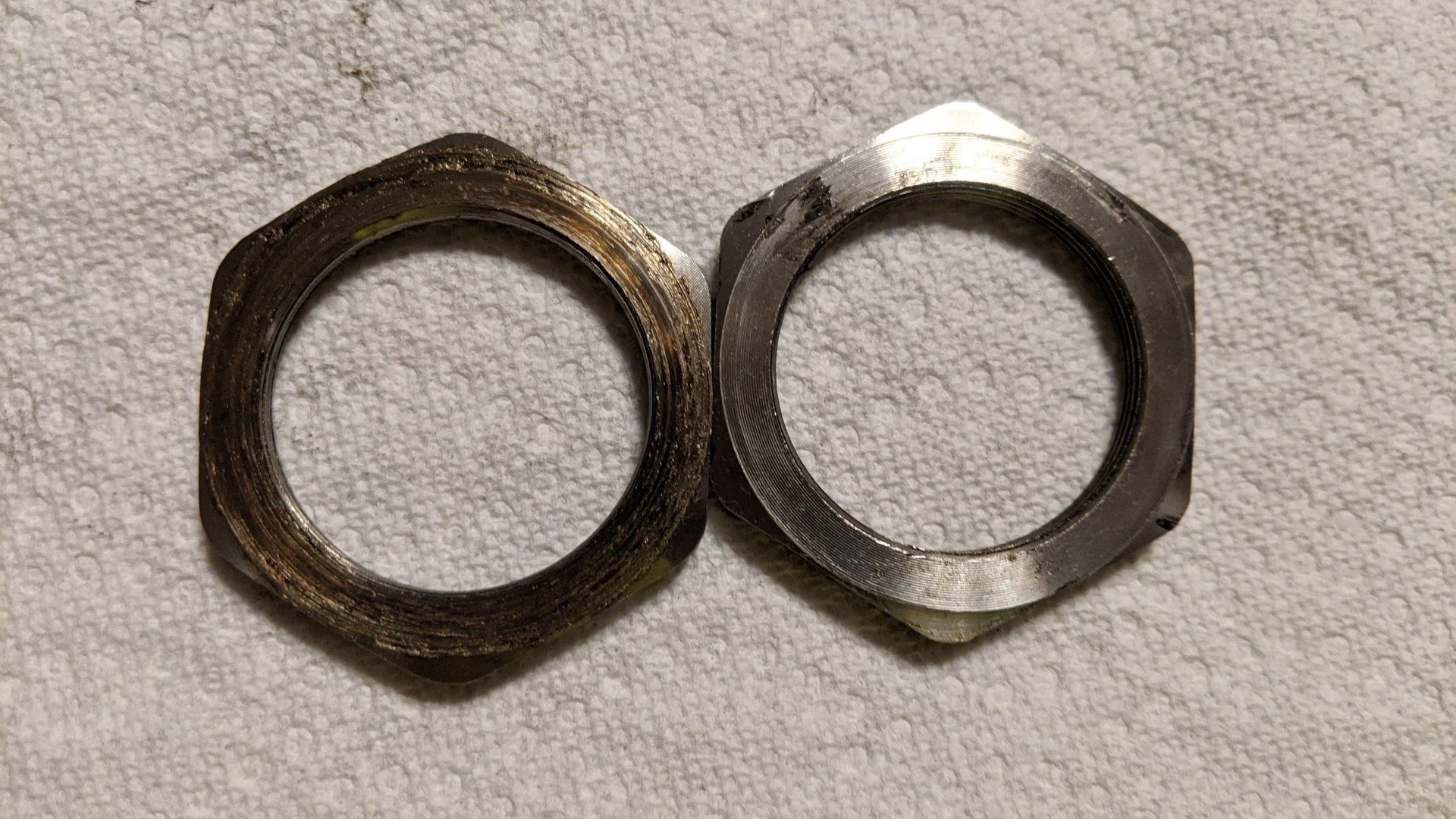

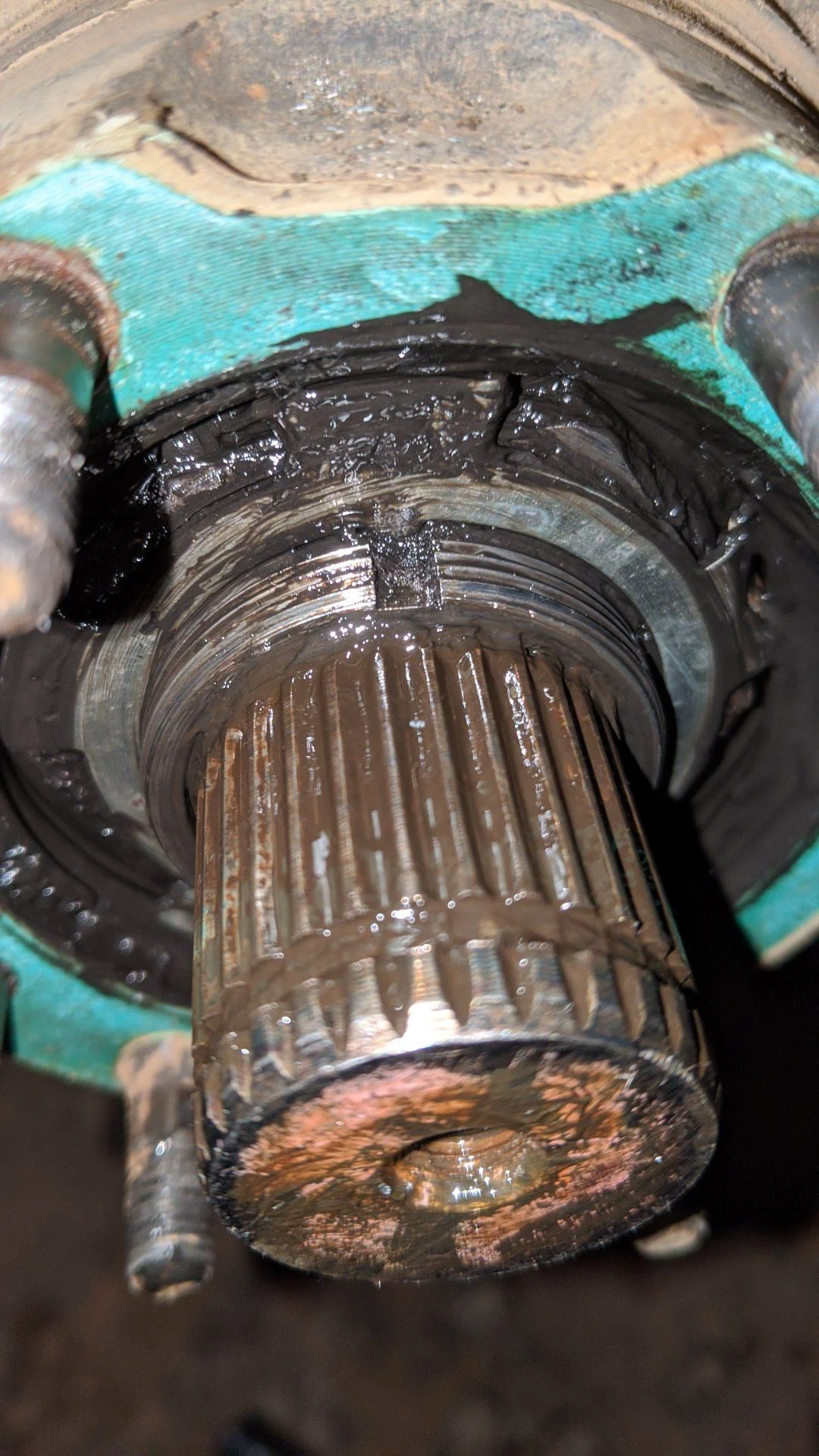

Alright, I dove into the axle tonight and find out that the DS lock washer and spindle threads are damaged. I'm assuming this happened because it was loose and backing out (note the circular wear pattern on the lock washer surface). Looks like I'll need to purchase a new spindle assembly for the DS...
Any thoughts on how to get back on the road ASAP?
Drivers side spindle threads:
Passengers side spindle threads:
DS lock nut on the left, PS on the right:
PS on the inside, DS (damaged) on the outside:
