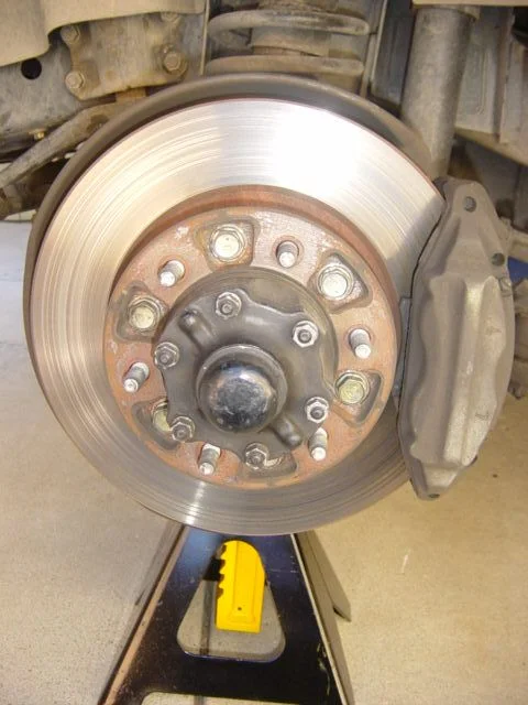

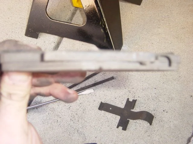

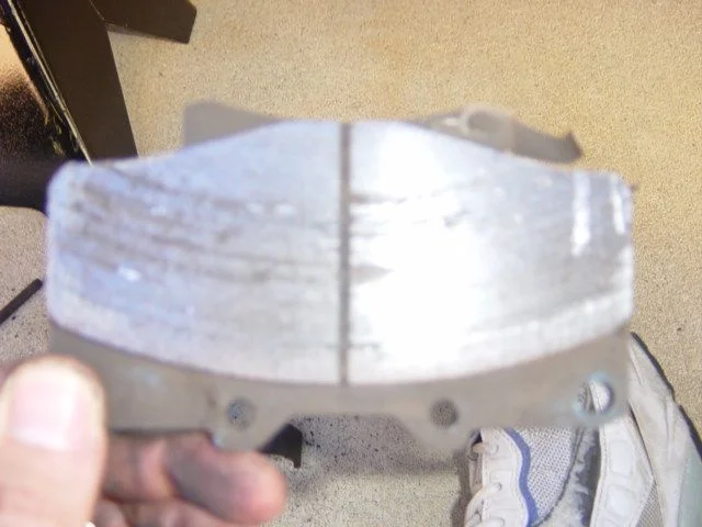

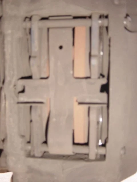

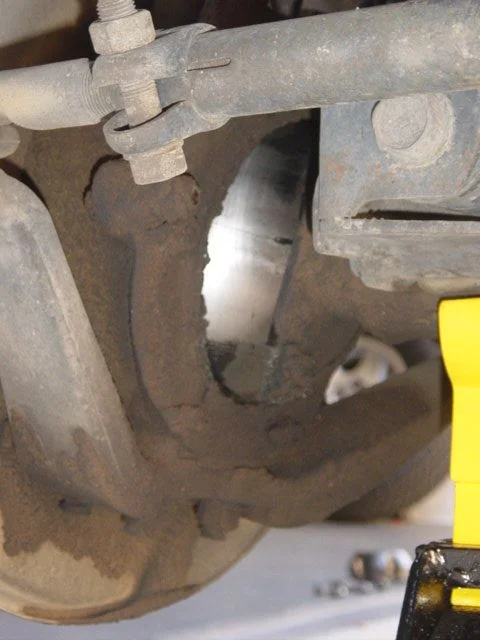

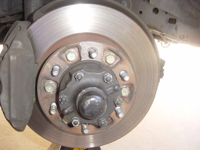

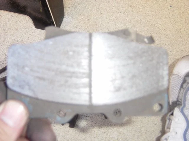

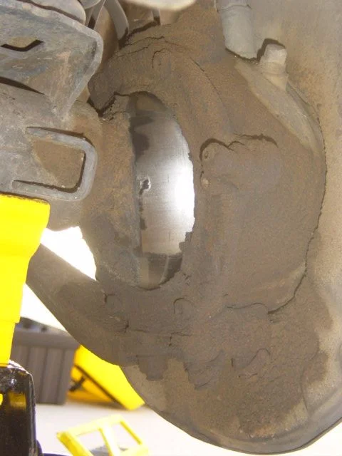

here are some pics of what I have found....they mean nothing to me:confused:
Driver Side (where the noise is coming from)
passenger side
birfs:censor:
ds side shots of pads
Well, you got your money's worth out of those pads :rolleyes:
Looks like you've got a bit of cash to drop into that front end unfortunately but on the bright side you'll feel so much better once it's all buttoned back up properly. Just read through the infinite number of threads (don't forget the Tech section of this site) on doing the birfs and you'll be golden. Might want to consider going to an "upgrade" rotor like the DBA's or similar and the 100-series pads. And when you do the birfields check the spindles closely where the bearings seat and the brass bushing inside.
Good luck :cheers:
Agree with clownmidget, forgot to mention yesterday. It would be a good idea to go with an upgraded rotor like the DBA's. IMHO the slotted rotors are better for off road use than the cross drilled and slotted rotors as I have seed small pebbles get lodged in the holes which can work over the pads a little and shorten their life. If you drive sanely on the highway the cross drilling is not neccesary but the slotting gets the gas that builds up between the pad and rotor out and thereby give better braking. The 80's need all the help they can get with that. :rolleyes: My front rotors are warped right now and when the pads wear down that is probably the route I will go. Good luck and post up or call if you need any more help.
