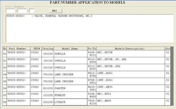

Thanks for that Rosco.
I'm not after one myself, but I'd heard they were ridiculously expensive or not available any more. But if they are on the Corolla's then there are tons of them around in wrecking yards just waiting to be relieved of said valve.

Looks like there are plenty of cars to choose from that had such a device. There ought to be at least one at a local wreckers. Good luck, Thor.

And if you're searching the wrecking yards, here's some more specific details:
