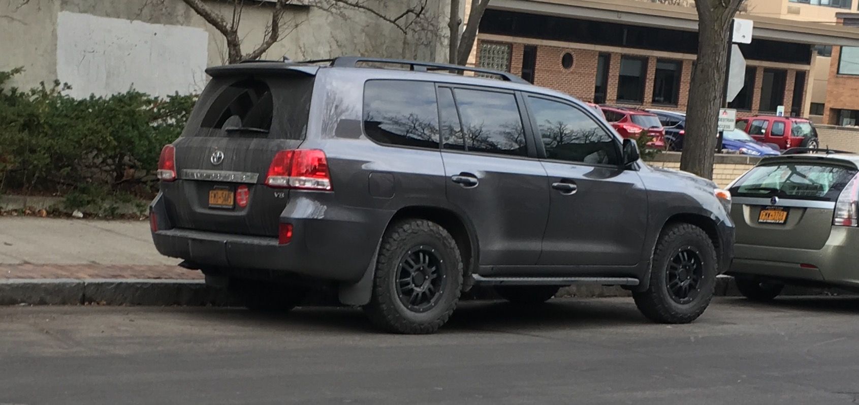

Arich, I recently bought a used 200 and was happy to find dealer put new Bilsteins in front but in the lowest position.
I've since put new 305/50r20's and now have rubbing on mud flaps @ full lock, wondering if moving to the higher position will solve this but I was told by one dealer that spacers would be a better solution. I understand you've gone thru a few sets of shocks and you also have some 20" wheels so I'm hoping you're experience will shed some light.
I want to eliminate tire rub while maintaining a mostly street ride height and a more level look. Should I try the higher adjustment or go for spacers?
It's my best guess the dealer you spoke with isn't familiar with the adjustable Bilsteins. Adjusting them up to the next setting would be the best choice...that's what they were designed for.
