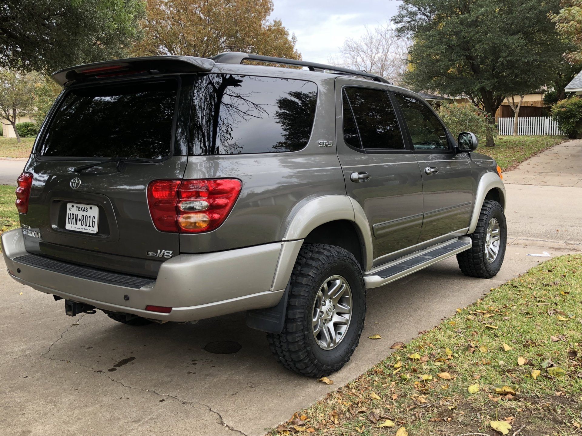

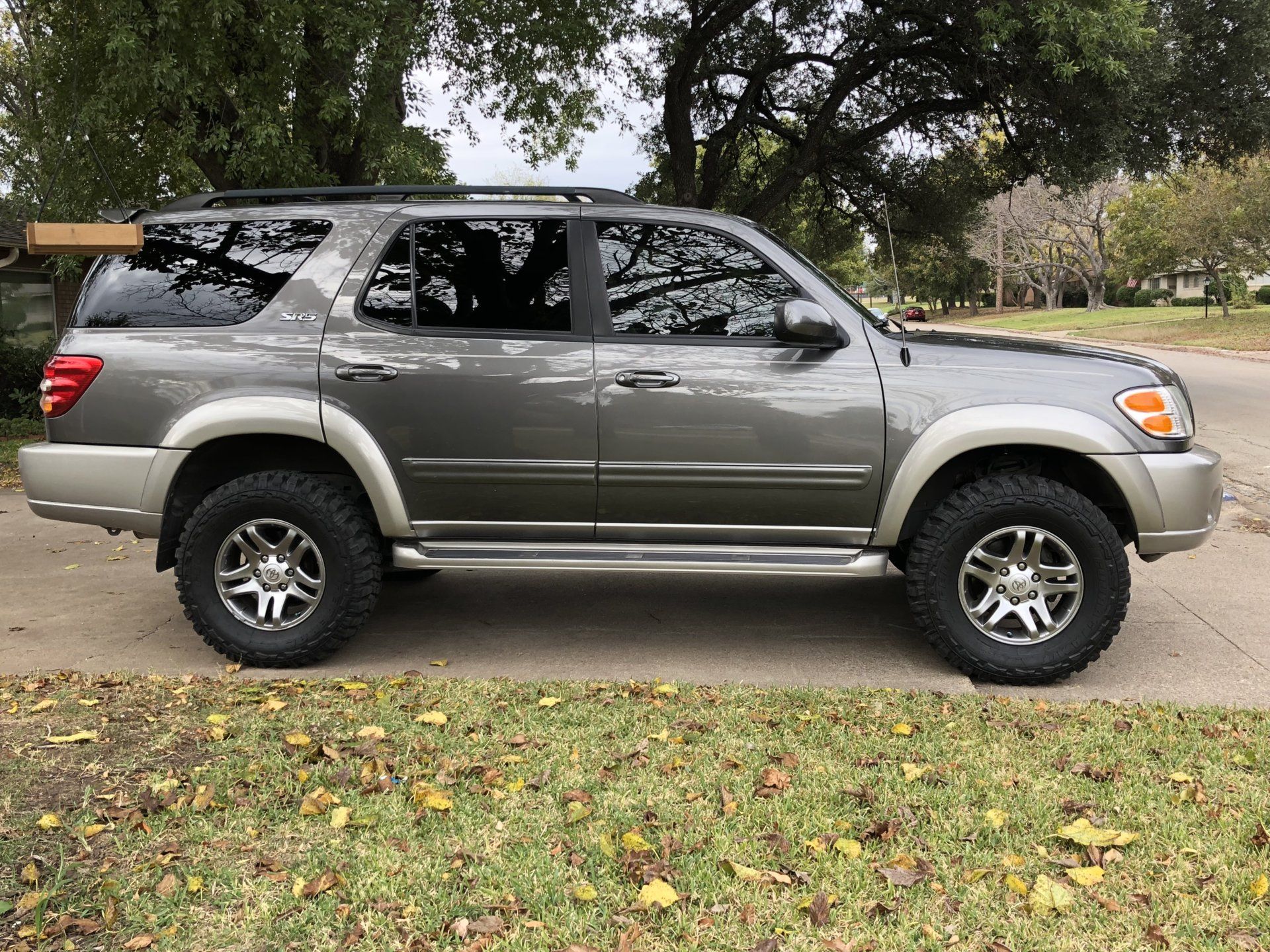

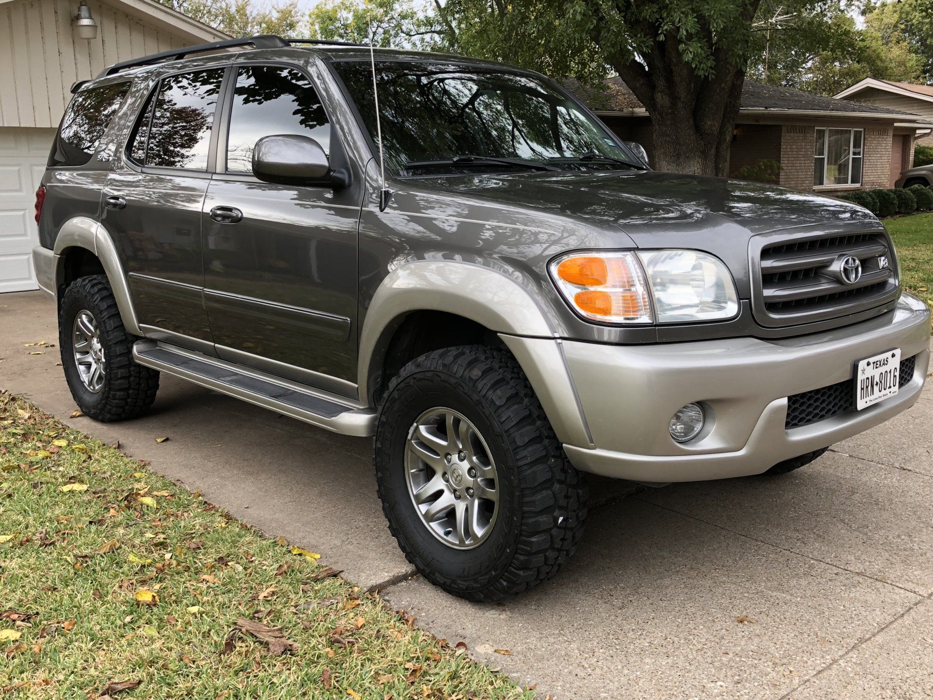

This is my set up on my 04 2WD. I love it and get compliments all the time. Will eventually get a 4wd, but for now, she's perfect.
This was a much needed upgrade. The tank felt like I was on a boat in rough waters all the time.
Super smooth and eats up bumps like nothing.
Front: Bilsteins 24-261425 (Top Notch)
Rear: Bilsteins 33-187174
OME 2862 Rear Springs
1.5" Synergy Performance Wheel Spacers
285/70/17 - Federal Couragia MT Mud Terrain Tire
Overall, I gained about 3.5 inches of height. I love the look without the step rails, but need them for my 2 and 4 year olds to climb in. They hate being boosted up and find it entertaining to climb in...

Thank you Crunchy! This is the exact info I was looking for. This gives me a very good idea of what it would look like since it is the same paint scheme and you described the same feeling I have when I drive that thing. Glad to know you like your setup. Thinking I will copy (but likely going AT for the tires instead of the MTs)
