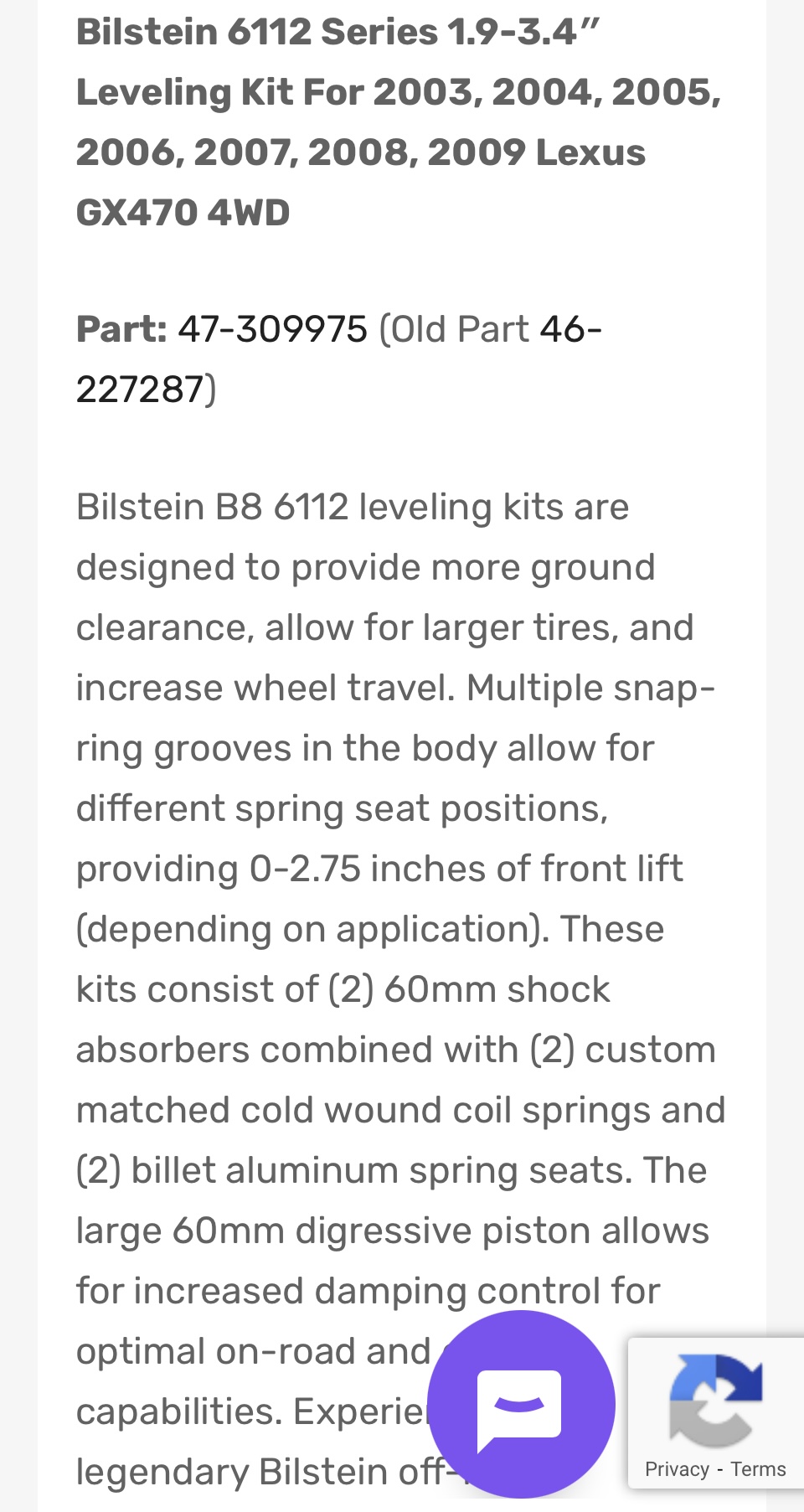

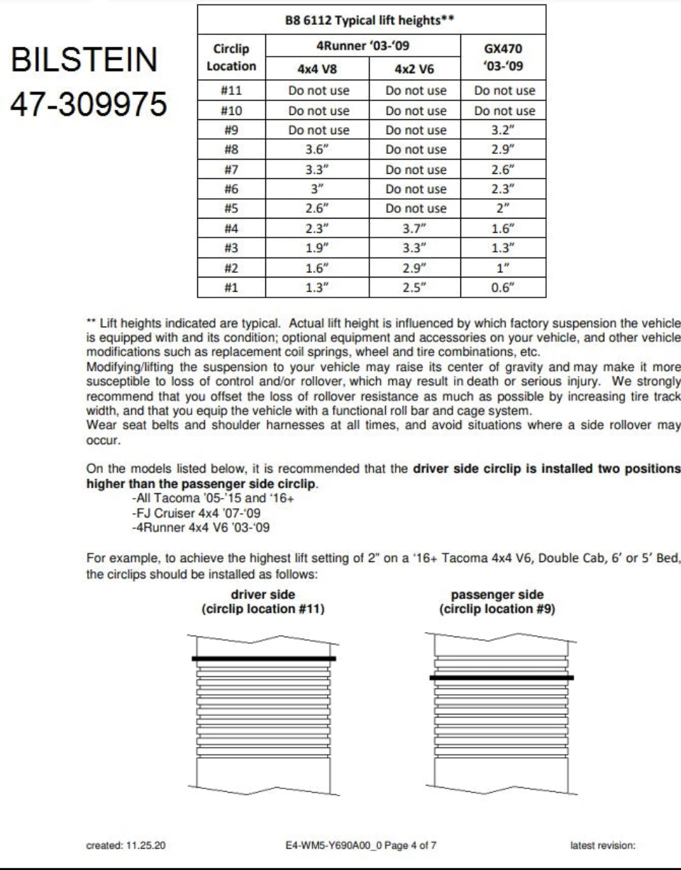

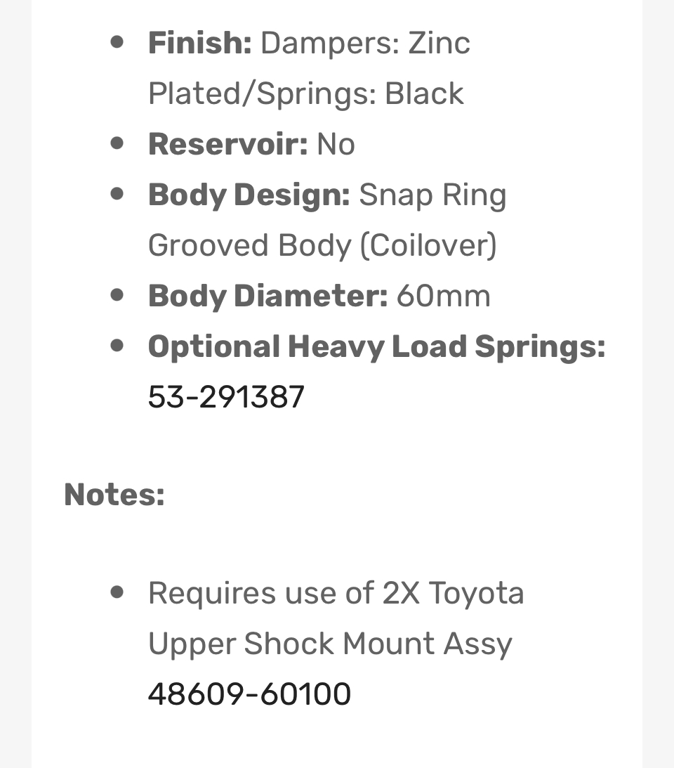

I’m not sure what part numbers you discovered recently, but it seems like Bilstein modified the 6112 and gave it a new part number.
This web site mentions that the old part number was superseded and now you can order with optional HD coils. Call them to confirm and see if they have in stock….
Thank you for this!
Being relatively new to this it was very confusing seeing 2 part numbers for the same items.
