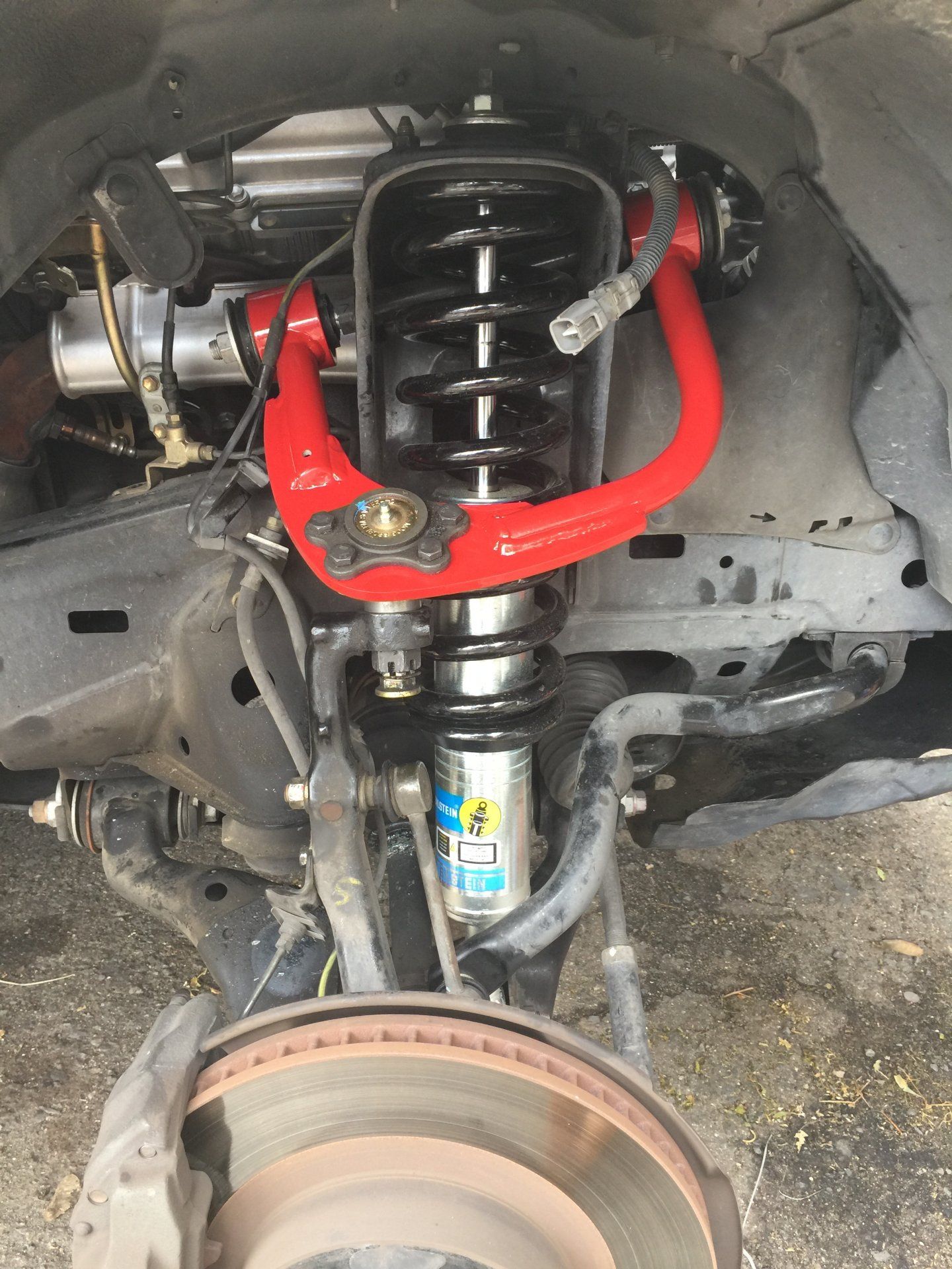

Installing them now along with JBA UCA's. Going with Bilstein 5100's for now in the rear with the Icon Overland rear springs. Just ordered RCI complete skid plate kit, and Dark Gunmetal FN f(X) Pro wheels. Looking into tires now.

I didn't measure the truck before or after. I ended up with 285/75/17 Toyo open country at2 extreme LRE, on FN wheels in dark gunmetal.
Also added the full 3/16" steel skid plate kit from RCI.
