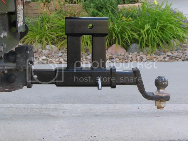

My trailer did not come with rackrails and rather than drill I did the hitch thing. This pic shows it installed as it was built, the hole you see near the receiver is one I drilled to move it closer to the truck...

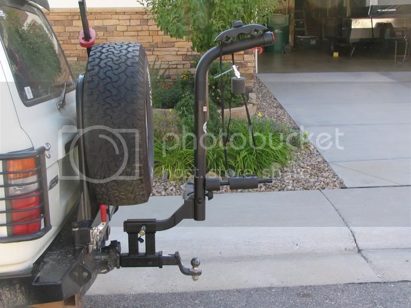

Here it is with the carrier installed using my hitch pin hole....
Positives - Dont have to take the bikes off the trailer to pop it up and I can take the bikes to the trailhead if the camper is sitting at the campsite.
Negatives - The maker of the adaptor says it cuts hitch capacity by a 1/3. The adaptor weighs 26 lbs, my rack with extension for 3 bikes weighs 48 lbs and 3 bikes are around 85 lbs ... so I hang an extra 168 lbs (plus the trailer tongue) out past the bumper. That causes the a$$end of the truck to sag quite a bit when I'm all set-up (w/OME 2.5 heavy springs)

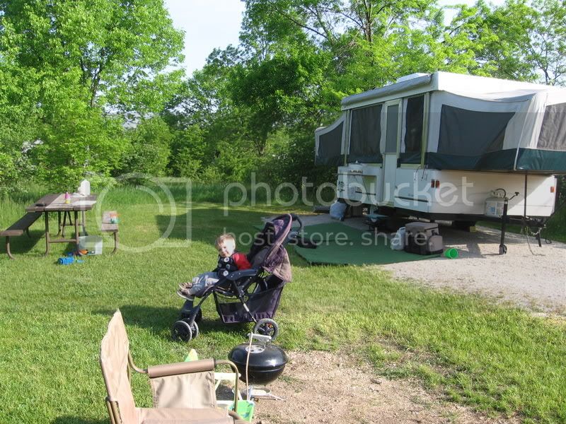

No I don't (my ROTW has a pic of the trailer attached but no bike rack still gives an idea of the space available)
I had already moved the battery box back next to the propane tank so I could open the tire carrier with the trailer attached and with that done there is no major issue with clearance for 3 bikes.
I love it. I have tented all my life and wasn't sure about making the switch but I am happy I did. I'm 6'0 and so are the beds (tight fit). I think the Element series (this is a Cobalt) might be too narrow for you unless you sleep alone, at an angle ;).
From where did you buy that hitch thing or did you get it custom built?
