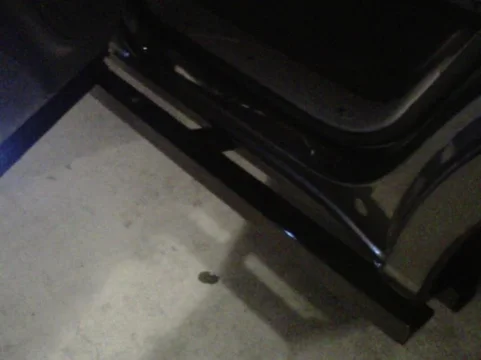

Here is a shot of the sliders in progress, I got a few minutes today and got the legs attached, just need to finish welding and clean them up for paint. I am using 2" square .125 tubing for the rails and legs, 1 1/2" square .125 tubing for then pieces connecting the rails, 1/4" plate for the the frame connection. All the cuts are made with my miter saw or grinder, and welded with a Century 80 wire welder.
I got the sliders finished up while it was raining today and I am very happy with them. My welds have gotten much better after running this many beads. I ended up spending about $300 total with the cost of metal, cutting discs, bolts, paint and 3 spools of welding wire.
Full side view
Driver's door open
Rear passenger door open

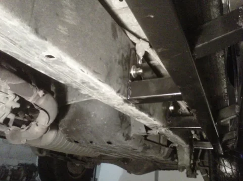

Legs attached to frame with grade 8 hardware
Backside of frame with 1/4" plate supports for the bolts.
They don't move at all when I stepped up on them, they should work great as steps for the kiddos and provide some extra protection around town and in the woods.
i would run a couple of beads on the bottom of the square tubing, where it sits against the frame, reason is the sliders will bend the thin plate when you rest your truck on them, there for denting your rockers, if you lay the beads at the bottom you can also grind off the welds easily when you desire to remove them
