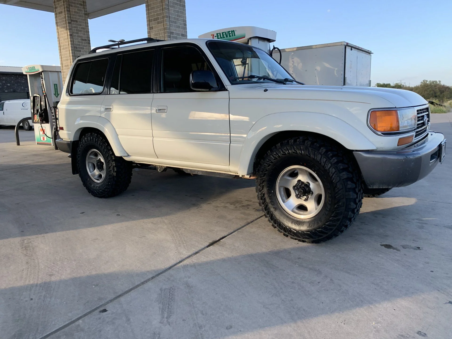

I recently went with new Yokahama Geolandar M/T G003, 315/75/R16 with no lift
If you decide to go with the 315 (34.6") tire size, it will fit fine, but there will be some rubbing when going over bumps and will not be "off-road" ready without a lift. You may have to look into 2"-3" lift kits and you will need a new gear ratio 4.88. This keeps the car from being sluggish and draining your fuel so much. Here is a picture of 315s on the fj80 stock suspension, and what the cruiser looks like right now:
I will be looking at getting a 2.5” OME lift kit but not sure wether to get the heavy or medium option. Also not sure wether I would need extended bump stops for off-roading so I don’t get any rubbing going over terrain.

White, lookin Good.
You will need to lower rear bumps 1.25" & front 1.5".
1.25" wheel spacers needed to prevent inside rear frame rub.
As for lift stay 3" or under to prevent extra costs to correct driveline, panhard & control arm angles.

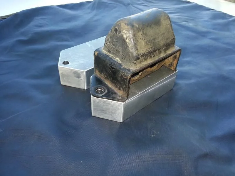

Will I get more rubbing if I decide to do the spacers first? Also, what is a good brand or website to get the bump stops at? I’ve found a few but not sure if they’ll fit.
Hitit66 sells nice aluminum bump stops.
Do bump stops 1st before spacer cuz you might drive 315s to much in fender & catch the outer front lip in rear if you space tires out before lowering the bumps. It could chunk a tire. My 315s were wide tires though...
