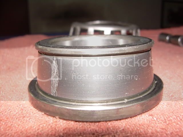

Except yours was completely our fault Matt. Yours was set up a little tighter on the pinion preload then average. We thought it would be OK, we were incorrect. Ill post up a pic of SoCal_80s pinion bearing on Monday. I honestly dont know exactly why his failed, but it was not a preload problem. We found one bad spot in the inner race of the outer pinion bearing. Strange failure for sure.

Here is Socal_80's outer pinion bearing. No damage to the rollers, we had to cut the cage off to find the damage. Bad bearing.

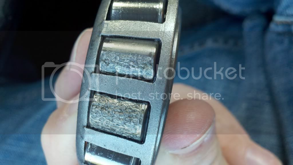

Here is Mattafact's pinion bearing. Too much pinion preload did this.
