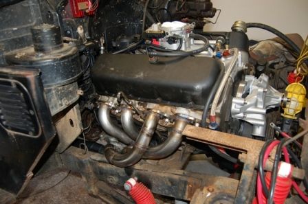

If you want power and something reliable, the Big Block Chevy is the choice. An aluminum radiator will take care of your cooling issues in 90% of the cases. You could go with some of the other GM big blocks, but only if you have a light foot. I know some of the small block guys may complain, but there is NO replacement for cubic inches! I have had a BBC in for over 15 years.
(you can even get the headers inside the frame, but you will have to make them.)
Good Luck; John
From those pics, that motor isn't really much wider than my LSx truck motor, and at least the exhaust ports point down, which helps give you a chance with the exhaust...
Heavy bitch though, for sure... even with all that AL stuff on it..

Actually; With Aluminum heads, etc. It is less than 25lb's different than a iron head small block Chevy. Some people carry more weight from mud on their shoes than that. :)
It does fit very well, of course I am using all Chevy transmission and 205 t-case.
