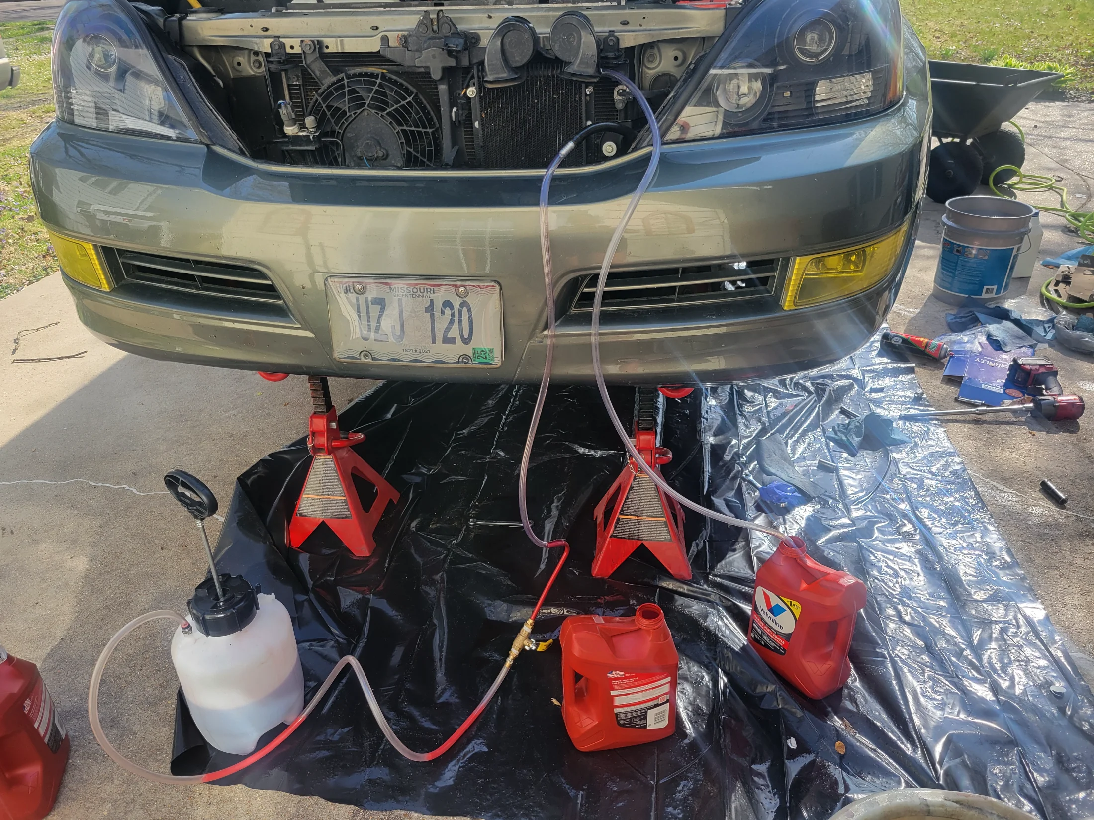

Not the first time I've posted this - and probably not the last time - but it's pretty darn easy to DIY the fluid exchange with a Motive Power Fill (note the 460 procedure is a bit different if you don't have an external cooler, and the 460 also has a thermostat that needs to be pinned open).

I wouldn't worry about non-OEM fluid. I use Valvoline MaxLife in mine as it's a full-synthetic, WS-compatible fluid that is very easy to find at any parts/box store. At least it doesn't sound like they under-filled it. Still, IMO the machine seems to over-complicate a simple process that I DIY with the $90 Motive Power Fill in my driveway and 4 jugs of MaxLife. Both end at the same point - fluid flowing out the overflow plug, only I also drop the pan and clean it.
