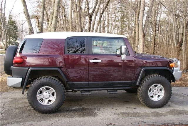

Yes. Good tires. I run 285/75r16 on my 09 FJC, no lift. There is no rubbing at all. A little noisy but not too bad. Not the best in snow and ice,(but what is?). Great in mud and off road. Lots of aggression. I enjoy them alot. Hope this helps. Good luck.

Currently running 1" spacers and have been doing so since the truck was new. What I do not know is if these wheels fit without spacers. These are 16x7 4runner wheels and may fit as the TRD wheels for the FJC are 16" also. Next time I wrench on the truck, I will remove a spacer to find out if they fit. But will most likely stay with the spacers. Spacers is a 4wd topic that some people are passionately against, but I am fine with them. Wheel track is wider, which compensates for the suspension lift and the tire is just at the edge of the wheel arch, where I like it. Flexed the rear and the tire still stuffs the well with no rubbing.

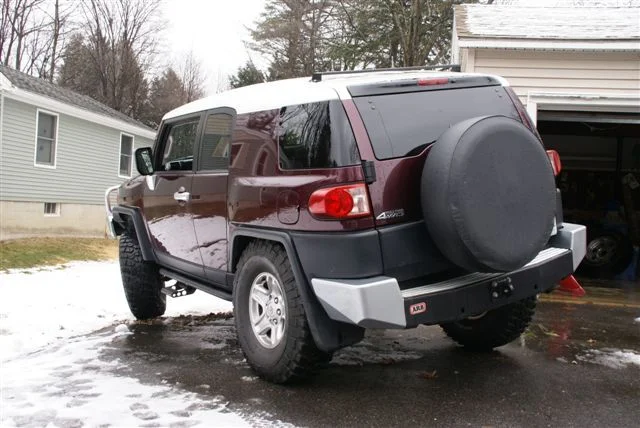

I put the spare on the rear door this weekend and it fit with millimeters between the tire and bumper (ARB). I believe this tire size is THE absolute max you can go with OME suspension. They measure on the truck 34" tall.

Removed the spacer today and the wheels will not fit without them, so the spacers remain. I purchased these already mounted and balanced so I stayed with these wheels. I like these wheels because the paint code is REAL close to the factory silver on the FJC. I would still recommend this tire size, just go with the TRD wheels which fit without spacers. Even with 1" spacers on my truck, the tires still fit at the edge of the fender flare. Perfect for NH vehicle inspections.
